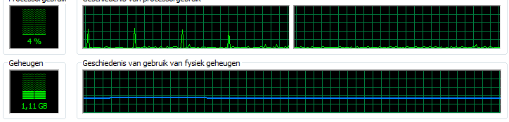

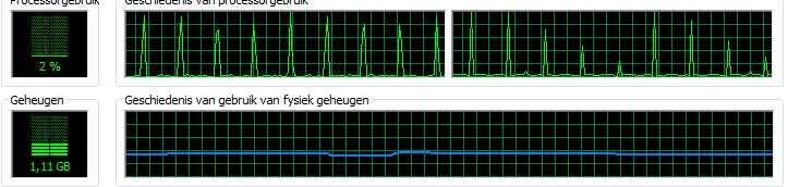

Anyway, no ticks. Scheme-3 and the 2nd core stays "empty" (see first pic).
With OAP the 2nd core has to do a few things (2nd pic), and I posted it because of the downgoing slope in the 2nd core while as far as I am concerned this should stay equal. Hmm ...
But Mani ... I guess you're still outputting 24 bits ? If so, try 32 ands I'll bet you it will be away. In that case it is just my fault (and you didn't notice it before).
