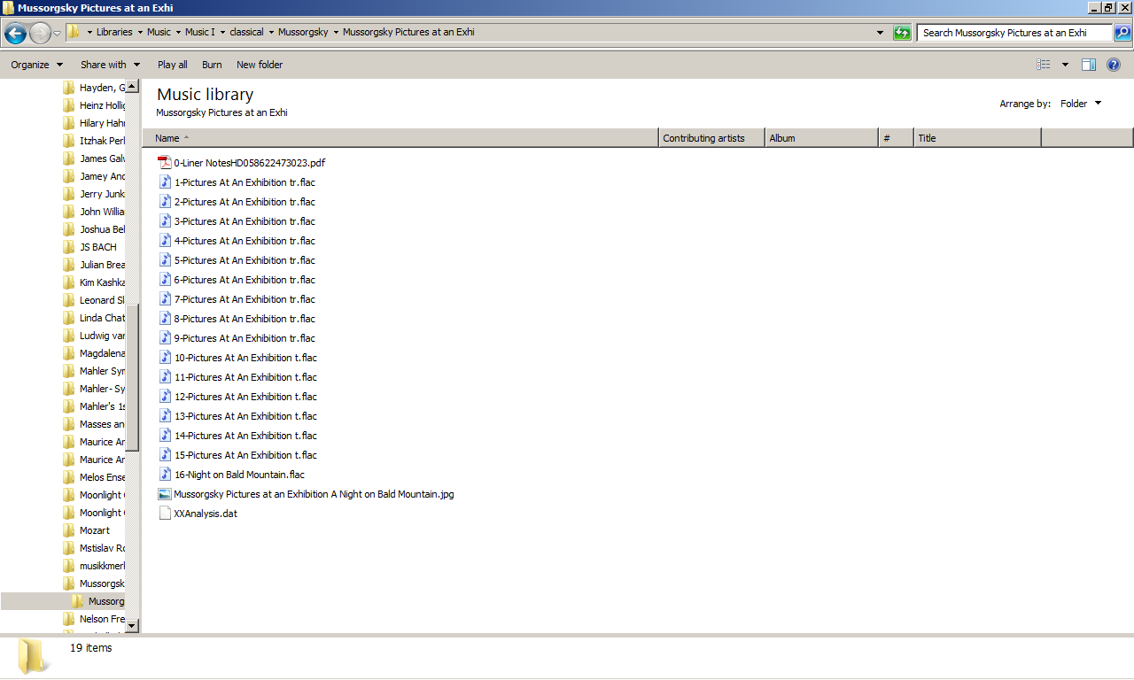

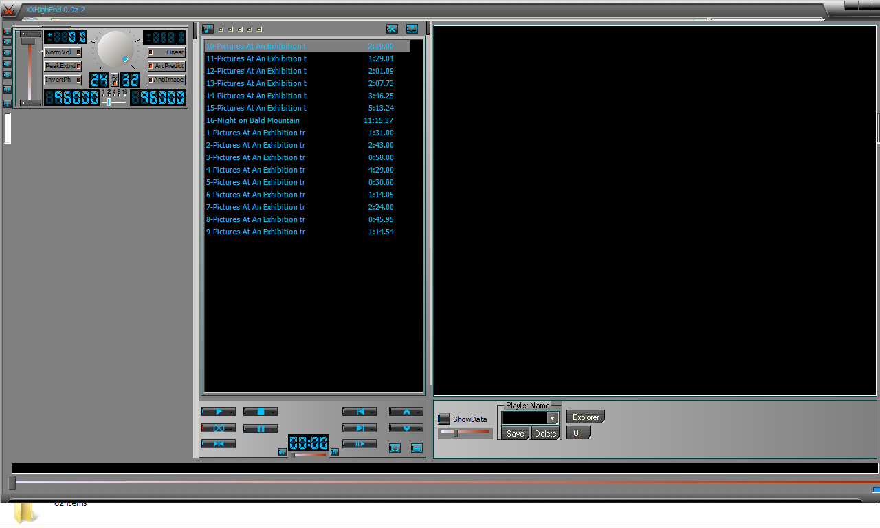

« Reply #6 on: September 24, 2010, 06:15:38 pm »
Peter, below are three photos showing the same problem with a 24/96 I downloaded from HD Traks. The first shows the tracks in the library window, the second shows the out of order traks in the playlist window after loading them, and the third shows the tracks as they appear in explorer. I did nothing to edit the track names when I downloaded them from HD Traks.

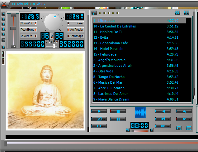

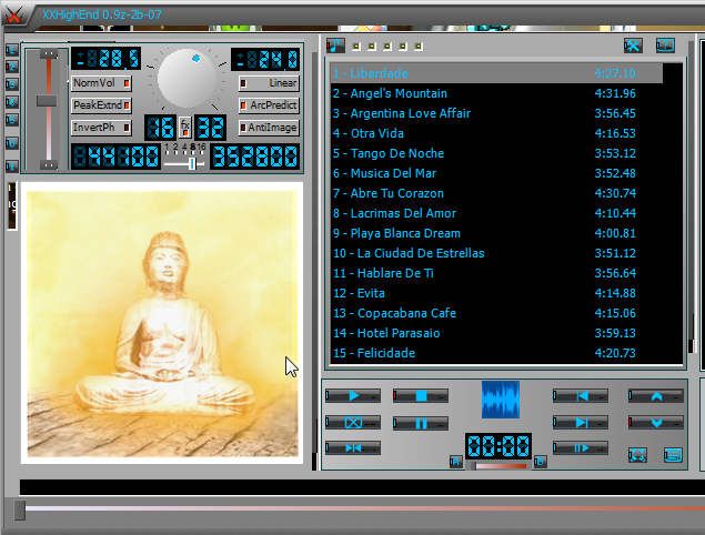

« Reply #7 on: September 25, 2010, 10:05:48 am »
Aha ... Now I understand why you don't understand !
Or why I didn't ... Happy
Somehow (and I never saw it) Explorer is able to come up with a list which is not in alphabetical sequence. I just tried to find out how it works, but so far I can't. It must be something like maintaining a numerical sequence as long as text starts with numerics.
Remember, this is text, and therefore it should sort by alphabetical order. It should ? well, I can't let make a computer program work otherwise when text is involved. So, after 1 comes 11, comes 12 ... 19, 2, 20, 21, ... 3, 30, 31. But not so in Explorer.
When you drag a folder (or the files therein) onto the XX Playlist Area, all goes right. This is because actually Explorer does that (provides the sequence). However, when you select an album in the Library Area and click Load, then it's "wrong" (but IMO technically correct). This is because there a normal command is used to come up with the files in the folder, and that normal command provides a normal alphabetical sequence. And I'm glad it does, or otherwise nothing in computing would work anymore. But :
Since I never saw this could "functionally" work in Explorer, I also had no reason to cover for it in XXHighEnd. I mean, it would be nice to have it right in XXHighEnd, but it would still be quite unworkable if it wasn't right in Explorer. And thus we all would rename them first ... I thought (and next in XX there wouldn't be a problem anymore).
But now I have seen the light, and *thus* must solve it within XX, which is not much of a problem I think.
All 'n all, thanks once again for being persistent, and in the end we can only say it is rather stupid I never saw it.
But let's be honest, it is since those hires downloads with the typical "liner notes" in track 0 it, ever emerged.
PS: Brian, I think we had a discussion about this off line maybe a year ago. So now you know I never understood it ... Happy
