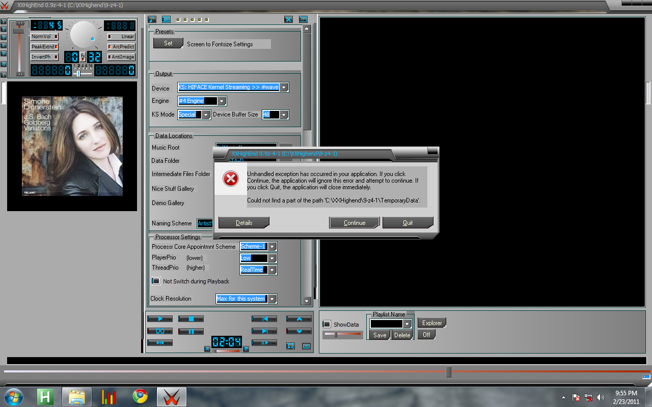

Still having the same problem. Tried deleting all the files you suggested but couldn't find [XX]\LibraryData.txt . Deleting the others didn't help. Here's a picture of the error (the blue highlights in textboxes is a new issue also):

Ah, I better had seen this message right away ... Well, assuming it is still the same.
To me it seems clear that this folder \TemporaryData under your XX folder doesn't exist while it is expected to exist there (whetever you exactly do). So, creating it should solve the problem ?

Library button in the lower right hand corner ?!? there is no Library button there !
However ... I just deleted my TemporaryData folder, and I indeed get the error now, at clicking at some random lower right corner whatever button ... which is the button to clear temporary data - from that folder.
Ok, I must be able to solve that for the next version.
For now, just create that folder, and all will be right.
But with this, I also found a major other problem which I maybe never understood, and which was reported as solved, but as it appears now, not at all (but by accident for the user concerned);
When this folder is not there, but in XX Logging is switched On, this errors out under the hood for each call to the log file. And now it takes ages to pay something ! ...
The TemporaryData folder is created automatically allright, but on the switch of activating logging ...
... which won't happen when it's already On ... and which is the case at creating a new folder for XX at a new version, while the settings are restored from the older version.
swoon
