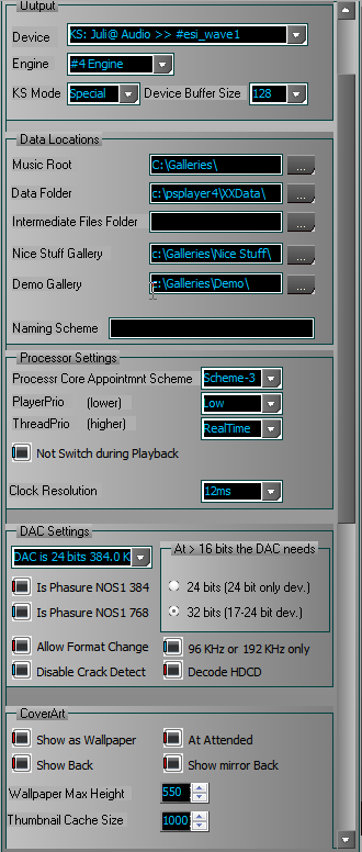

I used Attended and Copy To XX Drive. Not that it matters, but we should try to get our log files equal. My "Show Data" (right pane) is off.
On that matter, I had only your track loaded in the Playlist Area.
Se for further settings below. Of course you don't have to copy them all exactly, with some sense of what can be important here.
Thanks !

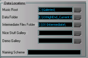

  what is your XX Drive EXACTLY ?
RAMDISK E:\XXHighEnd_Current 09z-4-0\
I have test it without RAMDISK then it plays this tilde track again! Is it RAMDISK related?
  When you do not "Copy to XX Drive" this one most probably works.
....yes it works!

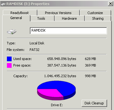

a. Dataram Ramdisk
b. When i look to the properties of RAMDISK i see FAT32
c. I think not. How do get it beyond the OS official memory limit?
