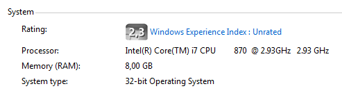

« Reply #9 on: February 19, 2011, 03:47:09 pm »
However, my Windows Index score is 7.2.
I wouldn't bet on exactly that ...
Unless the below is caused by my super-slomo SSD (and I am not even going to look Happy).
