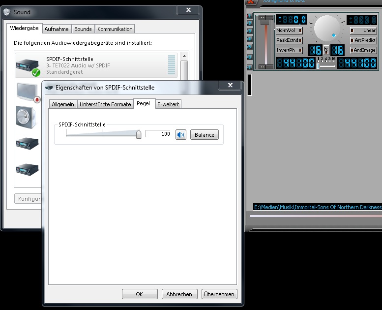

The volume slider of windows in "Properties of SPDIF-Interface" affects the volume. So this should not be if I use KS?
Any idea what is the problem?
Adrian
« Reply #1 on: February 20, 2011, 11:00:43 pm »
Adrian - The only things which "allows" this is your driver (soundcard ??) having a volume control itself, that being bounded to the Windows volume control. So, actually you would be using attenuation provided by that soundcard ...
Thus, look for that slider in your souncard's driver (control panel) somewhere ...
