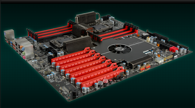

$260 (http://www.newegg.com/Product/Product.aspx?Item=N82E16813131378) <- WATCH OUT, less SATA ports !
or
$280 (http://www.newegg.com/Product/Product.aspx?Item=N82E16813131389&cm_re=Z8NA-D6-_-13-131-389-_-Product)
or (available at this time of writing, and for the first one to grab it)
Open Box ($158) : http://www.newegg.com/Product/Product.aspx?Item=N82E16813131378R&cm_re=Z8NA-D6-_-13-131-378R-_-Product <- <- WATCH OUT, less SATA ports !
or for those with more money, and for someone who can tell where the PCI slots are : (e600) http://www.evga.com/articles/00537/
Edit -> This doesn't seem to be an ATX board afterall.

Be careful. At this moment I don't even know whether something which looks like a PCIe x1 slot is really that.
Someone pointed this out (offline).
Getting two coolers in there also seems to be problematic ...
