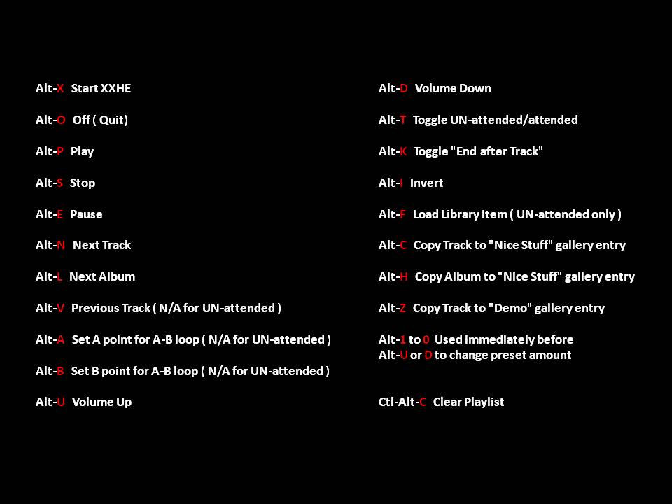

PS. I've attached a jpeg of my desktop background that I use to help in unattended mode... shame most of them don't work for me  Sad

Most of the unattended controls don't seem to work very well for me either I'm afraid, but it's never been a particularly big issue.

I have to admit that I usually set the volume to the level I want first and then listen in unattended without making any adjustments. The only control I sometimes use (very rarely actually) is Alt-N.
I use - all for Unattended operation :
Alt-X (can be hundreds of times per day)
Alt-P (maybe 5-10 times per day; lately not anymore)
Alt-S (normally 1 time per day)
Ale-E (rarely though)
Alt-N (a couple of times per day)
Alt-U (can easily be 20 times per day)
Alt-D (maybe 5 times per day Happy)
Alt-I (very rarely, but is suspect to volume changes to -0dBFS (just because I had that ONCE)
Alt-C (rarely, maybe once per month)
Alt-H (can be 3 times per day (always hoping for more Wink)
Alt-Z (maybe 3-5 times per day)
Alt-1-0 (maybe 4 times per day, and used for Volume-Up as well as -Down)
I do not use - Unattended operation :
Alt-O
Alt-L
Alt-A
Alt-B
Alt-T
Alt-K (only because I never know which one this is, but in the past : once or twice per day)
Alt-F
Alt-U or -D "Preset amount" ?? I don't even know what it is. Can't be either, because this is used for Volume.
What's left is for Attended, and I never use that.
Ok. Somehow this doesn't look to me like "most of them don't work". Also it occurs to me that the list of hotkeys I don't use are hardly useful.
Notice that the ones I use, I can use without any issues at all, or otherwise I would repair it. For myself !! (is this clear ?)
Now, what is wrong here ? What can't you all use what I can ?
