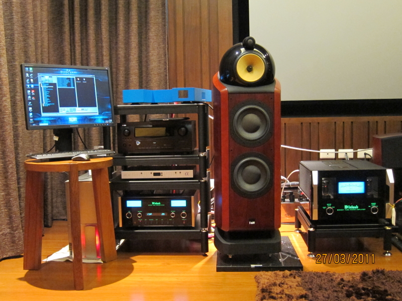

I don't usually turn on the "blue eyes" meter on McIntosh. But I did today to  monitor the sound level.
One thing that immediately strick me is NOS 1 Blue matching with the "blue eyes". Well it is not that clear in the photo, but the real thing looks really cool. I am going to slide NOS1 replacing the Alpha DAC in the photo. After I do this, your NOS1 will give a big Blue Eye effect too. Cool.

« Reply #13 on: March 27, 2011, 11:27:14 am »
Haha, nice.
Btw, I resized your picture because otherwise we'll never get to see the overview (of colours).
If you really wanted to have it that big, just upload your large picture again.

praphan
Posts: 242
« Reply #14 on: March 27, 2011, 01:46:38 pm »
Thanks for resizing.
I think you should activate the screen real soon. With dark screen, the NOS1 big "blue eyes" look like pirate.
What colour is the screen when lid?
Cheers!
