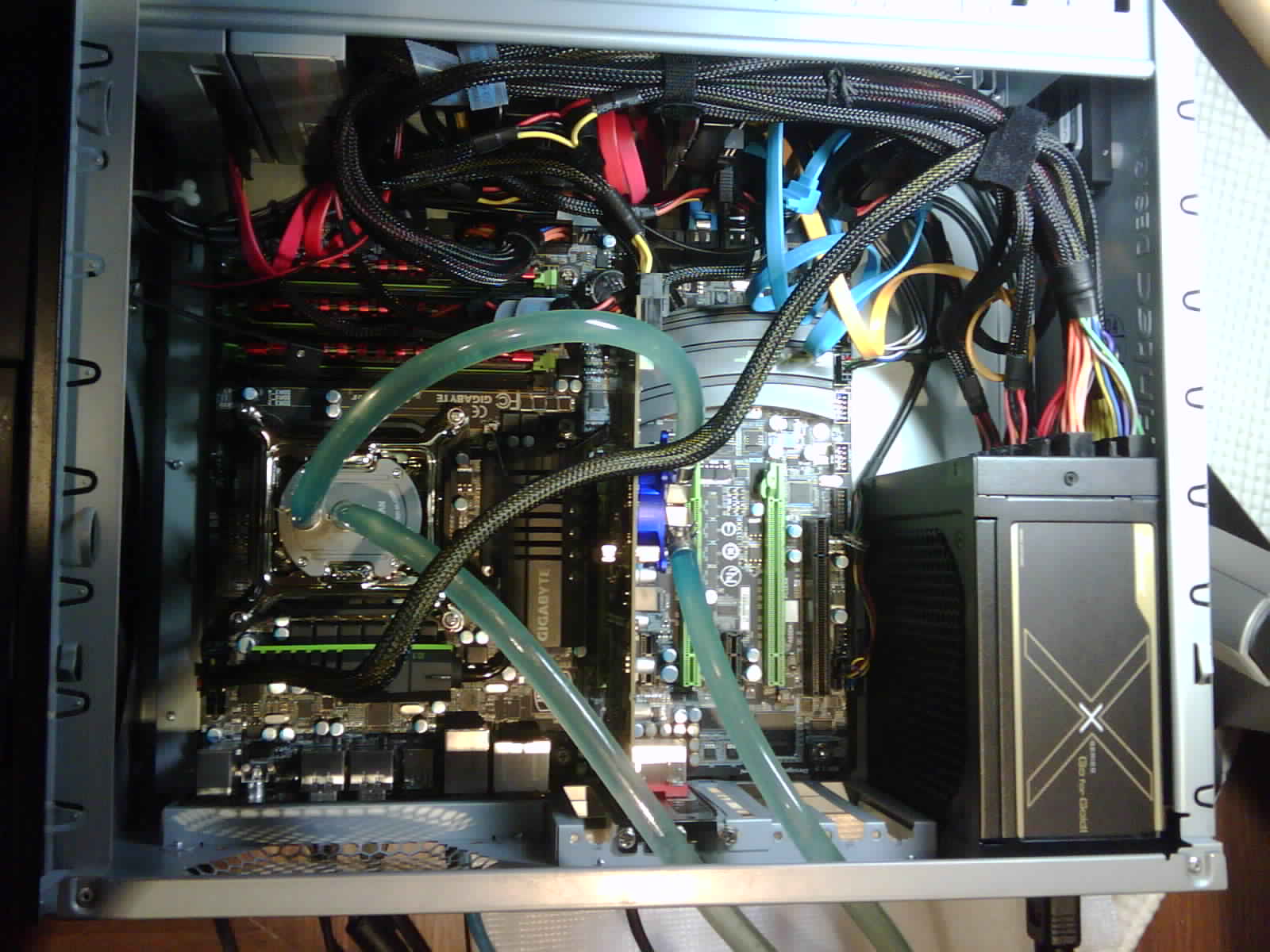

1. You may find thread discussions on XXHE about fanless PC to eliminate both noise (audible one) and EMI/RFI noise. I use water cooling - not easy to work with especially when you want to exchange and play around with CPU or GPU. You have to be careful with the water leakage and tubing maintenance. But the beauty is that it is completely quite and with less pollution. Mine is Zalman Reserator 1  with large cooling tower. Don't buy the one that has extenal fan attached to the cooling tank (Reserator XT : http://www.zalman.co.kr/eng/product/Product_Read.asp?idx=185) If you decide to go for water route, you have to be prepared to void your GPU warranty since you have to remove the stock heatsink and replace it with GPU block. But the effort is very rewarding.

4. Application of EMI/RFI shielding materials : you can build your own metal box to form a Faraday cage to your internal sound card (a means to block out external static electric fields which is in existance since 1836). I use Stillpoints ERS paper to shield my Lynx AES16 card (before I bought NOS1). Please see photo how I shield the Lynx card. ERS can be purchased online at  http://www.tweekgeek.com/_e/Stillpoints_ERS_More/product/ERS/Stillpoints_ERS_RFI_Killer.htm
