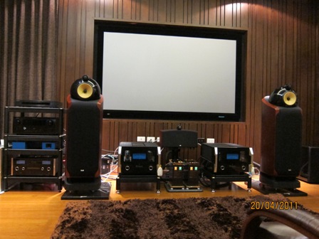

So to return the compliment, I share the picture of my listening room which likes yours - a home theatre too. You have more space for the room treatment stuff. How nice !
My NOS1 is hidden in the shelf and looks like the Mc "blue eyes". What  a coincident !
