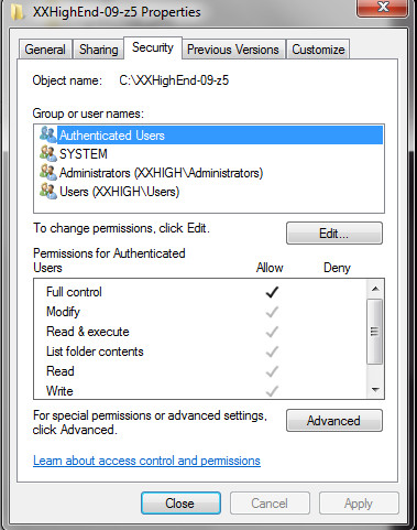

Well it appears resource is not causing the problem. So I operated XX in Unattended (services NOT selected to shut down) and attempted Alt U which did NOT work within some time. So then I used Alt S to close XX THEN the volume reduced by 1.5db I then pressed Alt S again and XX shut down. This is very repeatable - tried it a few times. So I took a log of events (attached) which shows (possibly?) a security access problem (see attached XX log file).
So this is most likely a problem with my security settings (damn microsoft!!!!). I also appreciate this is my problem and not yours but if there is some help you can give me to help me on my way it would be appreciated but if not no problem :-).

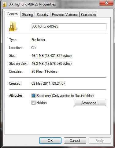

Looking at the security settings of the folder (see "1" attached) the XX folder is "read only". I have tried to change this but it will not allow me to - specifically I change the settings then apply them but when I check the folder nothing has changed.

« Reply #5 on: May 03, 2011, 02:52:30 pm »
That seems strange - unless you first burned XX to a CD and copied it from there or something.
Did you try
- Open command prompt (cmd from Run);
- Go to your XX folder (with CD commands, like CD \MyXXFolder)
- ATTRIB *.* -R (the R is from Read Only)
You can check with ATTRIB *.* for the status of all the files.
Thanks for your help, and let me know ...
« Reply #6 on: May 03, 2011, 03:08:56 pm »
No nothing fancy about the install - XX was downloaded unzipped and installed in the usual way.
I did try ATTRIB cmd but just tried again anyway. Actually checking the security of xx directory again the blue indicates that some of the files are read only - there is a tick option for all the files in directory to be read only so maybe that's OK anyway. I checked my XP other PC and it is the same.

Actually it must be about the folder itself. So, all the files are "allowed" to be read only (well, by heart I wouldn't know of any that should be over-writeable as how they come from the install), but new files must be able to create and next change. Also, if files can't be created, I can't even imagine that anything goes. So, I guess the folder should have the create rights in the first place ...
I can't make screen copies at this time, but if you go to the XX folder, rightclick on it, ask for the properties, and next ask for the security tab, you have a list of users;
Do they all show "full access" ? If not, that will be your problem, and maybe you can change it (you should be able to). Apply this for the Verified Users and for the Administrators should be sufficient, but you can try to do all of them.
Of course yuor User Account Control (UAC) must be off (for W7 slider all the way down, and reboot after changing it !).

Admin privileges were at "Full Control" for me as administrator anyway but now I have set all the listed users (as shown in the attached) to have "Full Control" access anyway but the problem remains. The log file is still showing the same error message
    path 'C:\XXHighEnd-09-z5\XXRequestPending.dat' is denied
