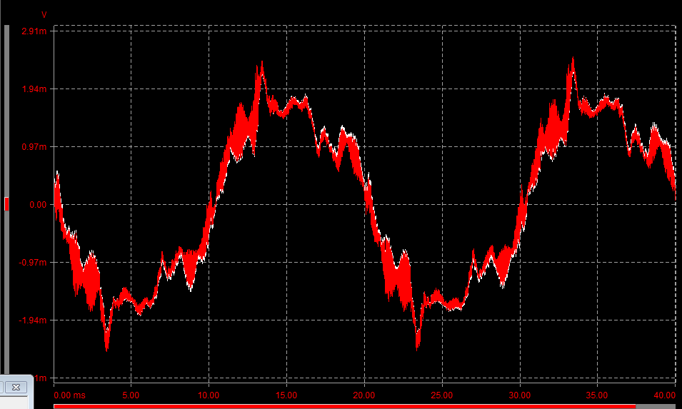

Well, today I spent on finding the culprit, and I found ... nothing.
The below is a nice scratching 50Hz picked up through air;
Analyser is not connected to PE, analysing PC is on batteries, DAC is switched off but PE-connected mains cable is in (see earlier description about the latter). Interlinks are XLR connected to the DAC, but in-DAC there's no connection at this time (to make this as clean as possible so nothing else can pick up (but since the interlinks are "open" at the DAC side, this is of course not the best idea for "no noise", but it really doesn't matter because of this overwhelming noise)). SE connected is even much worse.
The Audio PC is not connected and Off.
This 2mV compares to the normally 6 uV.
Without PE connection there's no problem at all.
I wish I had measured my mains before, for reference. Now I can only tell that this morning it was 217V (seems way low to me !!), and that the same voltage is in between phase and PE. Between neutral and PE there's a varying 200mV and 650mV or so (it is one or the other !).
The FFT (mind you, all picked up through air) shows a very regular pattern of peaks at certain (higher level) frequencies, that dropping, and right after that another higher frequency peak briefly arising and dropping back again. This seems to be happening at a simlar interval I see the beforementioned 200mV and 650mV alternating (each ~15 seconds).
Also there's a steady DC of 474mV between neutral and PE, 20-24mV between neutral and phase, and 26-30mV between phase and PE (both vary at the same time with a distance of 6mV amongst them).
I have no normal means anymore to get rid of the normal DAC-output DC offset values (which always have been 4-7mV), and *if* I succeed, it may go way up by itself later (but "by itself" seems to be switching off the TV or something).

« Reply #7 on: May 16, 2011, 08:48:28 pm »
Peter hi,
I plug the NOS1 into mains again without PE; There's the On/Off switch which has double poles. So, hot and neutral are both switched off.
In this situation there's not even connected anything towards the DAC itself. So, behind the mains inlet are the transformers, and behind the transformers are the PSU's. But, the PSU's are not connected to *anything* (all is cut). And remember, since the mains switch is off too, and the PE is not connected, there shouldn't be connected anything, right ? So, the cable is in, and the only thing which connects a little, is the PE from the cable towards the all outlet. There it stops, because there's no PE in that outlet.
Well, only putting in the cable makes the noise go way up (to really unacceptable levels).
Thus, there's a PE wire in the cable (cable is 2 meters or so long), that PE wire is connected to the case, and the case connects to 100% nothing in my situation (all ground inside is floating).
One idea but mainly questions.
Reading you first post the only connection from inside the DAC to the outside is the PE which goes from the DAC power socket into the mains cable but is not connected to the household PE at the wall socket.
Could the 2 meters of PE wire within the mains lead running parallel with the live and neutral leads be coupling the noise. Reading a few papers recently (as you know) there may be capacitive noise coupling between the live / neutral and PE wires within the mains cable. There could be more coupling here to mains noise than say from air borne RF. Could this be injecting the noise ?
  • Does the noise still happen with no mains cable connected to the DAC ?
  • What happens to the DAC noise if you connect a cable in the same way but with no PE inside the cable (ie just a two core live and neutral cable)?
  • If the 3 core mains cable length is varied (eg the PE to live parallel run is varied in length) does this inject more / less measured noise ?
217v does sound like a lot of sag its more than 10%, could there be something on your distribution spur (external to your house) that is dragging down the supply voltage and injecting supply noise ?
ps Is the plot your mains wave form or an air bourn noise trace I am not clear ?
« Reply #8 on: May 17, 2011, 10:38:59 am »
Hi there Nick,
In all cases the PE wire is in the cable, and connected to the DAC case (I never tried detaching it from the DAC case because I'm fairly sure no problem would be there then). So, the problem emerges when the PE wire is connected to the mains PE in the wall outlet.
Theoretically, yes. So, the phase and neutral in the cable (formed in a triangle fashion in my cace) could project something on the PE wire (remember, the neutral and phase are not connected in the DAC (double pole switch is off) but both are connected to the wall outlet).
No.
(the answer really is a little "yes", but too long winded for here, and not relevant; anyway what then happens is just normal).
I did not try this, but I can't imagine anything happening. Remember, this is to be compared with the not PE connected cable and switch Off. Then nothing bad happens either. So, you may want to compare it with switch On and see whether something which is OK (because it is in that case) then suddenly is not ?
Didn't try that either, but I can imagine so. On the other hand, this will be similar to being able to measure DC with all off (neutral and phase cut by the switch) and cable connected to PE (which actually is another story from longer ago). At first I always thought this was capacitance in the (PE) cable or something (and the length indeed may vary the capacitance), but today I think this is about a ground being able to create (DC) voltage from a Faraday cage which latter acts like a (magnetic) collector or something. Put your hand in it (touch nothing) and the voltage goes away.
All I know is that I have been measuring in the past and for sure saw more than 230V, if not in the 240's range ...
Whether there's something dragging on "my" mains is to investigate, but it is not what I expect (btw, I live in the country side). What I merely expect is out of phase stuff. So, very simplified (because the calculation goes different) : when we'd have 3 phases (and I do have three coming into my house) two of them creating the 240, but they are not properly alined, then all individual phases are still 120 (hence no exceptional drag) but my received voltage is less (but the two 180 degrees out of phase and 0 will remain).
In the mean time this will create "noise" as such, because no sine will result from it.
How this relates to the PE is something else, and depending on how the mains is setup in my situation (outside of the house and yet to find out), PE *can* be a reference for the phases, so it can be influenced as well. But this is not necessarily true at all, because it can work without PE reference as a floating system. But but but ... there you have it again ... if the floating system is not in balance (degrees deviation) the presented PE is not 0V opposed to ... my earth pin which I use for audio, but not for the PC.
You see ? I must stop (or shouldn't start) because there are tons to investigate first.
As per the reasoning of my previous post, it must be through air. Or in either case it is not a direct connection to the mains (then you would have seen that 217V, while this is 2mV).
Let's also keep in mind that what we call "noise" here, is totally inaudible through my system as noise as such (it's completely quiet). But, the system sounds like sh*t, because everything rides on it. For the DAC all is fine when not using PE (remember, at this time it's not even used and only connected to the case !), but for the amps it still will. So, tonight I will connect those without PE, but it's a little "dangerous" to just try it without measuring *those*, with again no reference for me, because I never measured them.

Let me first simply "state" that having more mains groups around the house is prone to prolems. swoonswoon
This, while we thought doing good with that. So, very generally, and a bit speculative for now, is that more of these mains groups - meaning each with their own Protective Earth (PE) pin or otherwise with different PE's, may or *will* create a potential difference between those two PE's (potential for our dutch readers in this case means "pontential to ground" (and not potential as in "possibly" Happy).
This does not seem to be an inherent thing (meaning : without anything connected to your means the difference will just be 0V - so no problem), but it is created by the devices you connect. Example :
Put the PC in one mains group, and put the audio devices in the other, thinking that the PC will spit its noise into its own group only. Aren't we all thinking just *that* ?? I think we do.
But for simplicity, let's think that whatever it spits out, exhibits as the voltage difference between the two groups. And *that* is noise, because the noise now can't go anywhere (please leave this latter be for now, and let it come across as something logical to you).
So, before I attempt too many explanations for phenomena I really can't at this moment, let's go and measure our differences in potential between *all* the groups related to audio. So, look at really *all* the devices you use, even if it's a liniar PSU for your USB connected device. Think about how all interconnects (via-via-via), and of course explore the different mains groups you use for it. Remember, groups with different PE (pin, etc.).
Hook up your multimeter (ready for 230V) to the earth pins of both groups (just find two outlets, each of the other group), and look what you've got. Remember, have *all* devices and interlinks connected as should !!
If you see more than 0V, you can improve.
If you see more than 0V, an analyser will show something like you saw in the earlier picture in this topic ...
If you have the problem, immediately stop trying to solve it by whatever commonly known means, because you probably will make it worse (and you can't see that without an analyser), nevermind you end up with 0V in the end.
Instead, move all your noise spitting sh*t to this one group of which you think it is made for it anyway. Remember, 100% everything.

Yesterday, in a kind of random situation - as much plugged out as possible, sutting down all the groups etc., I measured 67V over the two PE's of my groups involved.
Knowing this, this morning I started experimenting a bit, and this time all was connected again, and derived from the whole subject of this topic I solved my problem (already yesterday) I measured 0.00V. I didn't know that yet, and had the idea the 67V would still be there.
So, problem solved, and 0.00V now. Right.
Thus I started "phase two" as described above, and for your real life example - at removing an USB connection which via-via is linked to the audio stuff in the other group, I now saw ... 99V. And for those who know the subject, I also immediately got crazy of my PWM regulated pump for the heating system, which square waved exhibits its peaks at -40dB in a bad case.
No audible noise from the speakers (except for that 17.8KHz tone), and if I hadn't had that pump, I wouldn't notice it at all, except for most probably bad sound. But of course the analyser would show *that* picture again ...
At moving the PC to the audio group, nothing happens. 0.00V no matter that USB (or anything else like the DVI cable from the NOS1) connected or not. 0.00V stays forever, and the analyser will show normal 7uV or so noise levels.
Without further explanation, I know that this is not pure PC related. I mean, I had my subwoofers in again another PE audio group, and there too the voltage would occur.
And thus it is my conclusion that however it goes and travels, no different devices are allowed to interconnect once connected to different PE mains groups. Each group of such devices will create their own potential, project in onto PE, and the two (or more) PE's will create a new potential opposed to eachother, and that now can't go anywhere.
