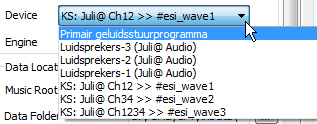

« Reply #14 on: June 11, 2011, 07:10:01 am »
# 4 Engine does not work, as I have written an error: "The Core Audio Engine can not explicity be
chosen; Instead select a Sound Device (above) and notice that:
- A device prefixed with KS: is Engine # 4/Kernel Streaming
- A device not prefixed with that is Engine # 3/WASAPI.
Engine # 1 and # 2 are obsolete and only bit perfect playback is possible "
See the bold text.
And see picture below. That is where you choose the sound device. The KS: devices in that list are Engine#4.
