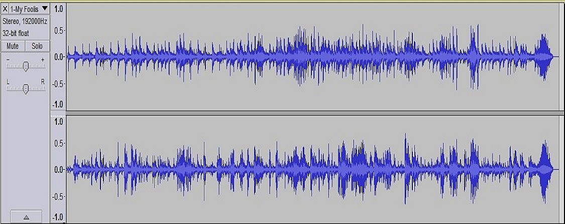

« Reply #77 on: August 12, 2011, 10:32:03 am »
Not Gerard's version, because that *must* be compressed (that's the (IIRC) 35% vs. 45% calculation I did in that post, while also there's hardly headroom left...
There are just so many of these versions going around! But I believe I have the same one that Chris has. Now if you compare the CD waveform that I posted earlier to the one attached below, you'll see that both seem to have a similar dynamic range, although the hires has a lower SPL. I've tried to adjust for this lower SPL in the second attachment (using a simple zoom) and if you align the two jpegs, you'll see that they're virtually identical.
I prefer the sound of the CD rip to the hires. I now agree with Peter that the tapes must have deteriorated in the last 20 years or so.

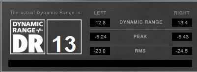

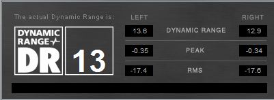

« Reply #78 on: August 12, 2011, 04:46:10 pm »
OK, last analysis from me  Wink
The CD rip has a higher dynamic range than the hires!!!
« Reply #79 on: August 12, 2011, 05:04:09 pm »
... which could well be because of denoising ...
(kind of wild guess because I'm not 100% sure that happened; but if it did, it can be an explanation)

« Reply #80 on: August 12, 2011, 05:28:24 pm »
Is in your case the CD louder or the Hires? From the peak value the CD should be louder...then my guess would be right Happy

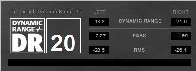

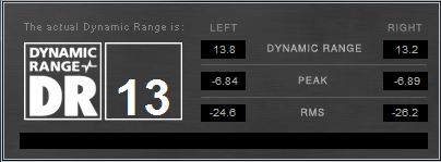

« Reply #81 on: August 12, 2011, 05:57:53 pm »
Yes, the CD is louder.
HOWEVER... this has nothing to do with the hires having a very loud peak or anything. It just doesn't have any louder peaks than the CD. I'm assuming that if you have 24 bits of resolution to hand, you simply don't need to go anywhere near the peak limit. With 'only' 16 bits, it becomes a bit more necessary.
But really, 96dB is already a lot. Even the best vinyl played on the best turntable would come nowhere near this!
The highest dynamic range I have come across is indeed the 1812 on SACD. I will attempt to transfer this to 24/192 and see what the dynamic range comes out as. But for now, here's the dynamic range on a Reference Recording 24/176.4 transfer from analogue tape.
EDIT: I don't think you'd want more dynamic range than a recording of a tom tom drum I have.

..... I don't think you'd want more dynamic range than a recording of a tom tom drum I have.
I certainly like my music with as much dynamics as possible, and there are no technical reasons why all redbook albums can't be produced with average DR's at 19 or even higher. It just takes some guts and foresight from the recording engineers and producers to do it. Of course we all know that's never going to happen though ... see the 'loudness wars' for one reason.
One example of a record producer who did accomplish fabulous dynamics was DMP ( Digital Music Products ) established by Tom Jung. By minimising interference to the microphone output and recording direct to the master, DMP have been recognised as having one of the cleanest and best dynamics in the business. Alas, they no longer are in business from what I understand, but if you want to experience what is achievable, go a huntin' on ebay or even some of the bigger record stores which may still have some stock.
I did a DR test on the very popular Telarc's 1812 Overture by Erich Kunzel and the Cincinatti Pops and the results are below. Those real cannon's would certainly have helped to lift the DR value.
By comparison, look at a couple of the many DMP albums I have. Listening to tracks with a DR of 23 is exhilarating and makes you realise how much we miss out on from your average humdrum recording.
If anyone has albums with higher DR values I'm all ears (pun intended!).
