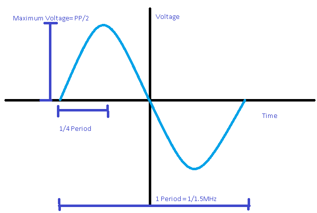

« Reply #17 on: August 20, 2011, 01:27:15 pm »
Up to some degree, sure yes. I mean, in order to suffice a certain bandwidth, first the slew rate has to be sufficiently high to not let mix up the subsequent "samples" (but notice this is about analogue). When this is met, next the slew rate can still be very much higher, while the bandwidth does NOT increase
So you can calculate the minimum slew rate from bandwidth but not the maximum. The calculation should be:
Maximum Frequency fmax=1.5 Mhz
Maximum output voltage Vmax=30V
Minimum Slew Rate [V/us]= fmax*Vmax=1.5MHz*30V=1.5*10^6[1/s]*30V=1.5[1/us]*30V= 45 V/us
It has to be considered, that the amplifier has to change the voltage from peak to peak in half of a period. So the result must be multiplied by 2.
Makes a slew rate of 90V/us
If the maximum voltage is given in RMS and not PP, which is the normal case, you have to multiply by 2*SQRT[2].
The minimum slew rate would be then 254,5 V/us.

Flecko
Posts: 474
« Reply #19 on: August 20, 2011, 03:55:37 pm »
I don't see any of the subjects I brought up in your math ...
I used the unit V/us becuase it is more intuitive. I derived this based on the definition of the slew rate, which is the rise time from voltage "a" to voltage "b" in a given time. If you start with this definition, the maximum frquency and the maximum voltage is directly linked to the minimum slew rate.
Nope. This is not difficult for an amplification because this is a "swing". Maybe not exactly true for a square wave form (what this will be about), but if the length of the high voltage sustainment is short enough (the highest frequency = the highest bandwidth) it comes close to that. But since you leave this out of the equation anyway, it can go in all directions ...
It has nothing to do with the amp or how the total signal could look like, it is just math. If you have a sine, and that is what we always have no matter how the total signal looks like (because every signal is just a linear combination of sines), and this sine is at the maximum frequency your amplifier can handle (in this case 1.5MHz), the steepness of the curve, in other words the slew rate, you need to reproduce this sine is dependent on the "voltage change" per "time" unit. If you use one period as the time the voltage should change from Vo=0V to Vmax=30V, you use a number that is only half as big as what is actually needed.
I have made a scetch. You can see that to reach the first maximum of the sine you have 1/4 of one period. This maximum is at a voltage off pp/2. Hence your slew rate is PP-Voltage/2 times 4*Maximum Frequency or simplified PP-Voltage times 2*Maximum Frequency.

Flecko
Posts: 474
« Reply #21 on: August 21, 2011, 02:29:42 pm »
I think if you go this direction, it is waaay too simple. Not that I would be able to make the story complete (on the real math I mean), but if you talk like this you'd have to give definitions for overshoot (limits), allowed ripple and what not, and I am not sure it works like this for the functional aspects we are trying to talk about.
It should be that simple because it is just an estimation of the minimum slew rate. The real slew rate must be meassured. But I think it is good to calculate a lower limit of what is to be expected from the amp. The real slew rate should be always higher than the calculated number. So we are on the safe side.
If you, for example, want to talk about the as good as possible representation of 20KHz (assumed that is audible or at least senseable), you'd have to start with what comes out of the D/A converter. You'd have to start with no filter at all (and the amp representing that sh*t because it is good (on the slew rate)) vs. common filtering as needed and applied (I'm not talking NOS1 now), that not demanding anything from the amp (because it's stupid 20KHz sines always without real "impulse" data).
If the amp should reproduce a perfect sine wave at a certain frequency, the slew rate must be higher than estimated, because the sine has a maximum slope at the point of zero crossing, that is slightly higher than what I have assumed.
I think it gets too complicated if you incorporate other equipment and it is not necessary. There are simple boundary conditions. The maximum Voltage and the maximum frequency. If you want to fullfill this boundary condtition, the amp must have a slew rate, that is high enough to reach the voltage in the expected time. The amp could have a higher slew rate but not a lower, otherwise the datasheet would say something wrong.
Theoretically one could start off with 30KHz as a "senseable" frequency because it easily can be there in properly done HiRes. But use 50KHz to be on the safe side, although I still must see a properly done HiRes which can represent that. This is the easy one. The more difficult one is 50KHz of impulses (On/Off sound) because that theoretically can exist too. Synthesized at least. But, stupid, plus I don't believe much in the "senseable" thing. So, maybe better stick to 18KHz as a realistic On/Off which can be audible for some. *Now* do that math ...
I am not sure what you mean by the on/off thing. You mean you have an outputvoltage of 0V and than suddenly you switch the siganl (music) "on" and imedeatly "off" again?
If this would be so, the shape of this pulse would be determined by the bandwidth you have. For very short pulses you would need very high frequencies. If your amp can not represent this frequencies, the sharp pulse would get flatter and wider. It depends of the frequency content of the puls, if anything will come through. The basic principle is, that no matter if we have digital data or analog data, the slope of any puls should be stricly limited by the bandwidth of the equipment. This also should be true for the "resolution" the amp has, to make it possible to differentiate between two pulses, which are seperated by a very small time. If the pulses are so close to each other that it crosses the maximum frequency your amp has, or what ever hifi equipment you want to look at, it will not be reproduced as two peaks. It will be smeared and maybe reproduced as one peak or it will not be reproduced at all if the bandwidth is too small.
There is this philosophie of having a high bandwidth, which is much higher than what you can hear. Reading the article I mentioned earlier, I would say this high bandwidth is a byproduct of getting the amplifier fast to get the negative feedback work well. Having higher bandwidth also should prevent phase changes in the "used" frequency range.
For the math so far, nothing should change, because we only have used basic principles that hold true under any situation.
