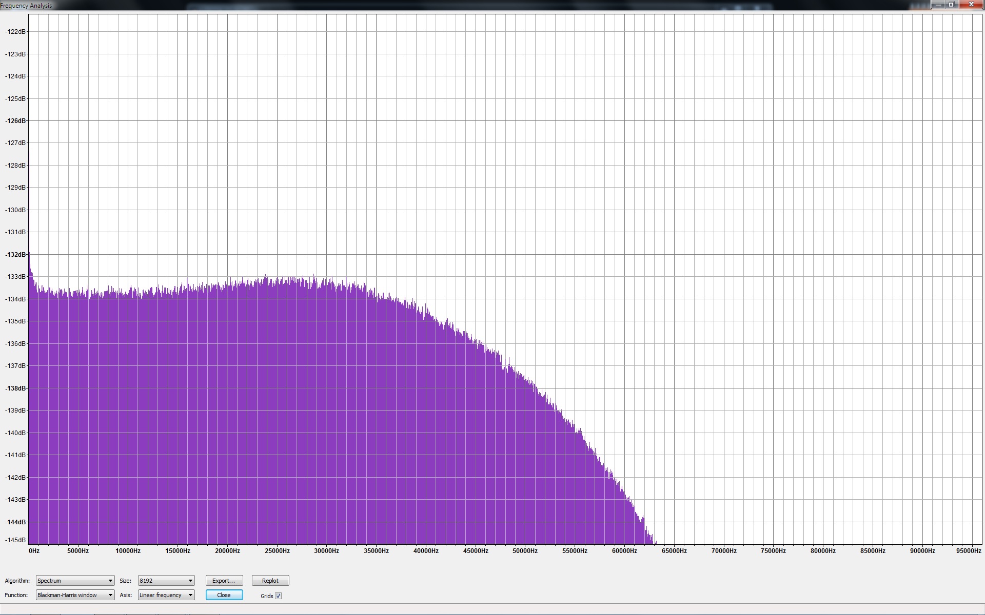

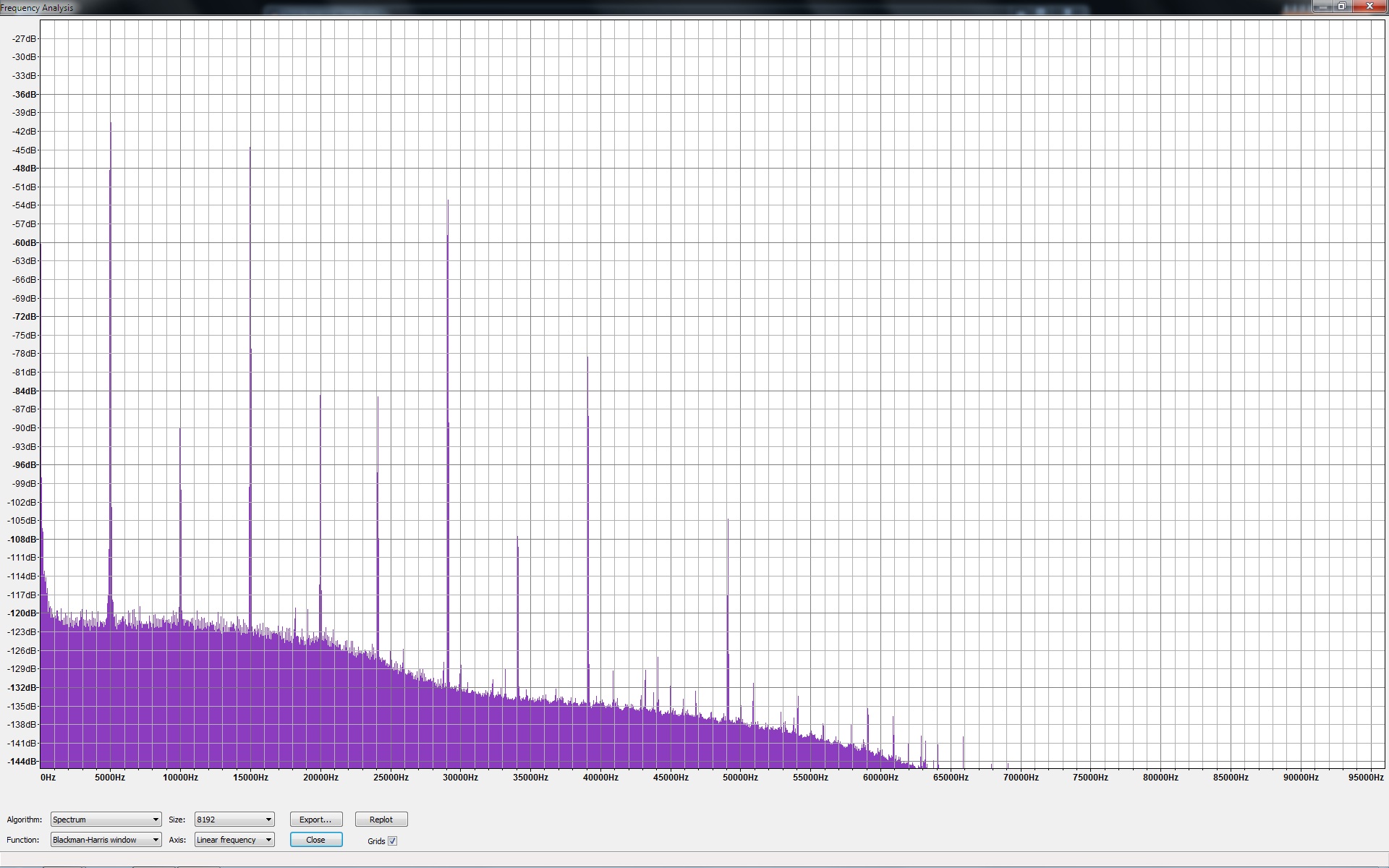

Find below three spectrum plots. These were derived from a 10 second 16/44.1 file of a 5KHz square wave.
1. This is the spectrum of the file 'upsampled' to 24/192 using the iZotope program without any anti alias filter applied. So this upsampling was done purely in software.
2. The second file is a 24/192 recording of the 16/44.1 file being played back on XX. The details here are:
- XX set to Double Octo (16x) Arc Prediction -> 705.6KHz
- PC connected to NOS1 via USB
- NOS1 set to 'DAC is 24/786'
- NOS1 analogue output connected directly to PM2 analogue input
- PM2 analogue-to-digital conversion set to 24/192
- PM2 digital output connected to Weiss AFI1 via dual-AES (PM2 master clock)
- AFI1 connected to second PC via firewire
- digital output captured on second PC with Sony 'Audio Studio'
3. This files shows the noise floor of the complete chain above.
So what's there to learn from all this? I'm not sure...
But firstly, all the peaks above 22.05KHz are really 'false' and unwanted - only peaks which are an integer multiple of 5KHz would be 'real', and there are essentially none above 20Khz because the original file was only 16/44.1.
However, I'm amazed at the similarity in the waveforms between 1. and 2. Something is telling me that what I'm showing is a great demonstration of the accuracy of the NOS1 - the fact that it can match, almost identically, the upsampling done in software.
What none of this shows, however, is how the NOS1 sounds with Double Octo Arc Prediction. I've compared a number of tracks upsampled with iZotope to 24/192 (with and without an AA filter) vs. DOAP. Upsampling using iZotope just 'kills' the music (and iZotope is supposed to be the best SW upsampler!).
What I set out to do was to 'prove' how good DOAP was. Again, I think I failed. But did I manage to show something of any value meantime? Maybe...

« Reply #7 on: September 18, 2011, 05:30:14 pm »
Not all that easy to understand !
What I many can add to it, is that there's filtering active beyond, say, 20KHz. Because ... wat you see beyond that is not the "per 5 KHz" ranging of a next harmonic. No, what you see *there* the the "per 5KHz ranging "back" of aliasing with 192Khz as the mirror. Start looking back from 48KHz to see it more clear.
Meaning (I think !) ... there "are" essentially none in the reconstructed 44.1 file, because no more than 22.05KHz kan be in there; however, they show because no Anti Aliasing was applied.
I tried to make more conclusions, but it is a bit hard to compare the two first pictures, even if you have two open in two browser instances (because it really needs the whole spectrum to be compared. Also, it may be too confusing what is and what is not influenced by the "recording".
Lastly, maybe this is not all that much accurate for a test at all. It may proove that AP is not messing up badly, but the accuracy is at the sample level, and not in a wild FFT, again, if e.g. AP would show it completely different it would only tell that it is wrong all over. Now it's equalish, it doesn't tell all that much.
« Reply #8 on: September 18, 2011, 06:07:34 pm »
No, actually no 5KHz multiples show at all. Many peaks above 22.05KHz look very, very close to being 5KHz multiples, but they're really not.
There's probably nothing to be learned here. But I had fun playing with this all, and still remain impressed by the fact 2. is so 'clean', even having passed through a DAC, an analogue output stage, an analogue input stage and an ADC.
« Reply #9 on: September 18, 2011, 06:43:51 pm »
Of course you are right. I said that myself ...
Still, think from 48Khz down. There they are again, but now as aliases.
