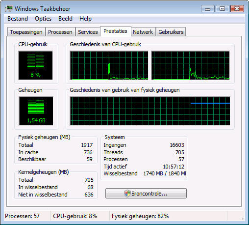

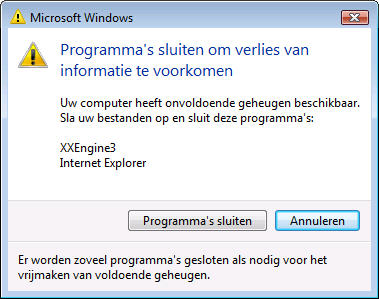

I have got a memory message this afthernoon after using XXHighEnd 0.9k the whole day. This has happened now for the third time I'm using XXHighEnd.
See attachment 1 "Memory" and  2 "Taakbeheer" 3 "Taakbeheer" after a reboot of the system. I am using this PC only for Audio (I know, you can see that the Internet Explorer is also active).
Johan

« Reply #42 on: October 01, 2007, 01:06:04 am »
Hi Johan,
Thank you for this information;
Could you please tell me :
For how long were you running XXHighEnd without pressing Play, Next, Previous, IOW how long was it running without touching anything before this happened ? Note that dragging new tracks onto the Playlist Area during playing (it just grabbing those for further playback) does not count as pressing Play etc. as mentioned.
Did anyone else bump into a thing like this with Engine#3 ? I myself have never seen this.
Also note Johan, that 1.5GB of memory is on the low side. E.g. two subsequent tracks consisting of near a full CD can't load with this. Not with Vista itself using 400-500MB.
