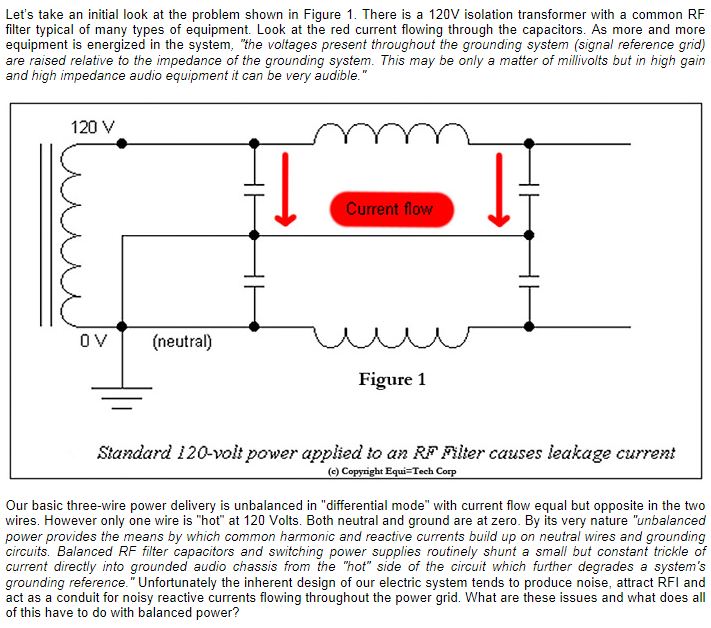

Hook up your DC Voltmeter to the two ground references. You should see something. Now, start switching on house devices like phone adapters or motors or possibly amplifiers and the like. Watch the DC Offset change with it.
Now envision that this DC Offset mangles with at least your house ring ground reference. So, mid point e.g. goes up, and think about the part of the (hot point) wave above zero (which should be lower now in amplitude ) and the one under it (should be higher). Here you are turning that sine into something else.
In the mean time your AC output changes too. I never looked at it on the analyser, but while net the result should be the same, it won't because of the wave shape and let's say (for easily envisioning it) clipping at one side.
This all is about your consuming devices fireing back to the mains because of they changing the ground reference.
It may not be an official thing, but this is how I once could look at it. So, that consuming device is not a "balanced device" like in "it draws from both the phases separately" (see earlier posts about this - the 115v/115v thing) but as how I look at it, it will draw the ground towards "itself". So, where ground is to be 0V (which is a virtual thing always, but works for the physics in order) and a device is consuming the 230V, the ground goes up by, say 5V. I know, for AC this can't work, but I think something like switching power supplies ay use the positive side of the wave only or more than the negative, which depends on how the AC/DC conversion is done.
Attached are are a couple of snippets from the article.

So in real life , If I use in the practice a transformer ( like in fig.6) from the mains to split the 220V in to two phases (115-0-115) , I can connect the PC to it for example ( included the new ground )  and all works pretty fine.
The only thing I see is a Voltage between the Transformer ZERO and the house earth . This voltage is about 70Volts , which goes to about 10V with a current flow in the order of uA .
If we want to be safe , and sure to protect our audio inputs againts that , it is better to let flow that little current -OR - connect all the HI-FI gear to the transformer .
Just my thoughts .
In my case, the DC voltage between teh transformer zero (bonded to my dedicated earth) and the house earth is only 0.25V. The AC voltage is 0.4V. I can live with 100-200 nA.
