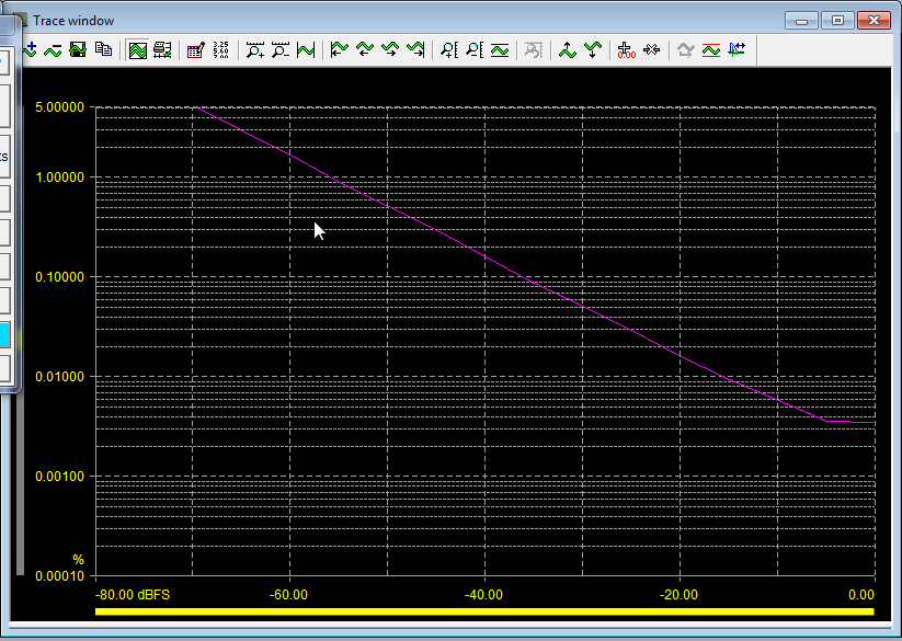

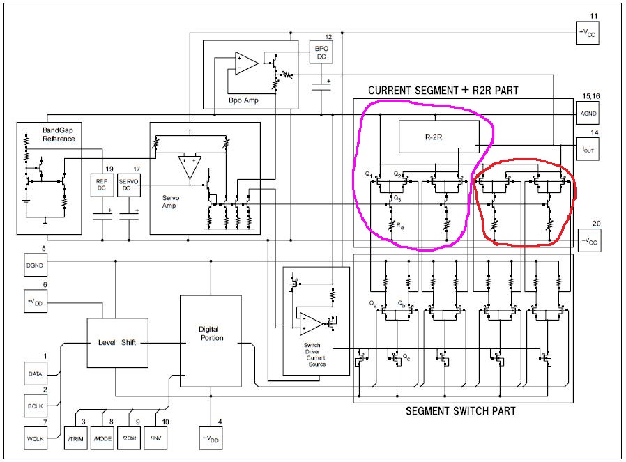

When you speak of full scale not being ideal on the 1704, are you referring to how it's loaded or to intrinsic properties of the chip itself?
I hope that the correct answer (regarding the question) is : both. So, first the maximum signal (always -3dBFS in my case), and next load it such that the highest output (in Voltage) comes from it. In that case the FS (-3) is not the best (IIRC this shows just in the curves in the datasheet). Attenuate this digitally with 10dB (up to 22 or so) and you are better off. The same can be achieved by a lower resistance to the chip (so it will have less output) but all what happens is that the curve becomes linear - hence at FS it then it as its best. Funnily enough (or logically I think) the effect is nearly the same, because you will have less output, and thus can use less digital attennuation. So, this (also) balances out for THD. But you can't be rough about it, because all is a very fine tuning thing. Here you see something of it (open this post in another browser instance and put the pictures next to eachother so you can do alt-tab to easily compare). Watch the yellow lines only :
The first one ends (FS, at the right side) at something like 0.015%. The curve is linear as you can see; each more digital attenuation will degrade THD linearly. Now compare this to the second picture, which doesn't show linear at all. THD at FS is now a tad worse only, but as you can see it is better in quite some attenuated range (some -4dBS to -20dBFS for sure). FS is still quite OK too, but attenuating is better. And what you also see is that the second picture is better all the way, up to -60dBFS or so, where things collapse. This is okay with me, assuming we can perceive a DR of 70dB max only anyway, but, of course this is relative to the attenuation to begin with (notice that this -60dBFS is not only happening because of attenuation, but already with softer music (or the more micro detail of it if you want). But this is the chip, and remember, this is passive and only tried to squeeze out the most of it, which was 315mV in this case (in the end I achieved 630mV by another setup).
Now also look at the purple line in the first picture, which clearly does better at the low end. Way better in fact. What does it tell you ? that this isn't alowed to be used with less than -10dBFS of attenuation, and when that is applied THD is at its optimum from -10dBFS to -30dBFS. Attenuate more is allowed, but less sure is not.
In fact this is what I was talking about all the time and here you see it happening, once the load is so that this emerges indeed. And of course you start to feel how complex this is because in the end any curve is possible and it really can be so that a worse looking curve performs way better if only some guidelines are followed (like that purple trace would need a guide clearly).

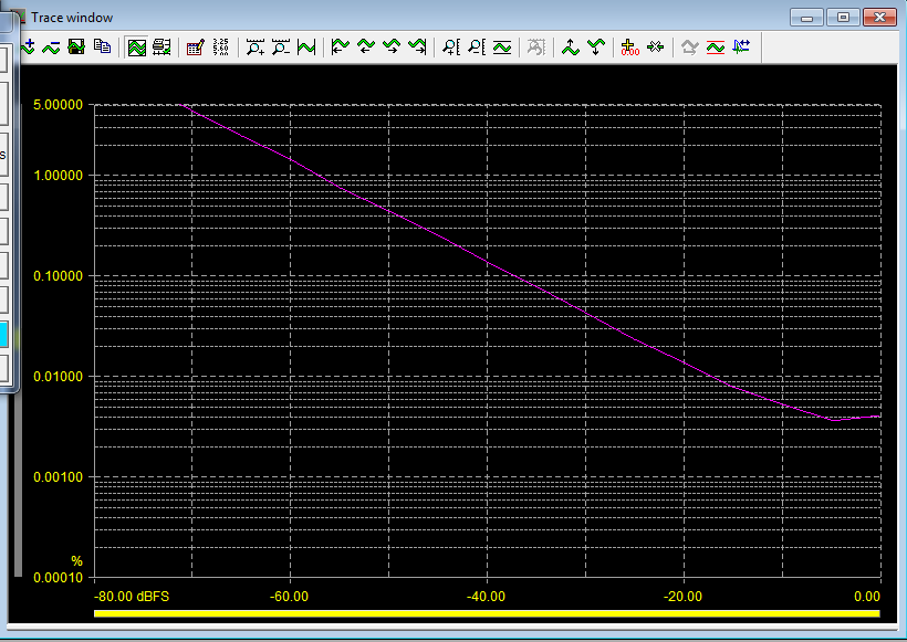

Below you see two more where the first one reaches almost 0.0012% at Full Scale. The second one makes ~0.00125 of that but can sustain it to -6dBFS, which the first one can not. So, better than the before pictures. Small problem : this is 115mV output only and even for me unusable.
I showed you the last two pictures, because it should make clear that this is the base of it all, and once we are going to amplify this, the base - hence those curves stay. Still it is not said that I use one of the latter two for the base, because the overall THD (at more attenuation) is worse again. There is no free lunch anywhere (we say it must come from the length or the width, which is almost literal here), but we still can chose the best and apply some rules more down the line.

gsbrva
Posts: 31
« Reply #67 on: May 19, 2012, 05:33:05 am »
I envy your capability to post those analyser pics Peter.  I see what you mean about the distortion at FS.  A lot of things make more sense to me now.
I'll try to attach a file.......
Maybe other readers, even if you aren't technical will find this interesting.
Here is the inside of the PCM1704 (see attached jpeg).  I thought it might be helpful to see where the business of producing the sound is happening.  The diagram shows only two bits due to space considerations.  I circled the MSB (no, should be highest current bit) section in red.  The other bits are represented by the single section circled in magenta and are typical for the remaining 22 bits.
You can see that the highest current bit switch (in red) is connected directly to the output. With a low Z load, nearly all of it's current will sink into the load.  The other bits are summed progressively through the rungs of the R2R resistor ladder and summed to the output.  The rungs of the ladder divide the currents from the lower bits to give the decreasingly less current for each lower bit.
I think it's interesting that the NOS1 sounds better with some attenuation.  If you digitally attenuate, each -6db, abandons the use of another significant bit.  First the highest current bit is unused and then the adjacent sections as further attenuation in 6db steps.  For each additional -6db, the summing point for the bit currents is moved further down the ladder.
The lower bit switches that connect into the R2R ladder load are already working into a higher impedance than the highest current bit section by design.  They already swing voltage regardless of the load on the DAC, unlike the highest current bit.  (back to the HF filter arguments again, lol)
Thanks BTW Mani for the report on your past volume control tests.
I wonder if the slight advantage in dynamics (for digital attenuation) you heard was due to voltage swing issues in the MSB.  Having the load non-ideal (for completely understandable reasons) might make that bit current slightly out of calibration and perhaps affect adjacent bits as well.  It depends on operating conditions of those switch transistors and we can't easily know that.
On another related topic:
You might see my point now why I tried to say that the resistors in part of the ladder are working in a similar way to an analog attenuator.
When you are not using the higher bits, those switches are left in a static condition and that unswitched section of the R2R ladder is just a resistor acting as one leg of a voltage/current divider out to the load.  The bit currents have all been summed previously in earlier steps of the ladder and the signal flowing is the complete analog signal.  The resistive divider is attenuating this signal voltage.  That is the definition of an analog volume control. Happy   All IMHO of course and I'll wait the response.
Back into theory heh.  With an ideal load (maybe not possible at this sound quality) then the advantage of digital volume should disappear, yes?
Sorry Peter, but I couldn't resist having one more go at this attenuator sparring (as you say)!  It was just too tempting.
BTW, I do have 4 of the K spec 1704 chips, but I thought I'd try damaging the regular ones first Happy  I would tell you guys the I/V design, except it might sound like cr*p and I'd prefer at least some of my failures be private!
Anyway, another can of worms is open Happy.
(post edited to correct misuse of term MSB by me)
Greg

I think it's interesting that the NOS1 sounds better with some attenuation.  If you digitally attenuate, each -6db, abandons the use of another significant bit.  First the MSB is unused and then the adjacent sections as further attenuation in 6db steps.  For each additional -6db, the summing point for the bit currents is moved further down the ladder.
I thought the msb is allways involved no matter how much you attennuate since it is determining the dc value of the output. Iow you only attennuate the ac component made by the other bits in the r2r ladder.
Am I missing something here?
Regards, Coen
gsbrva
Posts: 31
« Reply #69 on: May 19, 2012, 02:50:08 pm »
Hi Coen,
You are right, in a regular ladder DAC that is how it would be.  However, look at the bit switches and think about the Colinear feature.  In this chip, the MSB in the word determines which bank of switches are used (positive or negative) and depending on which side of zero all bits are processed on either upper or lower section.  If the total value of the word is more than 50% of full scale then the highest current bit of that "bank" is switched on.  This way you never cross zero with MSB currents.  You can see the two banks in that every bit section contains two differential pairs of switches.  Very clever, these guys Happy  At least that is how I think it works.  I have to be careful here in case someone who actually knows this stuff chimes in.
Greg
Digital playback system = XXhighend 0.9z-6-1c KS adaptive (engine 4), Dev Buffer 2048, straight contiguous > Windows 8 64 bit preview, Quad core Q6600 Intel 2.4 ghz, 6gig memory > P965/ICH8 chipset w/usb PCIe NEC USB3 card > Hiface Evo > I2S > NOS TDA1545A/1387 w/Crystek CCHD-957 clock chip backfeed to Evo ext clock in > dac current output into low Z transformer input Altec A256C beam power amplifiers> Quad ESL63 pro
gsbrva
Posts: 31
« Reply #70 on: May 19, 2012, 05:29:51 pm »
I should not be using the term MSB to talk about this.  Yeah, no attenuation on that bit as it always must exist in the word.  Inside the dac is different.  I'm not a digital guy, so I struggle for the words on this.  I should maybe say, the highest current bit instead?  I'll edit my posts so they make more sense.  Thanks for pointing that out.
Greg

gsbrva
Posts: 31
« Reply #72 on: May 22, 2012, 02:53:39 am »
Please bear with me, I am going somewhere with these posts Happy and thanks for the reply Peter.
Still not sure if I should use MSB and LSB for the ends of words that get truncated.  I ended up confusing myself with that.  From now on I'll use the bit numbers as shown on the datasheet.  MSB of the original word is 1 and the LSB is 24 (for 24 bit audio).  Sorry all for the sloppy way I worded that post.  I'll try to clear it up now Happy.
One of the reasons I posted the schematic is I never saw a good explanation of the 1704 internals and what things there affect the sound in which ways.  I did quite a few searches and only found that Japanese application note and I can't read it either BTW Happy  At least the schematic is clear.  It has been posted elsewhere on the net, but with little or no explanation.
I think I understand the point you are making about dynamic range.  However, I'm still having trouble with valuing bit depth based on the noise floor.
I'm also still wondering about filtering benefits if using more than 4 bits for upsampling.  I'd love to see a spectrum analyser, but maybe it wouldn't resolve.  I suppose you have done listening tests and I cannot do that yet.  I also question if small transients and noise riding up near the high frequency limit, might get imperfectly filtered at 4 bits.  I mentioned in another post that I couldn't understand how adjacent words that only differ by one LSB (at 16bit) can be filtered to an arc with 4bit upsampling at x16.  That is still confusing to me, since the math doesn't work.
So, if a normal analogue volume control would be changing itself 10s of thousands of times per second, then maybe. Haha.
But on this part an R2R D/A chip wil only make things worse, because now there's also the "glitch distortion" (there's a more formal pehenomenon for that, but I forgot it at this time). But let's say this emerges by the current changes themselves, a bit similar to the "zero crossing" you taked about, though way smaller. You can (also) well say that the current the chip needs is changed by herself to it deteriorates herself.
I don't think we are seeing it the same way.
I'll try to explain my mental image of it again.  This is what I see when I look at the schematic:
At zero, the two switches for each bit are in opposite states.  Each controls a separate current for that bit.  One is normally open and the other is normally closed.
Depending on the state of bit #1 MSB, closed switches can open or open switches can close, for either positive or negative waveforms (from zero).
Starting from silence, as the signal level builds, increasing large bit currents are used starting at bit #24(LSB) and working towards #2 (max current).  The state of the #2 bit switches never changes unless the signal exceeds -3db.  The state of the #3 bit switches never change unless the peak signal exceeds -9db, with bit #4 at -15db and so on.
As TI / Burr Brown says in the datasheet "The sign-magnitude architecture, which steps away from
zero with small steps in both directions, avoids any glitching
or large linearity errors"   (edit:  They call this Colinear in the PCM63 datasheet)
The high level bit switches don't do anything at all unless there is high level signal.  When you digitally attenuate, you are removing the possibility the high level signals can exist, so the high level bit switches sit idle.  The output end of the ladder is just sitting there as passive as can be.  Even the closed switches are a very high impedance current source and have no effect.  There is no switching or glitching, just analog attenuation.
This is very different than my lowly TDA1545 or other dac designs.
Each time the digital attenuation reaches another -6db boundary, another bit switch section can no longer be actuated since those word values cannot possibly exist.  So if I'm right about this Happy.  We have the first boundary at -3db (since there is a possible +3db for peak extend).  Any digital attenuation of -3db makes it impossible for data to exist that could actuate the bit #2 switches, so that section of the ladder then becomes passive.  When digital attenuation of -9 is called for bit switch #3 is likewise idle and another section becomes passive.
Those now passive sections of the ladder each attenuate 6db (when properly terminated) The signal is already analog at this point inside the dac.  It is analog because it is complete and contains all the bit currents.  The bits have been summed (1 bit per rung) through the R2R ladder.  By digitally attenuating, you are progressively moving the active digital portion back up the ladder away from output end in 6db steps (1 ladder rung at a time).  I'm guessing that the rungs are composed of 500 and 1000 ohm resistances, since they claim 1000 ohm output impedance.  As you digitally attenuate, those resistances are still dividing current/voltage, even if there are no bit currents being added at that ladder rung.
If you took that same resistor network and put it outside the DAC what would you call it?
I now view this digital attenuation as an analog stepped pad inside the dac with 6db steps, in series with a 0db to -5.999999......db digital pad.  This is inspired by our debate Happy
The "analog" steps should be slightly wrong (not 6db) for the first couple steps since the ladder is intentionally terminated out of spec(for passive I/V), if I understand correctly the NOS1.  This also explains the distortion graphs you gave since the current division in the R-2R should develop small errors as the output end is approached.  The last couple bit currents in the ladder would not get divided as accurately.
The distortion graphs are actually strong evidence that my explanation is correct, I hope, haha.
Maybe this view seems crazy and If I'm wrong I would certainly appreciate a better explanation.
Greg

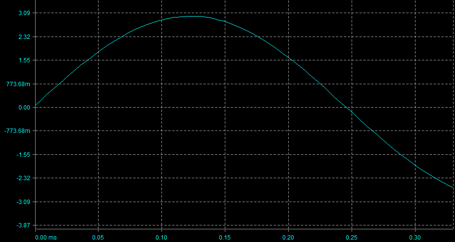

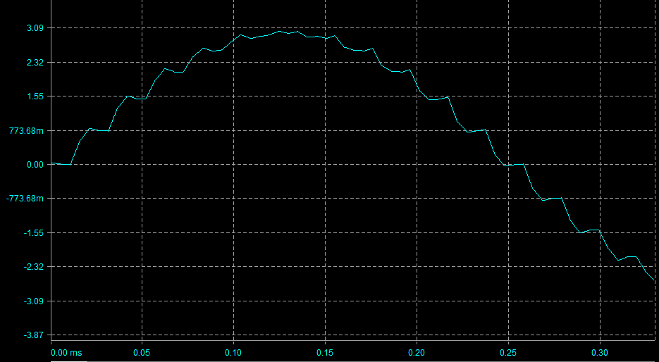

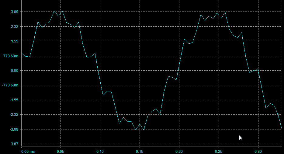

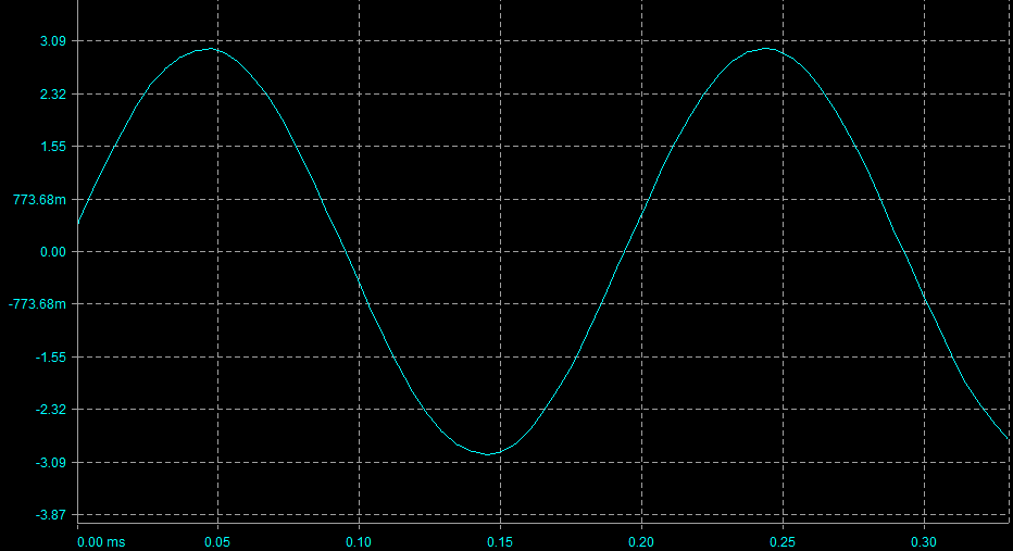

« Reply #74 on: May 22, 2012, 10:24:30 am »
PS: I grabbed these older pictures from somewhere, but I think the first of the sets are not right for how the one step emerges into the other. The steps are sure there though, and it is about that.
