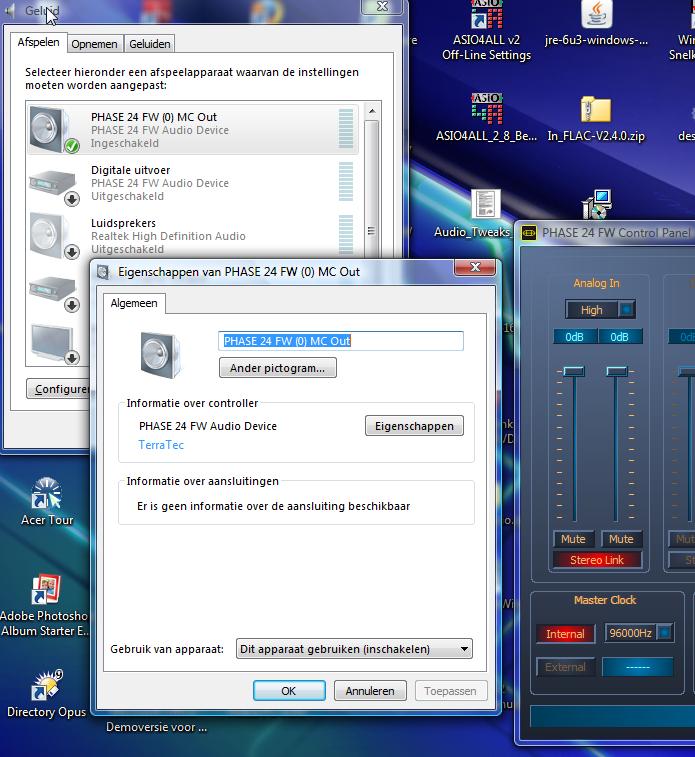

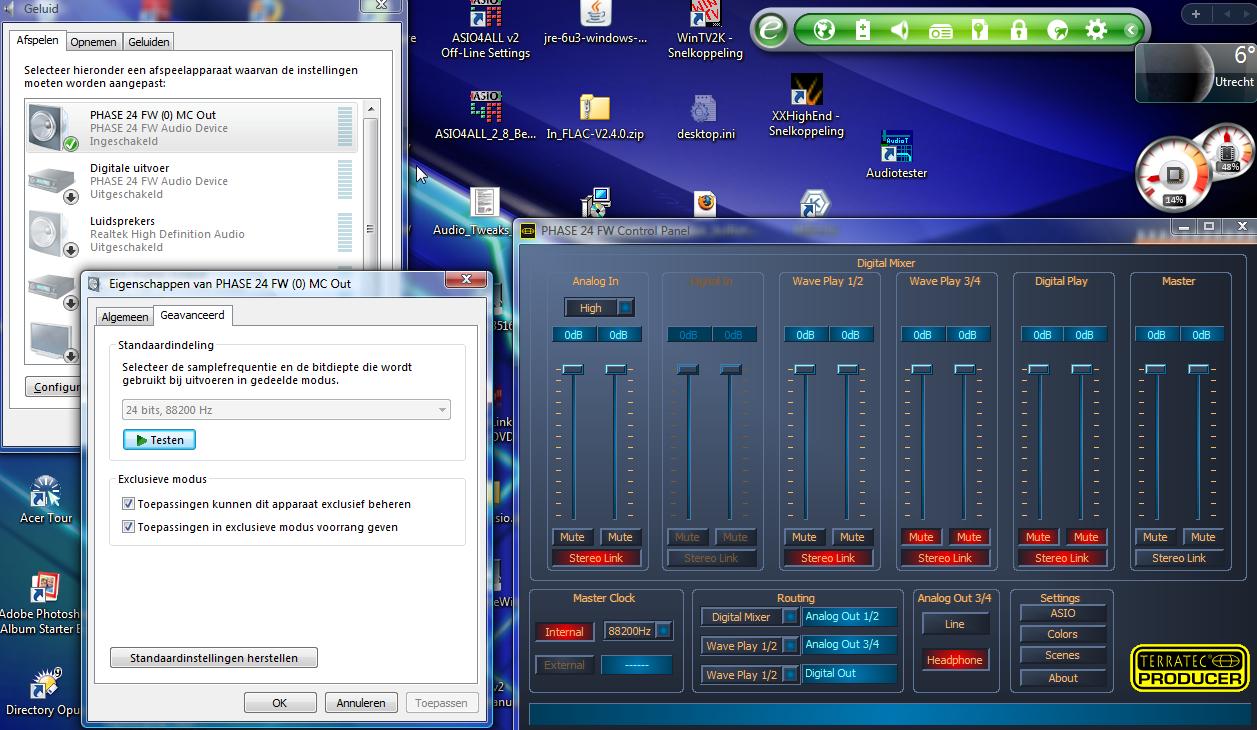

« Reply #34 on: January 12, 2008, 06:12:22 pm »
OK there is some consistency!
When I (re)start the laptop the samplerate is set to the one I used before I shut down.
This was 88 and I could go to the advanced settings and push the testbutton-> NO SOUND.
Then I changed the samplerate in the Terrateccontrolpanel (In windows not possible) to 96
and then there was no advanced settings but in the rightmouse-menu I could test and get a sound!
The same for 44. Then back to 88, in the advanced settings it was now possible to get a sound.
So only for 88 I get the advanced settings and can set exclusive mode on, but this is not working (24bit?).
When I change in TT-control to 44 and restart the laptop I get the advanced settingstab only for 44.
Now I have to change again before I get a testsound.
Well I hope this will give you the information to make your program perfect!
As I understand you correctly the exclusive mode will work if you output 24 bits?
As my suggestion before maybe the possibility for samplerate/bitdepth could first be implemented only for the output. I hope it is easy for you to add some bits and multiply the samplerate?

Posts: 16827
« Reply #35 on: January 12, 2008, 07:09:45 pm »
Maybe ...
It depends a bit (hehe) on what you mean by this;
What does it mean in your situation "can set exclusive mode on" ?
Also, what message(s) do you get exactly when you "now" (??) try XX and Engine#3 ? (remember, it can't work with 24 bits, but the (sequence of) message(s) is important ...
Do note that I think you have to try with 24 bit material, because only then Engine#3 will try to make a legal connection to your soundcard which can only do 24 bits (or ?).
PS: Your first screenshot won't come through ... (it might be important for me).
« Reply #36 on: January 12, 2008, 10:36:04 pm »
For exclusive mode i can set the properties on (set the checkbox to 'x'), but I when I start XX I get the message 'Device currently does not suport/allow exclusive use. It will not be bitperfect' I push OK and the music starts to play. Of course only when I set the Terratec to 44k. When I set XX to 'double' I get the message about 'Device can not be allocated because of not matching sample rate'.
When I set the device to 88k it gives the first message again and happily starts to play.
Since I can not set the bitdepth in the Terratec I think it accepts everything you put in it. When I use engine #1 and #2 there is no problem with bitdepth and samplerate.
