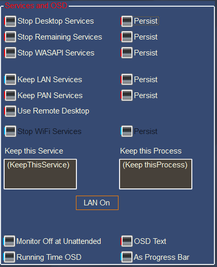

How to use Unattended Playback
For starters, do not activate Monitor Off at Unattended. So, we'll leave that on for now, so we can see what happens.
Also, do not start out with Minimized OS. Remember, that is unrelated to Unattended.
With the Unattended button active, you press Play.
Assumed you shut down all there is to shut down (see above, and not the monitor), a message will appear telling you any remainder of services at that moment is shut down, and when this has been accomplished, the screen goes blank and audio starts playing. Notice that without Minimized OS it can easily take 3 minutes or more before all is shut down. With Minimized OS that's merely 3 seconds up to nothing.
(when you have the Coverart functions activated, Coverart will now be shown, and when OSD Text is activated, texts at the top and bottom of the screen will tell you what plays)

Now you can combine it with Minimised OS Mode, and activate that button which tells to switch off the monitor when playback starts. All contribute to the best sound you heard ever. With the monitor being off you won't see a thing, but it's on by again by touching a button or moving the mouse. Want to have the monitor "internally" (!) switched off again ? use Alt-x and cross away XXHighEnd. Now the monitor will be switched off again.
