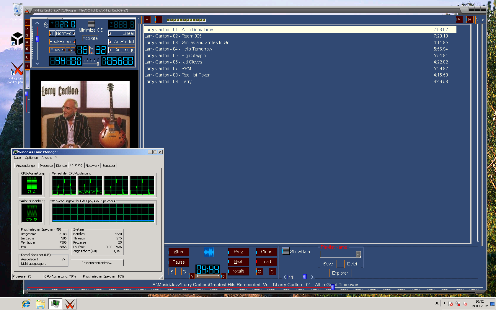

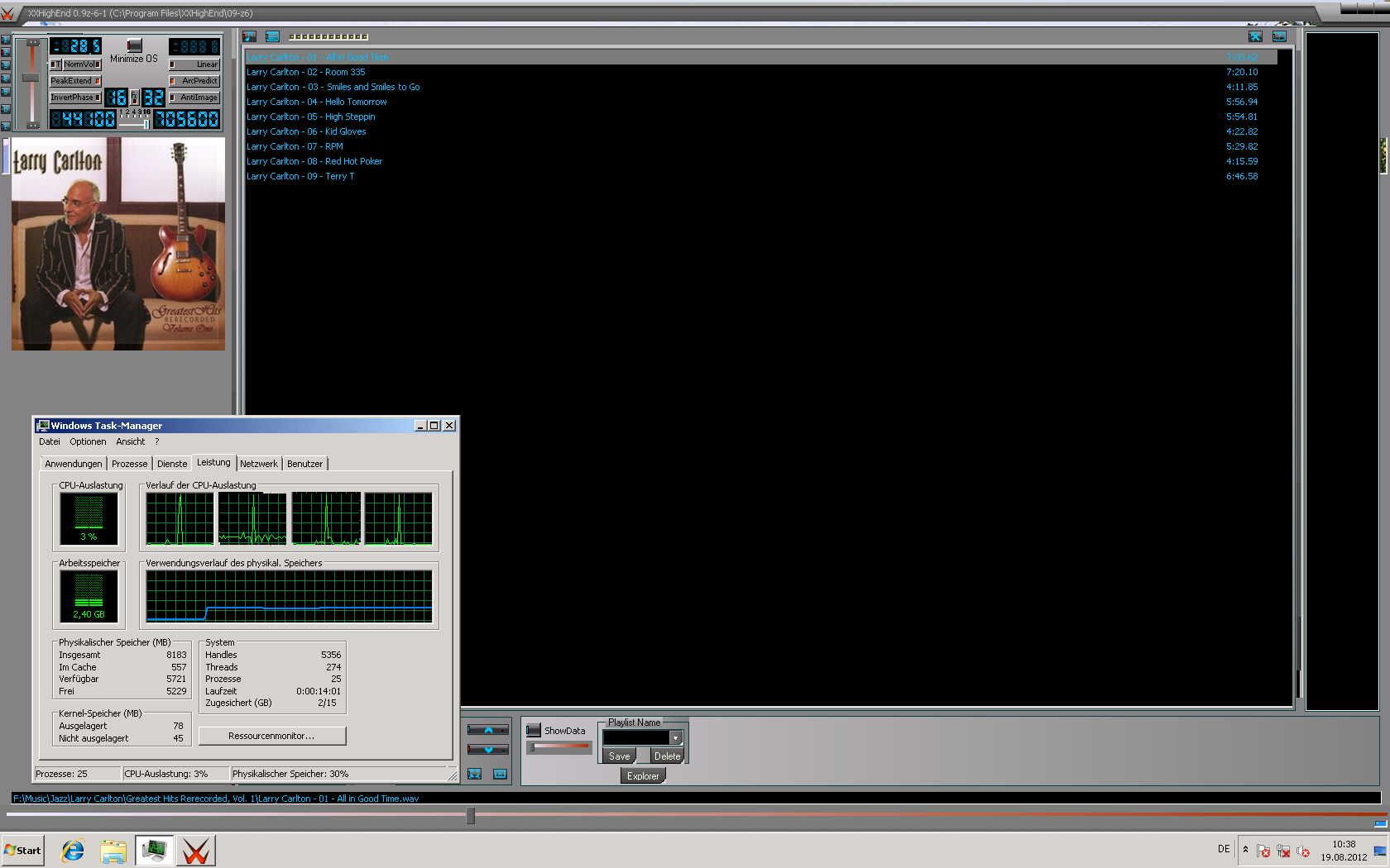

the activated XXH shows "lack of memory" and crashes two minutes later.
two pictures with the difference of the memory involved of 09.z-6 and 0.9z-7.
Same song.
« Reply #1 on: August 19, 2012, 11:48:46 am »
Hi Joachim,
You do know that you have set different settings (6 vs 7) in there, right ? So, apples and oranges to begin with.
This doesn't prohibit that possibly something is wrong.
Do you have Garbage Collection On or Off for z7 ?
And how is that setting in z6 ?
« Reply #2 on: August 19, 2012, 03:43:56 pm »
same settings as 0.9z-6 now.
Until now smoothless operation
