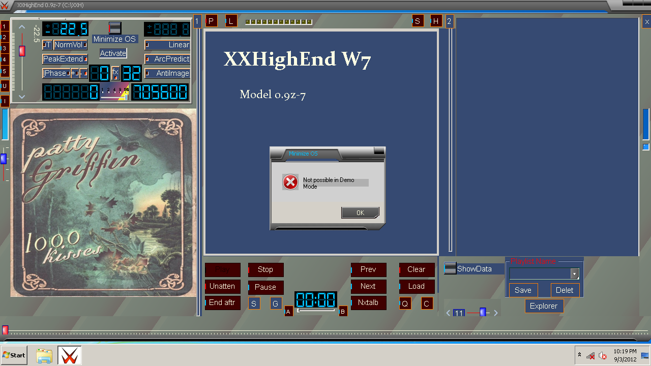

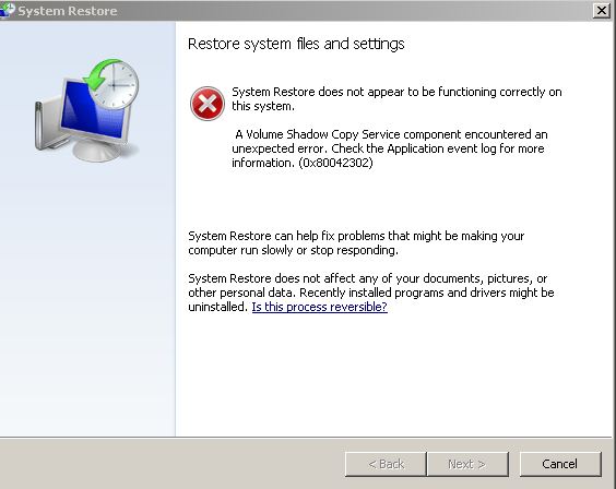

After new OS install (didn't wipe out data, just reinstalled OS) I have a very strange circumstance: after getting a new activation code and activating and minimizing the OS with 9Z7, I felt successful, turned off the computer and took a break. When I turned it back on, the OS was properly minimized (red/white "x" on speaker icon in lower right taskbar); however XX was no longer activated--it reverted to demo mode! I then tried to click on the red highlighted "minimize OS" button and got the "not possible in Demo Mode" message. So, though the sound is fantastic, I am unable to get back to the full OS. Additionally, I get an error when I try to get into the restore program. See pics below for details:

Nope, that Volume Shadow Copy feature won't be running when in Minimized OS Mode. Nice eh ?
But question : is this about a Restore Point, or is it about more than that ??

Was afraid you might say that. For clarification, when I first tried 9z7-2, I had not minimised the OS with 9Z7. Because I got the 9Z7-2 "14" error message, I tried 9Z7 and it "worked" and then deactivated leaving the OS minimised.....
So this morning I tried to do a restore to see if I could get back to the full OS and got the "shadow copy' error.

Took Stephan's advice, fiddled with reactivating and got it activated in mimimised mode. Immediately "Unmimimized" and it worked. Now it is staying activated and all is well! One great thing is that reinstalling the OS has solved 90% of the clicks and all plops have disappeared with PA.
