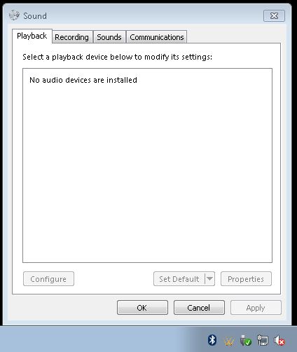

WASAPI works absolutely perfectly if the PC is booted in 'normal OS' and is accessed locally, i.e. monitor and keyboard/mouse connected directly to PC.
WASAPI does not work if the PC is accessed via bluetooth RDC. (It may well work via LAN RDC, but I haven't tested this yet.)
The two screenshots below were taken via the two diffferent access means. Absolutely no other parameters in W7 were changed.
Thanks again Alain.

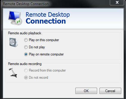

« Reply #17 on: October 02, 2012, 01:09:06 pm »
Cracked and solved!
In your RDC connection, you have to select 'Play on Remote Computer'. This solves the problem.
All credit to Alain.

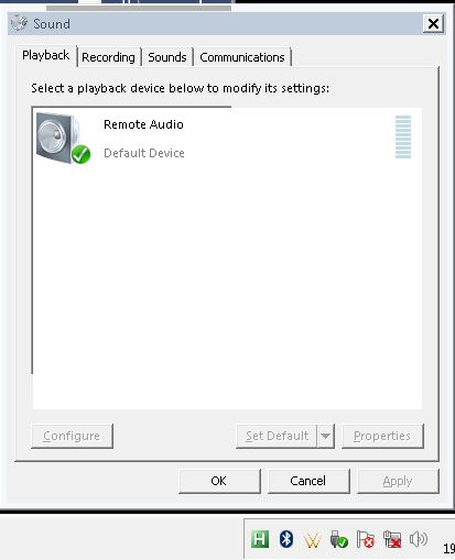

No, we will see the below picture which shows on the audio PC (and what we see at the laptop). It is Mani's own picture. Ah, no red cross, because despite nothing is actually there, that remote audio device is there. But, what is it ? What is it played through ? I can imagine the laptops loudspeakers only and through the onboard (mobo) D/A. But maybe if you click that entry things can be configured differently (see the "default device" underneath it).

I am glad I could point in the right direction ... And that you were able to select the right option. I should have written "third" instead of "first". My bad unhappy
