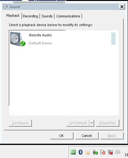

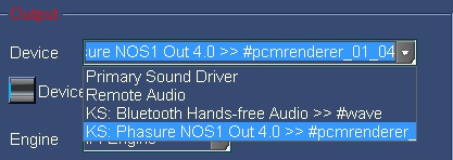

« Reply #3 on: September 19, 2012, 03:27:40 pm »
Right, WASAPI services work in Minimize OS mode no problem. But neither W7 nor HQPlayer recognize the NOS1 as a WASAPI device. XX recognizes the NOS1 OK, but only as a KS device, not a WASAPI device.
Am I being really thick somewhere?

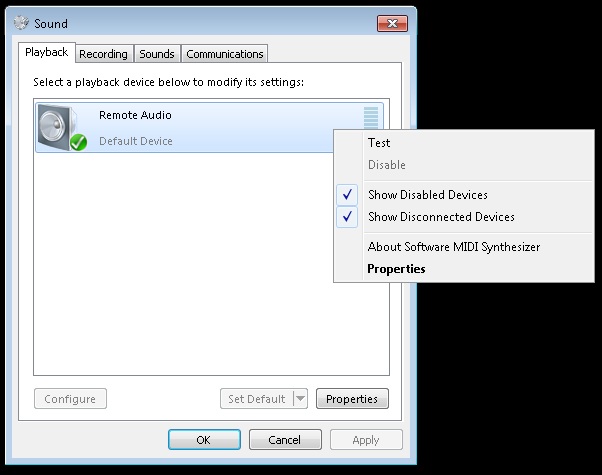

« Reply #4 on: September 19, 2012, 04:15:40 pm »
Theoretically you can have disabled it while "Show disabled devices" (similar) is not ticked ...
« Reply #5 on: September 19, 2012, 05:27:08 pm »
Sorry Peter, where is 'Show disabled devices'?
« Reply #6 on: September 19, 2012, 05:56:12 pm »
Yea, a bit strange if you don't know;
Rightclick on one of the devices and then the menu is there.
Btw, I now wonder what happens when all are disabled and this option is not On. Then there is no device to select ...

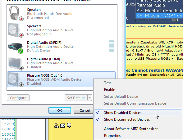

« Reply #7 on: September 19, 2012, 06:24:01 pm »
OK thanks.
But it still doesn't find the NOS1. I think I may have set something in the BIOS that is stopping audio devices being detected. I'll explore when I have more time.

« Reply #9 on: September 19, 2012, 06:45:45 pm »
Well maybe this sheds some light on the situation. The audio devices are there, but are not being detected by WASAPI?

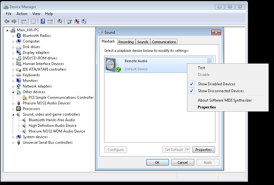

« Reply #11 on: October 01, 2012, 06:38:47 pm »
Hi Peter, just tried your suggestion and unfortunately it doesn't work.
I still can't see the NOS1 as a WASAPI device either in W7's 'Manage Audio Devices' or in HQPlayer. But it's listed in W7's Device Manager as a WDM audio device.
Strange uh? Any more ideas?
