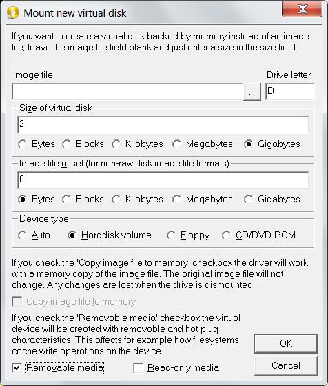

« Reply #4 on: February 15, 2013, 01:02:27 pm »
Here is how I define a virtual disk with Imdisk...
In this case, I want to create a 2GB virtual drive. I define it as a harddisk volume. The drive letter will be "D:", provided that it is available, otherwise I can specify another letter.
In the lower left end of the window, you can see that I checked "Removable Media", as it allows it to be formatted like a USB key, so I can use the ExFat type of formatting...
I haven't experienced the behavior you describe, but it does not mean that you are doing something wrong... I use this with W7 and W8 and all seems to work fine up to now...

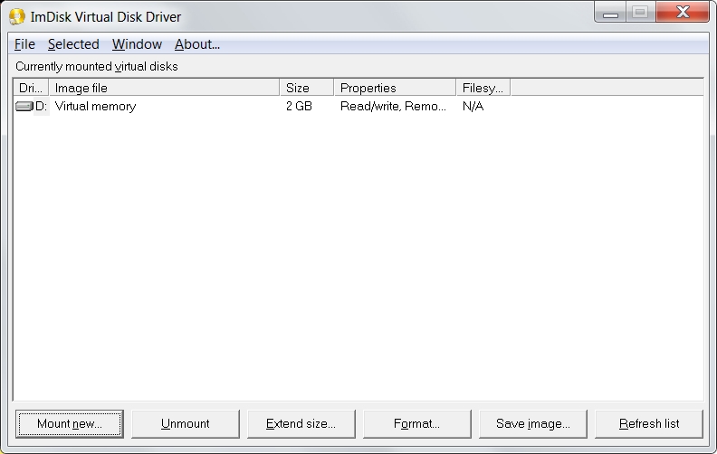

« Reply #5 on: February 15, 2013, 01:09:30 pm »
This is how it appears after I am done (press "OK")...

No, I didn't write anything in the image field but I left auto ticked and I didn't tick removable so I'll try your settings.
Thank you!
