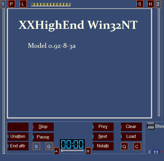

I am just wondering if this possible issue is by design or not? With 0.9z-8-3a, if I select the "Stop ALL Services" option, I receive a message telling me that this can only be applied to Windows 7. I am, however, running Windows 7, but only windows 7 Starter 32 bit (I will probably be getting a new laptop before year end, but for the next little while I will be stuck on Windows 7 Starter).
So I was just wondering is Windows 7 Start not considered to be Windows 7 in terms of this particular option, or is XXHighEnd not recognising Windows 7 Starter correctly?

If you have a spare minute, can you make a screenshot of the empty Playlist Area (where the XXHighEnd version shows) ?

Here you go. btw, I have not yet activated this version yet since I was wanting to know if this was actually something fixable or not. In the case where it can be fixed, I thought it better to wait and activate the "fixed" version.

But odd, like in my own case your OS is reported to be Win32NT;
Do you recognize that it "started to say" this at some stage ? (like it happened to myself)
For me I solved it with the Windows (version) build number, like 6.1.7600. What is yours (please be precise with the dots and such, so I can check for that) ? You can find this under :
Start button - All Programs - Accessories - System Tools - System Information - the second line in there.
Notice that in my case it nicely shows "Microsoft Windows Ultimate N" on the first line, so I guess I can get it from the Registry somewhere anyway. Until I decide, please mention your first line as well (behind OS Name) and here too, as precise as possible.

It's OK - I have figured out what the problem is. I have the Windows Management Instrumentation service disabled. Without that service running, it isn't possible for the OS to provide the required information.
As soon as I re-enabled the service, XXhighEnd showed it as Windows 7 again and I was able to select the Stop ALL Services option.

Just with some further testing today, all that seems necessary is to have the Windows Management Instrumentation service enabled when the Stop ALL Services option is checked within XXHighEnd. After that, the service can be disabled without any problems, since XXhighEnd won't perform any further validity checks. So all is good.

Thanks for your further analysis, and although there will be some truth it in, it is hard to imagine it is the whole story. I mean, that service doesn't run anyway in MinOS BUT I take care that when it needs to run it does. So two things :
1. Nobody complaints (and thus your story of shutting it off must be correct for your situation);
2. With me it sure runs (because I make it that) and it doesn't help for me.
But if we take into account Maxi's story, anything can have happened here.
Summarized for your situation : just let it run and once in MinOS all will be taken care of. Notice that this is so when Unattened Playback is going on. Not outside of that (read : not when playback not is going on).
Addendum :
Maybe it is no coincidence that in my situation the Win32NT thing started to appear when I was playing around with the latest Stop ALL Services feature. But it must have fixed something somewhere and I can't find where (like Registry).
Is there a specific reason why you can't get the OS version information from reading the registry rather than relying on the Windows Management Instrumentation service?
No. But it just wasn't needed before so I used the property concerned for it. Today now I know ? ... well, the only problem is that I don't know what can be in the Registry for literal text to check for. Possibly it is 100% the same as that property should tell, but I don't know. And quite some Windows versions exist (don't count out the Server versions). So when not careful nothing works anymore or worse : it works with errors because when the wrong OS version is seen, quite many things will work wrongly (this is not supported here, that is not supported there - you will get the idea).

Yes, well I purposely kept toggling that service on and off on both my netbook and main PC yesterday and the title in the XXHighEnd playlist window dutifully changed between Win NT 32 bit and Win 7 depending on whether the service was on or off, so obviously at least in my case it is clear cut as you say.
