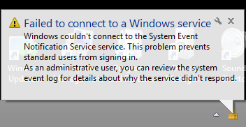

Ok ,
did try the W7 shell , and the thing still behave the same , giving the error reported in the picture below .
This error remains also at the next login unless a reboot is applied .
stefano

« Reply #10 on: May 27, 2013, 05:04:59 pm »
Outside the general problem : I am almost sure that this error message only pops up when the W8 normal Shell is active.
IOW : You must not only install the W7 Shell, but also activate it (switch to it) ...
