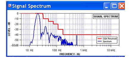

I found this though : http://www.audioholics.com/loudspeaker-design/2010-subwoofer-shootout/2010-subwoofer-shootout and the main picture in there is this one :
The red line indicates an official "spec" to what subwoofers are allowed to exhibit for harmonic distortion.
Although this is about subwoofers and not really woofers as such, for me it is the thing to deal with, because aren't we talking about subwoofers ?
So, if you look at the test signal there and see it is 20Hz, the red line tells that the first harmonic (40Hz) is allowed to be at not more than -10dB. If more, then the subwoofer is no good.
N.b.: I ran into ABX tests where similarly was examined in a group of people, and the results were that nobody could hear a difference in those lower registers anyway.
In advance of how this post will end : go figure.
Anyway, a subwoofer manufacturer should produce his product in compliance to this graph, and when it does it can "officially" go out. Of course, many do better, but this is about my quest to how actually others are performing, while I scream about a couple of things and whether that is justified (audible I say Yes, but what about some figures and what will they mean to you, you too not really knowing what would be normal and what would be in excess (either direction)).
So what a speaker driver is about (amonst other things) is that it should not produce too much HD (harmonic distortion) and we know that when excursion gets higher HD will increase. Also : when the SPL to be produced gets higher, excursion will be more. And : When the frequency to produce gets lower for the same to be produced SPL, excursion gets higher. So all is related especially when we try to achieve the lowest frequencies at workable SPLs for our music.

When we talk subwoofers, we talk by sort of principle of frequencies we can not hear. Of course, a subwoofer can go higher (at will of the manufacture and which for sure is the case with our Orelino here), but a subwoofer is no subwoofer when it can't produce, say, 22Hz at reasonable SPL and which 22Hz is inaudible to most (to me it is inaudible). But, way beyond that just the same, like my former SVS Subwoofers who do 12Hz (I forgot at how many "dB down" but alas).
So, when producing inaudible frequencies this emerges as air pressure changes we will perceive and it gives additional layers of whatever we are listening to.
How shocking it was for me when I found that in general (frequency point) no less than 22dB down the 2nd harmonic has to be in order to let the fundamental do its inaudible job ... So, no single way that picture above resembles anything that can be good for music. Effects maybe, but no wind effects. So what happens ?
(it is too easy to even think about once you know how it works)
Suppose we have 30Hz. Sounds nice. Then at the same SPL we create a 25Hz. Hey, it sounds higher in frequency ? Hmm ...
To understand better we go more down : We have 20Hz and it should be silent. Why ? well, we can't hear it as such. Not silent ? ah, then you hear the 2nd harmonic which is 40Hz. Easliy audible ! And so with that 25Hz sounding higher than 30Hz, what we'll perceive is HD and it plays at 50Hz.
Now let me tell you, when I'd sustain that red line in the picture and wich actually tells that any 2nd harmonic is allowed to be 10dB down before we'd perceive it as distortion ... NO WAY. When I would allow for 10% HD on that 20Hz tone, a most blasting 40Hz would be audible.
And again, it is so easy : When some frequency (like 20Hz) is not to produce any sound, how high in level would we think it's 2nd harmonic (like at the very audible 40Hz) is allowed to be ? Hey, that's actually nothing man !

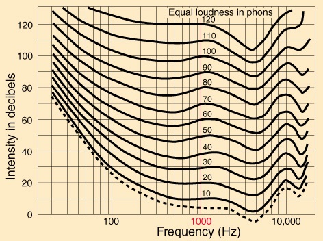

Just to support the long post about audibility of the extreme LF (sub) I post the famous Fletcher Munson "equal loudness" curves. The slope to the start of the curves (starting at 20 Hz) is very steep down , that means you can have only very little distortion before it appears above the audibility threshold. So a 89dB sound pressure 20 Hz tone will produce a second harmonic of 40 Hz that will be audible at a level of about 50 dB pressure. That is about 1% (-39dB) max for the second, but the third and fouth are even more important (38 or 30db threshold or less than 0.1%). The audibility of these is speculative though since they could well be masked by noise or music.
The classic way to reduce distortion is to reduce the motion of the bassdrivers (or linearise them by motion feedback). Usually this means more woofer surface and/or horn loading which has a practical limit of 35 hz is a domestic environment.
Anyway it is great to learn about the Bass of the Orelinos which does something special to the listening experience even with the distortions in place.
Please keep posting your progress!

« Reply #44 on: October 14, 2013, 11:08:08 am »
Well Coen, I really start to wonder whether there is anything you don't know (about) - all seen through my own glasses of course, which can be mistified at times. Just saying. innocent
Btw, I think that picture is not the official Fletcher Munson curves but rather the AES 2003 whatever representative. See here for the original F-M curves.
Still you don't know everything and amongst that is that the Orelino plays through curves which represent the F-M curves. well, almost, see text more below.
What you and everybody especially don't know is that my whole raving about this speaker's bass is all about the contradiction when these curves are taken as a lead. So, all you see me writing has as underlaying subject these curves, which are not correct for the bass at all. In other words, I feel supported by this "strange" contradiction because I am achieving things which are not recognized in the world so to speak and therefore "I am into something for sure". Again, through my own glasses. Ok, ears.
First this one :
Nah, not quite. This one is simpler and I told about it in that larger post : 20Hz is just not audible. This is not related to any F-M curves etc., it just is not audible because our auditory system will not produce interpretable sound as such. It's wind. Also notice above F-M curves, which do not show 20Hz at all (starts at ~25Hz). In your picture it starts at 20Hz, but that doesn't make sense to begin with.
(Side note : who am I to say this ? well, read on.)
Anyway, when a frequency is not audible officially (23Hz and under for me), *any* harmonic distortion popping up at *any* level which makes it audible is too much. So, say that you can perceive a 40Hz at 70dB under your normal listening levels, then the 2nd harmonic of 20Hz will be audible when at 70dB down. So, not 20dB, not 40, not 50, just anything which makes it audible. For the inaudible fundamentals this is the most easy to check, and for the audible ones this is more difficult. But in general : when you go down step by step and suddenly the next step sounds as high or higher, you will notice the distortion by that means. This is also profound over the distortion in the fundamental. So, easy.
This is very different from putting up even 25Hz where you are to judge whether this distorts. So with a good absolute hearing you might be able to, but with less good you may not recognize that the net pitch got somewhat higher because it is mixed with 50Hz. And then to think that 25Hz is a most easy example actually, because already so less audible. But with 70Hz ? Good luck. Still though, when going from 72 to 71, to 70 it is the most easy to hear when 70 sounds suddenly higher than 71. Thus, do it like that - easy.
Although there is some sense in relating the F-M curves to harmonic distortion (HD) I don't think it is a real lead for this. But *if* there's a lead or base for how we can perceive HD it is about this (look at my picture now and just take the bottom curve for example) :
When we are to perceive 110Hz at a certain level, we will perceive 1000Hz an 11dB louder. Or, when we want to perceive 90Hz at a certain level, 1000Hz will sound 20dB louder to us.
(look for the more realistic comparison at e.g. the 80dB curve)
So all this says really is that once we want to perceive that 90Hz in well fashion, we must be careful about its 10th harmonic because at whatever level that comes forward, we perceive it 20dB louder than any FFT shows us.
But really, I only tried to reason out something which is no subject at all. It is maybe, but it is completely overwhelmed by other findings.
So, what actually happened here while "tuning" this speaker ?
Look at the 70dB curve;
Just by listening and after being satisfied, to my surprise I found that I am following this curve exactly. Mind the 70dB which is listening levels though on the low side. But anyway this is the best representative for the curves I created - so just to give the idea.
Especially because I wasn't aware of these F-M curves (although I had seen them ever back), I was shocked to find this prefect match. In other words, this could not be a coincidence.
Because this can not be a coincidence, everything *not* matching those curves should be explainable, right ?
And this is how I actually started the whole "bass" subject, because the low end of the curves do not match AT ALL. In other words, when you see me writing about super bass, up into the near inaudible levels (because of frequency we can't interpret anymore, for me 23Hz !), there is no single way these F-M curves represent what I perceive from this speaker.
When I was to tune the lot under 1000Hz like you see in the curves (those 2003 curves even far worse) then windows would go out because of bass alone. So, looking at that 70dB curve and assumed I would be playing at 70dPSPL, then 30Hz would come out something like 17-18dB more. So, music above 1000Hz plays at 70dB and when there's 30Hz it plays at a sheer 88dB. True, this is what our SPL meters would say  but this is also totally audible and I would die of too much bass.
It may be complicated to follow, but with measurement it would come down literally to tuning all for SPL levels, and that 30Hz should output 18dB more than 1000Hz and when so we would perceive the both equally. That's what the F-M curves say, and that is what they are for (but also investigate the Phon unit (mentioned in Coen's picture) which does about the same).
So completely contrary to the F-M curves (let alone the 2003 version) my curves are just completely straight; they are straight from 600 Hz downwards. And then STILL I report "concert level bass". And, of course, any measurement shows equally loud levels from horn (up from 280Hz) and woofers. But also, my former speaker did that too. And no concert level bass at all.
So you see ? this is how I end up raving with a "what is actually going on ?!" and this is how I try to explain that through the various posts. But this is also how I try to squeeze out similar from you all, where a perceived equally good 15"er (could be my previous, could be Juan's) - rated to 27Hz flat at least for my own former and measured by myself - does not make a 32Hz organ pipe come through. Even not at all when supported by "official" subwoofers.
So I could go through all that reasoning again, but I already did that (tried at least), because indeed *something* has to be going on really.
These F-M curves, but maybe more that 2003 version which is worse, should depict official science. Well, am I not always going against that, and would it not be the first time that empirical finding learns a few things (after being ignorant about any so-called science in the first place) to next meeting the necessity to come up with some explanations. Say that is me myself and I.
So I tried to find out under what conditions both the F-M curves and the 2003 version where derived, and all I can say is that the F-M curves emerged through headphones which seems to be for the better (as claimed) while the 2003 ... I am not sure. The only difference I really see is that this is all through a mere special open baffle setup which can better be named "horn" and that both designs will at least contribute to less harmonic distortion at a. the higher SPL and b. for the lower frequencies (see yesterday's post).
In the mean time I (thus) have been working on proving whether it all could be about distortion after all, and this is not the case.
All I can say at this moment, is that when we would try to derive those curves from my former speaker system, I probably would come to similar curves in the bass area. So, I guess I would sure be able to perceive those 32Hz pipes easily, if only first the bass would be pumped up by 10dB or whatever, but, which can not work because no speaker would allow for that without first heavily distort (even more). Otherwise I think no speaker designer will deliver his speakers with the bass pumped up by 10dB anyway (and I mean seen through SPL measurement) and thus we all *think* that the F-M curves apply.
But all what happened (in my view) is that they were obtained through means which are not today's best (loudspeaker) means. At least I see that this is so through the Orelino speaker and all I continuously try is to debunk my own findings. But so far I can not succeed.
Coen, what is this 35Hz based upon ?
