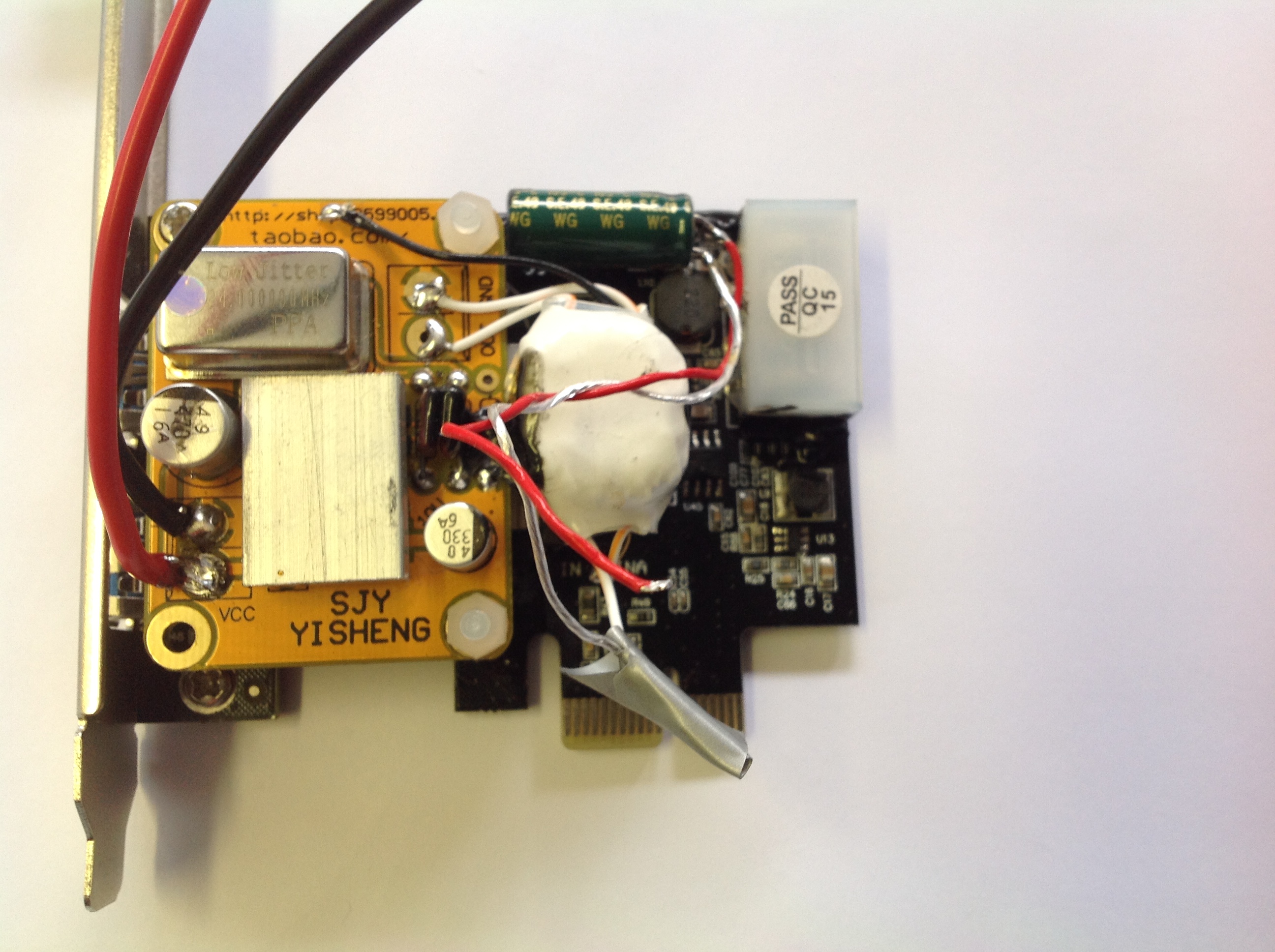

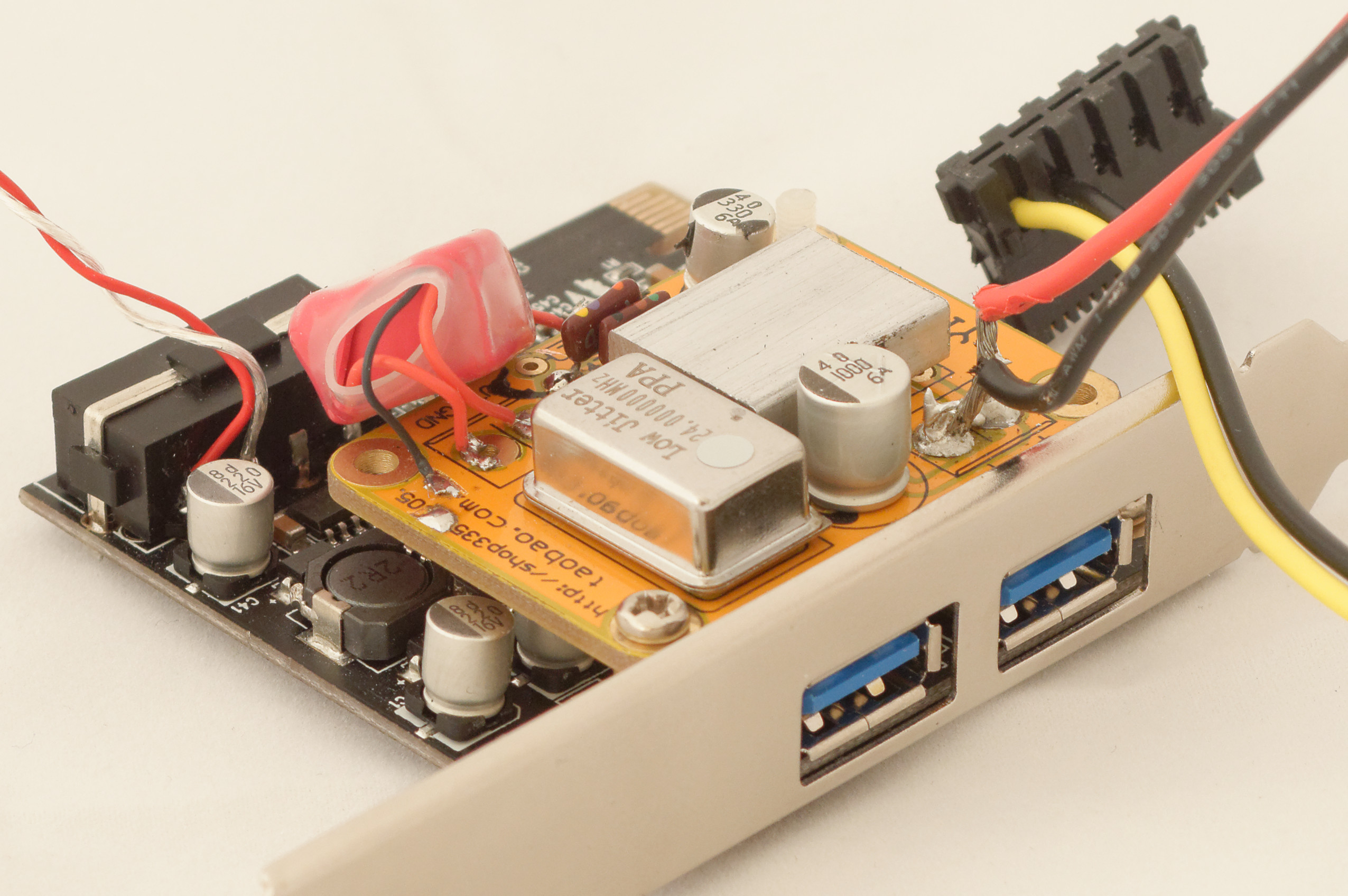

Coen, I encourage you to post some photos of the mods to your V2 card so that I might apply them here as well and see if I can corroborate your findings.
Here you are at the bottom of this post.
The ..75 picture shows that the x-former connection at the clock board is unaltered. The thick red en black wire come from the molex to sata adapter (the molex part has been ripped open to harvest the red +5v and black GND wire). The original PPA white/red power wires have been disconnected and are currently fed from the linear supply.
In the other picture ..76 you can see how I connected the x-former to the capacitor (horizontal on the aluminum block under the clock board with golden wires) and to the ground connected (outer) leg of C16.
It requires removal of the black synthetic and the x-former leg at the 330 (ohm resistor) position.
You can see that I am no craftsman and I warn you that it is tricky stuff to get the x-former connected to C16.
good luck!
regards, Coen
[I put in the smaller versions of the pictures as well because it could be more clear - Peter]

Hi Coen,
Thanks for those photos!  They really helped.  This week has seen the Silverstone USB card usurp the PPAcard as the preferred digital deliverer to the NOS1.  Spurred on by Coens experimentation I have taken the soldering iron to my V1 PPA card (Coens is V2) to see what would happen.
Firstly, I desoldered the power-in wires for the clock board (the red and silver twisted pair that run from the Molex to the clock board) and soldered in new wires to the clock board that will connect to a 5V supply (not via the molex plug).  I swapped the PPA card into the music pc did NOT connect the 5V molex, pressed play and....mweh...still not in the same league as the Silverstone...a colouration just as it was before.
Step 2.  I de-soldered the ground wire for the secondary? of the transformer from the clock board and, because the removed capacitor was inaccessible on my V1 card I connected it to the ground wire that originally ran from the molex plug to the clock board, but was now hanging free.  Again I put it in the music pc (without connecting anything to the molex plug) pressed play and...wait a minute...this is much better...on a par with the Silverstone, at least.
Well not quite.  I think that it is better than the Silverstone.  The resolution of the vocals, the cymbals, my-oh-my they are noticeably improved:  flesh, nuance, nice.  Coen, you are onto something here...very nice.
Of course I will do more listening over the coming days to make sure that I like what I hear, but it looks like the PPAcard is back in my good books.
See the photo below for my mods (following Coen of course).  Note the new (heavy) wires onto the yellow clock board and the silver wire from the molex plug connected to ground of the transformer.
[I put in the smaller version of the picture as well because it could be more clear - Peter]
