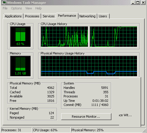

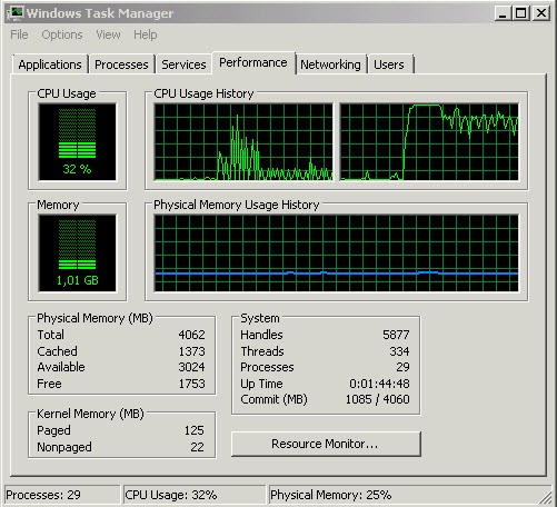

For this test I switched on "Not Switch (cores) during Playback" again to find out if i can make screenshots. Find included two CPU graphs in the attechments.
Screen 1 was with a lot of stuttering in the sound. After i set Q5=2 i had a stutterless sound. (screenshot 2)
When Q3,4,5 = 0,2,2 and "Not Switch (cores) during Playback" is on, Alt-X is functioning again in unattended playback mode without stuttering. A mouse-movement gives the screen back
