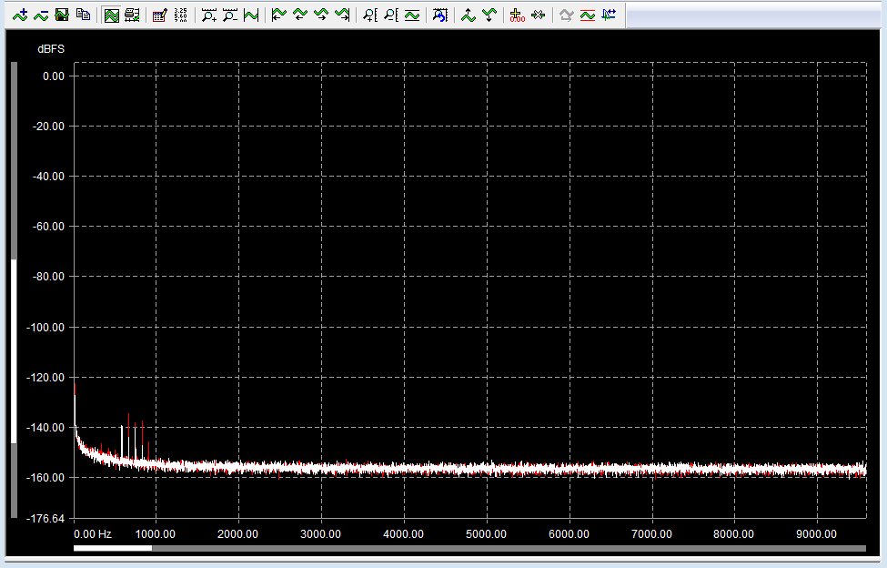

This topic will show some special measurements all taken from the outputs (1m XLR interlinks) of the Phasure NOS1 USB D/A converter.
A few rather important notices on how to read measurements (and/or how to apply them) with one clear emphasis : These measurements try to show the worst scenarions instead of the best (and with that fooling you). Proof of that : All measurements put up anywhere by us (this forum, others) where about 16 bit Redbook data. This is because we hunt for the best Redbook (CD) playback. This, however, does not show the best figures hence what the NOS1 is capable of while other manufacturers do (and fool you without clear notice). So, this topic shows that similar but still not to fool you.
Worst scenario's : For example show noise where noise really is instead of using a very deep FFT which would fool you where noise really is (because a deep FFT shows noise lower than where it really is. But also the other way around : When harmonic spuria are there we can often only show them by means of a deep FFT. So, now the noise floor drops and the spuria come forward. This is how the various plots show noise at a different level. This is why we will start with just showing the noise.
All measurements have been taken by means of just playing "tracks". No signal generators have been used, and what you see is as honest as can be because it is just playback through the same means otherwise used for playing music. The software used is our own XXHighEnd and 16x Arc Prediction upsampling/filtering is used unless noted otherwise.
Worst scenario again : The audio analyser is a DSCopeIII with 192KHz sampling rate (bit depth 24). This means that all what you see will be better in practice. For example, where THD+N figures will be better at 8x upsampling/filtering (D/A conversion operates at 352.8KHz) and better again at 16x (705.6Khz) the analyser will not be able to show better figures beyond 4x upsampling/filtering. So, 4x, 8x and 16x will all show the same, while 16x is actually way better than 4x.
Worst scenario once more : All the test signals are 44.1KHz (or 48KHz depending on the availability of test signal files (tracks)). This is done to closey resemble the Arc Prediction upsampling/filtering which now is *needed*. So for example, with 88.2/96KHz sampling the filtering would not be needed to show possible artifacts in the audio band. 44/1/48 will show those, if there (with the objective of nothing being there).

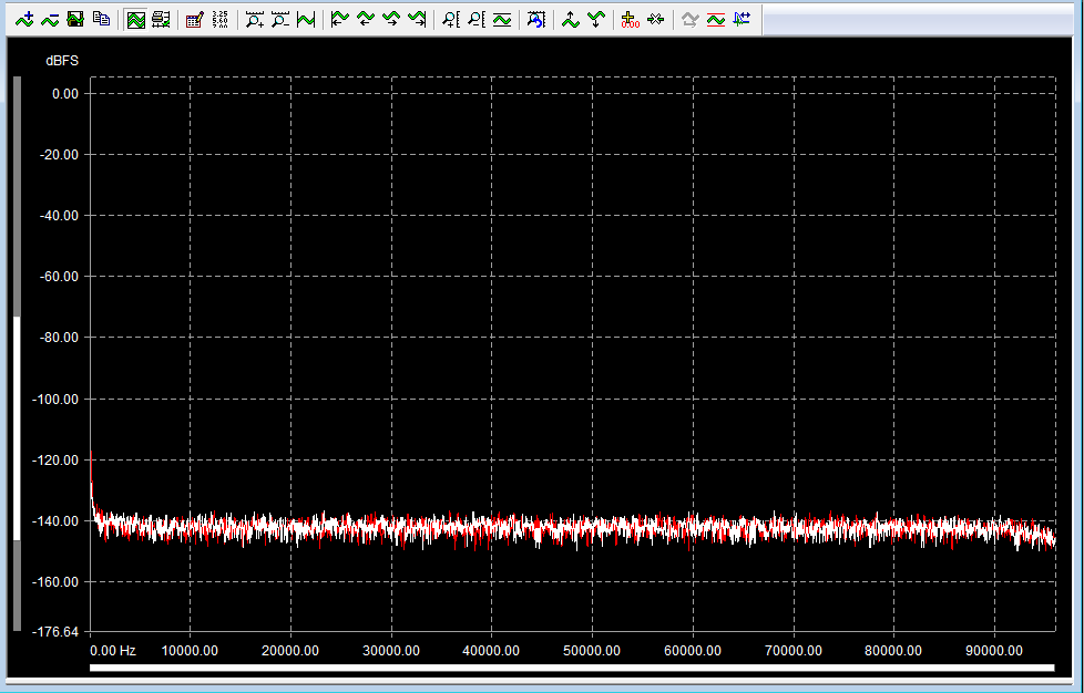

Lastly keep in mind that no spuria etc. can not be seen beyond 96KHz because again the analyser operates at 192KHz which allows analysis up to half of that (Nyquist limit). However, from what happens under 96KHz it can be extrapolated what happens beyond that (needs signal processing knowledge though).

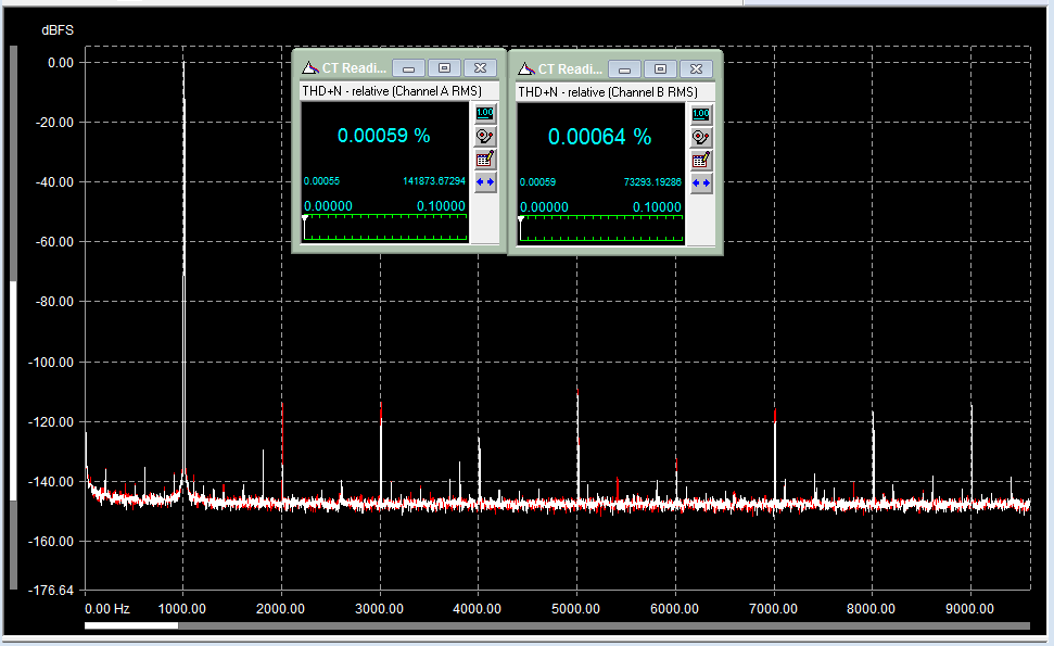

Noise Interpretation

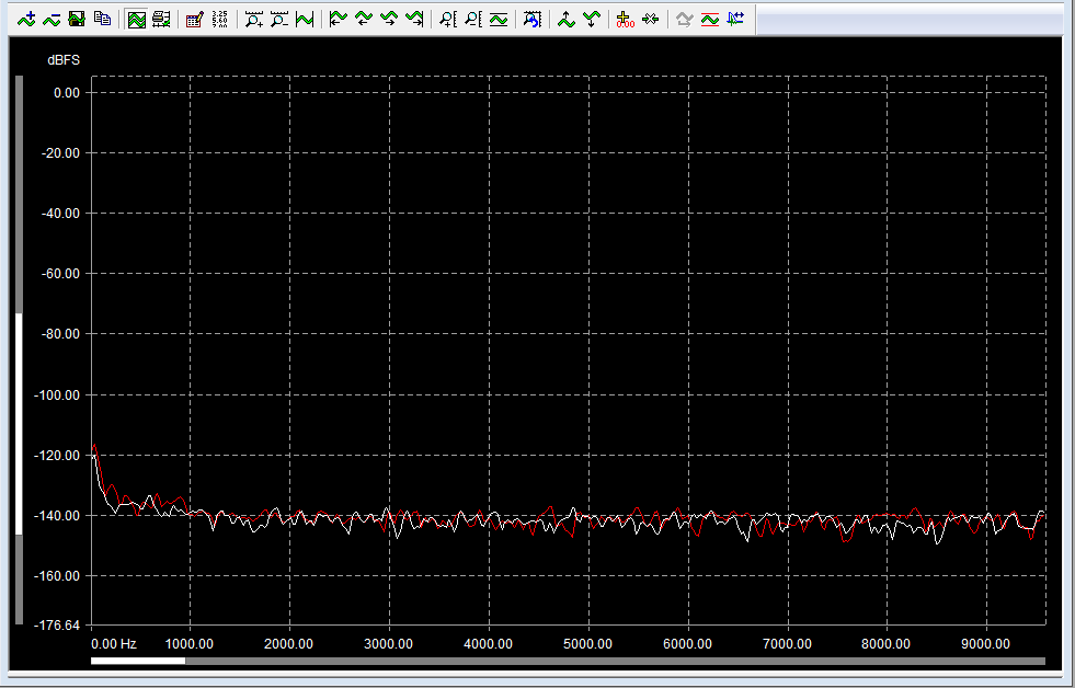

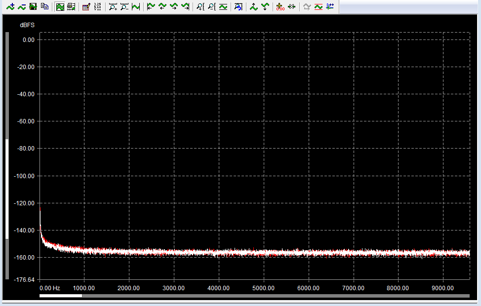

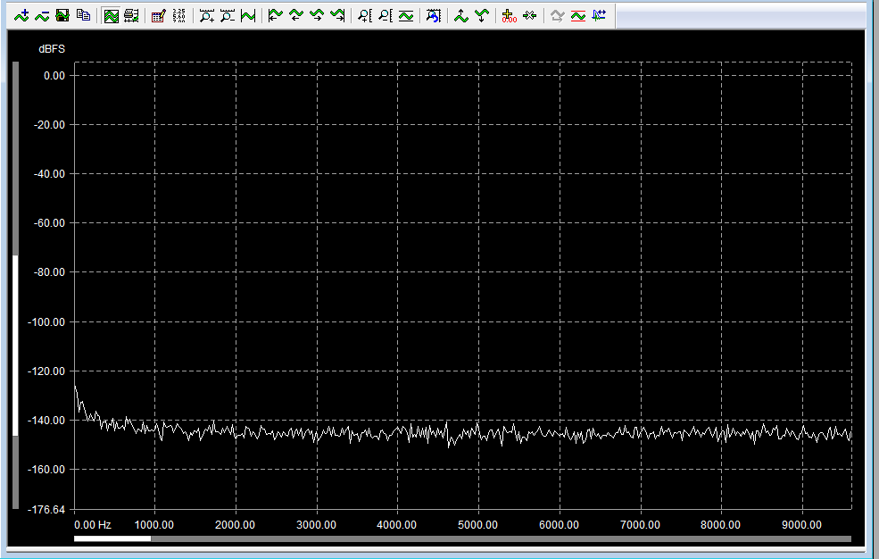

This can be regarded normal FFT settings. In this case this means an FFT depth of 8K and 4 times averaging.

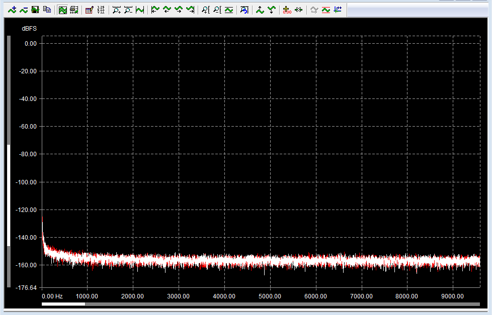

Now the FFT is 256K deep and you see the noise is lower. However, this is not for real now, and it is just math which does this. The reason ? dig out clear frequencies which normallty reside under the noise floor.

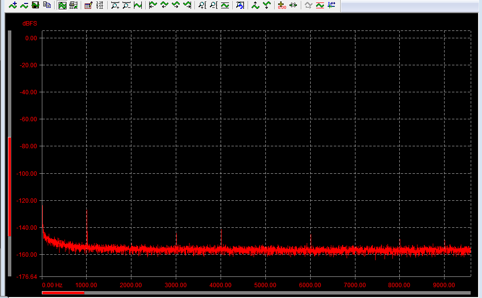

Now the FFT is 256K deep again but "averaging" is 16x (previous plots 4x). This means that spikey noise is averaged over more frequency bands and it looks better. But notice, this is not about looking better (though it sure is used for that) but again about detecting clear frequencies better.
As you can see here, just totally nothing is there.
Now let's look at the first plot again, but now with the 48KHz bas oscillator (previous set was 44.1KHz based) :
No difference to be seen eh ? Well, let's look again :
Aha ! So now the noise is perceivedbly very low (you are fooled) but we now suddenly can see an anomaly in the 48KHz clock arrangement.
Which of the plots fool more ?
So you see, the manufacturer should show what's really there. We just did so for the NOS1. The real fooling would happen when only the deepest FFT would have been shown as happened a few plots back, to next imply ultra low noise and no problem anywhere.
Always keep this in mind when looking at FFTs which may have been put up to explicitly fool you.

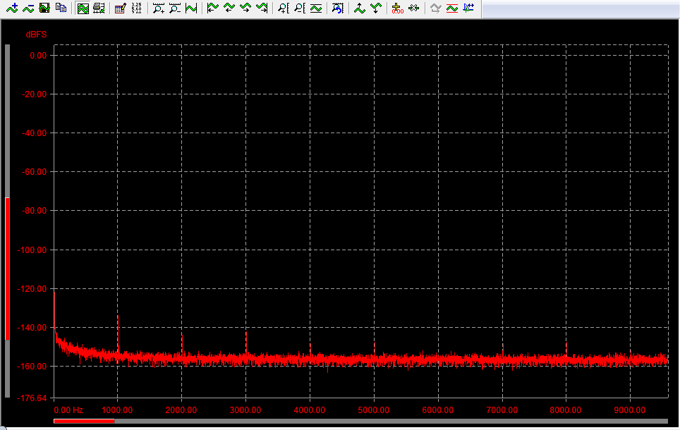

Below more plots can be for better interpretation what you actually look at for FFT depth (remember, the more depth the more "false" the noise level will show) :

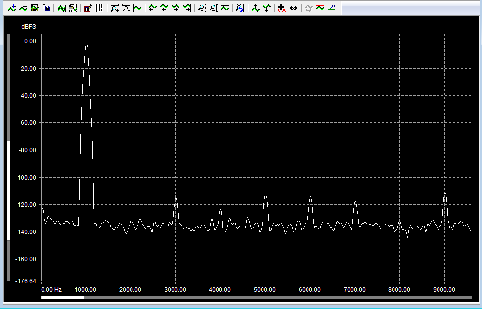

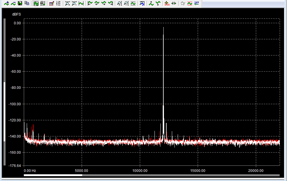

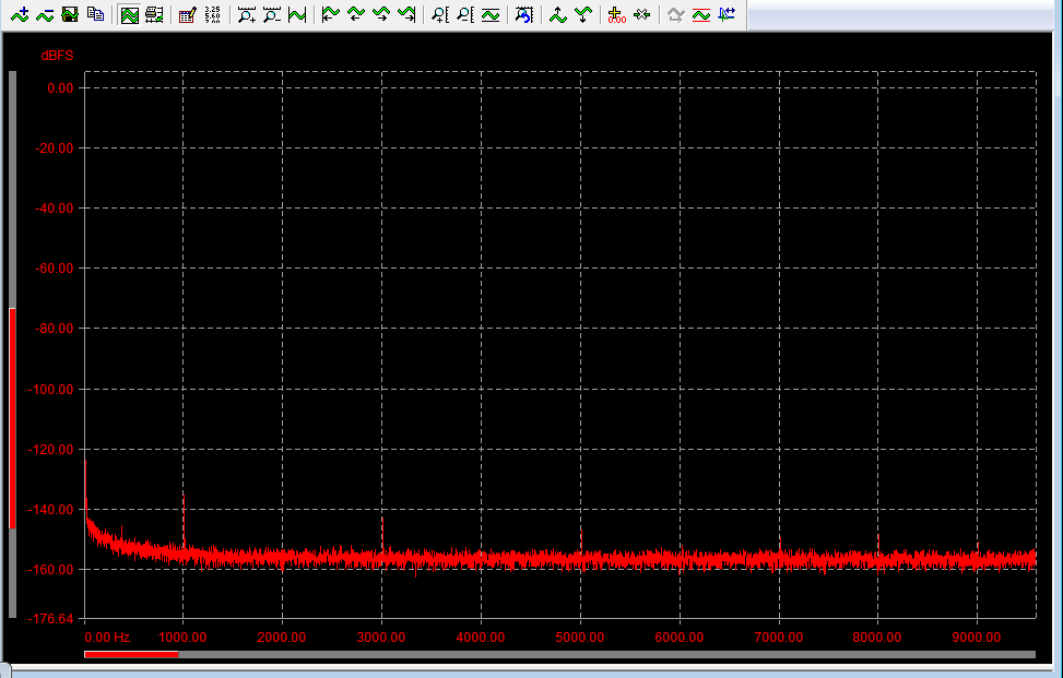

This shows a 1000Hz test signal. FFT depth and averaging shows reality. Notice the width of the signal.
Same FFT settings. However, where the previous plot showed a range from 0Hz up to 9600Hz, this one goes from 0Hz to 96000Hz. So, with the same screen size all is 10x more thin.
Btw notice that the largest peaks in there are spuria from the Arc Prediction filtering; they emerge at the base sampling rate (44.1KHz) and at plus and minus that 44.1Kz and the test signal's frequency (so, at 43100Hz and 45100Hz).

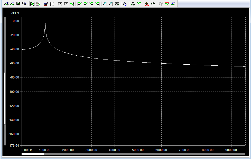

Now watch this one :
See the width of the signal ? Also very thin now. But what was done here was applying an FFT depth of 256K again (and 16x averaging). Aha.
So with carefully judging the frequency range squeezed into the picture (it is 9600Hz again just like two picture above), you can predict how deep the FFT is by looking at the width of the signal.
In the mean time the noise shows "too low", so don't dig that.

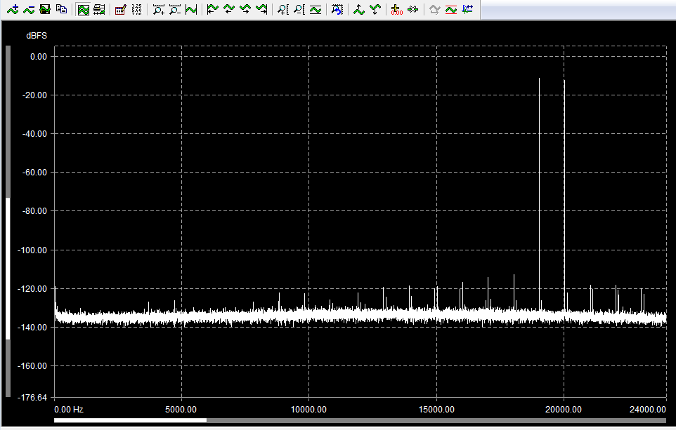

IMD 19KHz + 20KHz
The track used for this is from Stereophile TestCD2. This is 16bits.

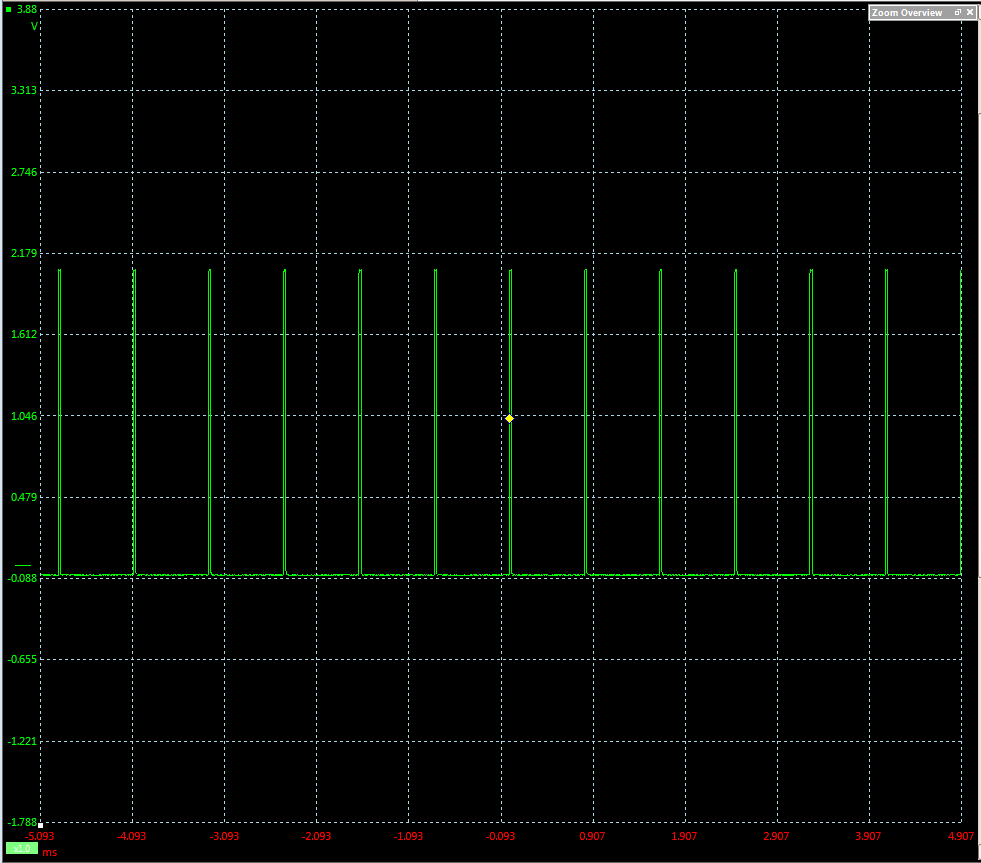

« Reply #1 on: February 03, 2014, 06:02:32 pm »
So here's a set of namiew measurements;
They partly emerged to learn a few things from again, partly for implicitly showing what the Phasure NOS1 is capable of, but maybe merely to refer to when it is in order (at random forums); Some things are hard to explain while pictures tell a 1000 words and with both it should be more easy for me to explain whenever needed.

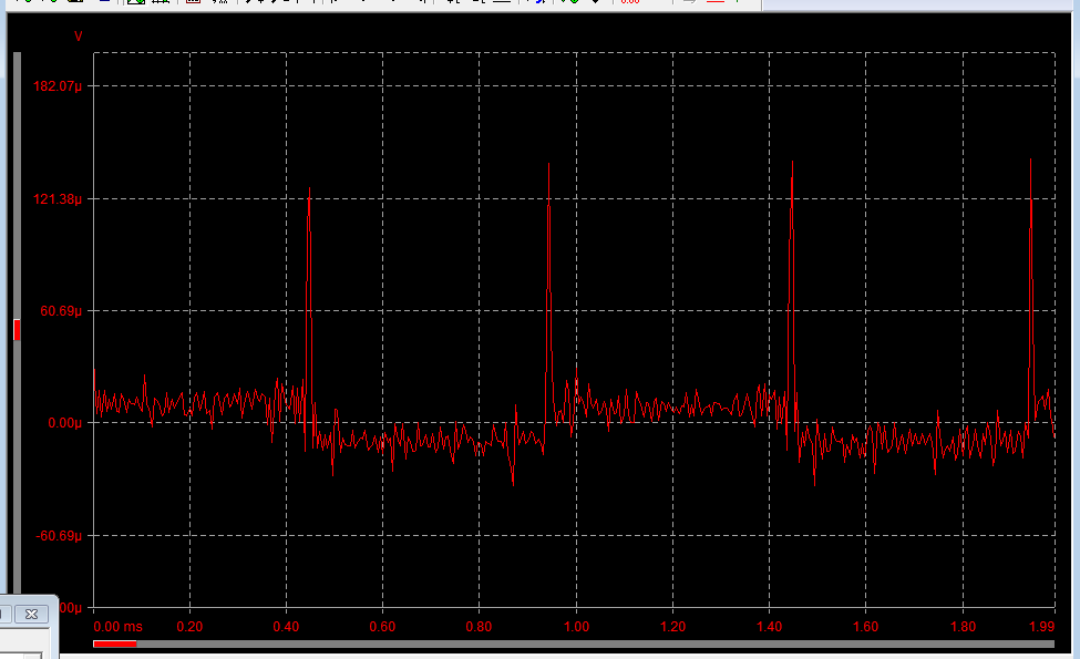

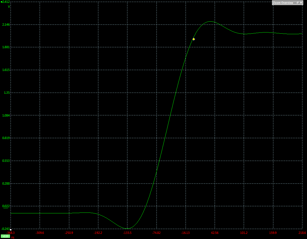

These measurements are about the impulse response of the NOS1 and we use Dirac pulses for it.
Dirac pulses : One shot samples which pose (only) positive Voltage in this case 2V. So, while Redbook is about 16/44.1 and thus 44100 samples exist in the (music) file per second, this is about 1 sample of it and it goes all the way up from 0V to 2V. It may represent a transient of one sample long (which will not exist in real music), but it will show how the electronics can follow (should follow) and we'lll make some comparisons with more common behaviour. You will see ...
All measurements were taken from the (left channel) output of the NOS1 at the end of 2m single ended (RCA) coax cable (the same used for playback here).

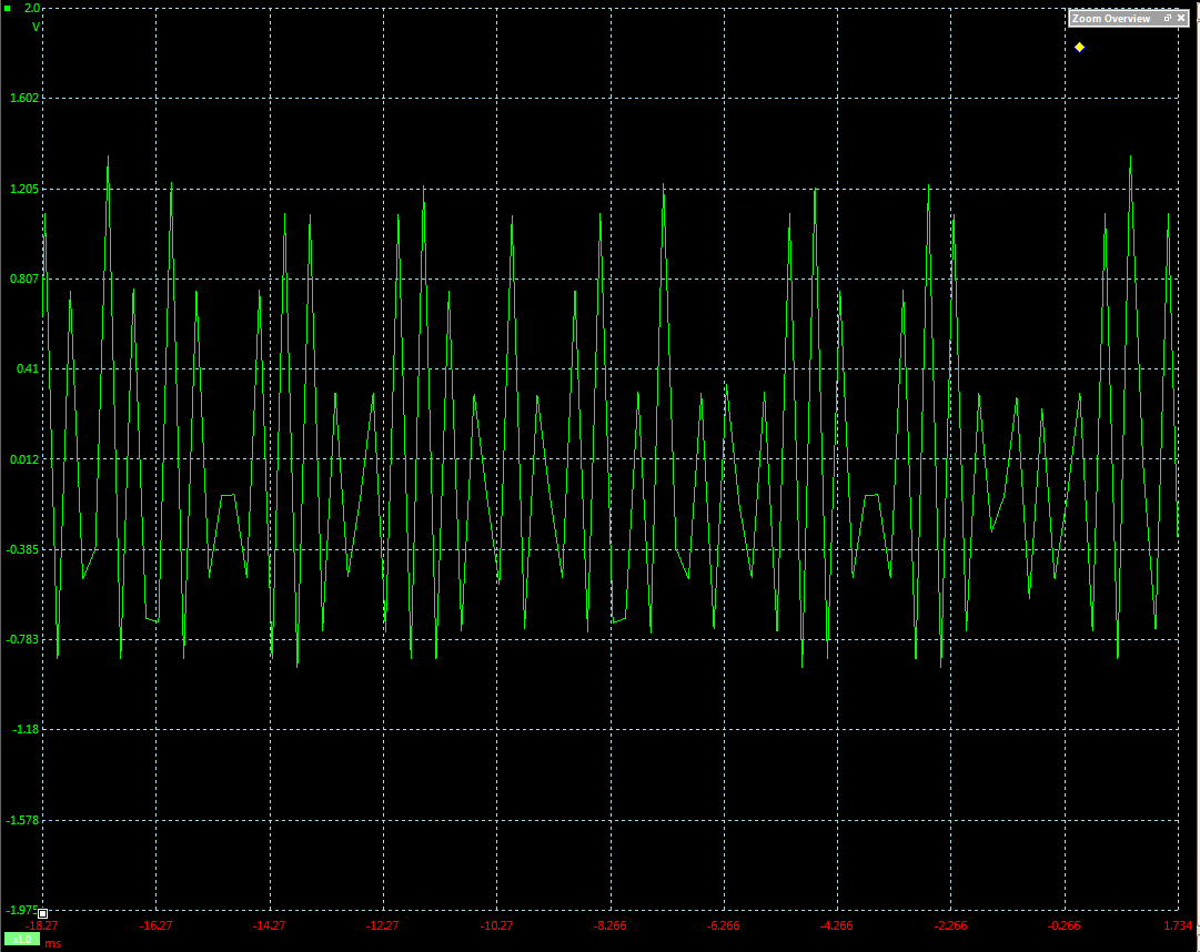

Here you see a way zoomed out picture of such a Dirac signal, and the 2V samples are spaced just under 1ms apart. Notice the horizontal (time) resolution which is 1ms.
The sampling rate of the analyser is 2Gs (2 giga samples per second).
Important to understand for later : This is a native 16/44.1 signal which has not been upsampled. This is how the one-sample spikes remain that. We'll understand this better later.

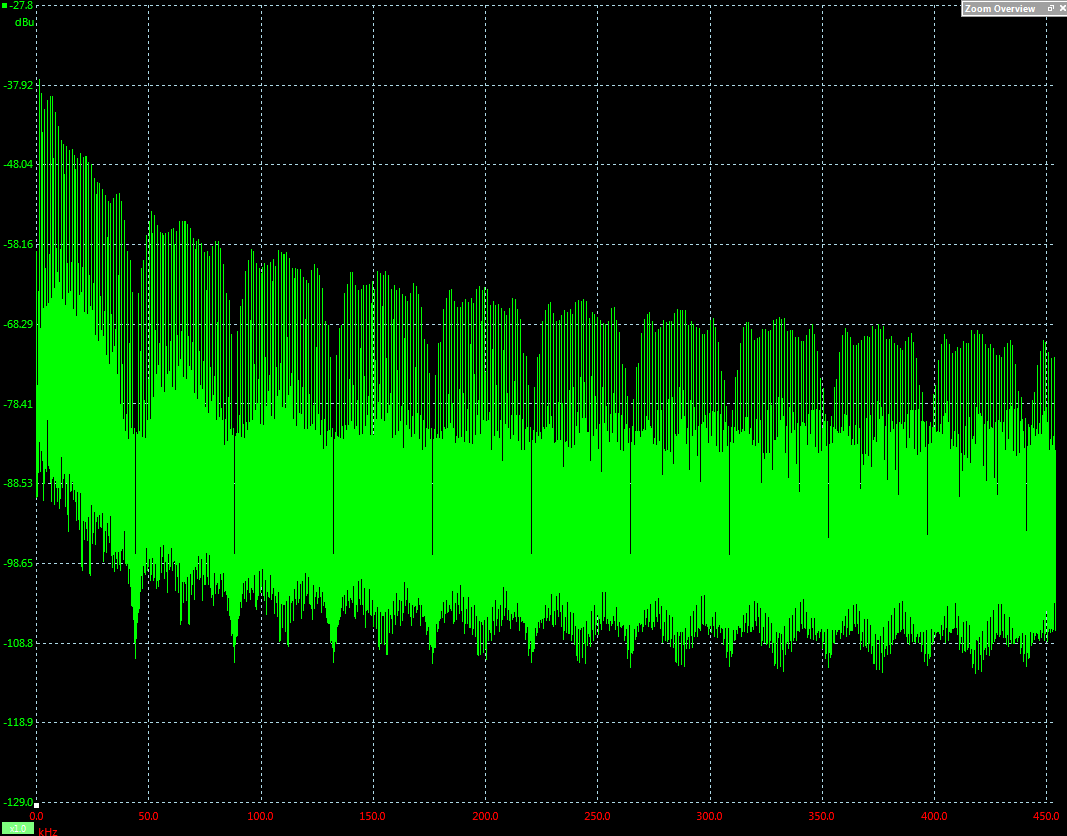

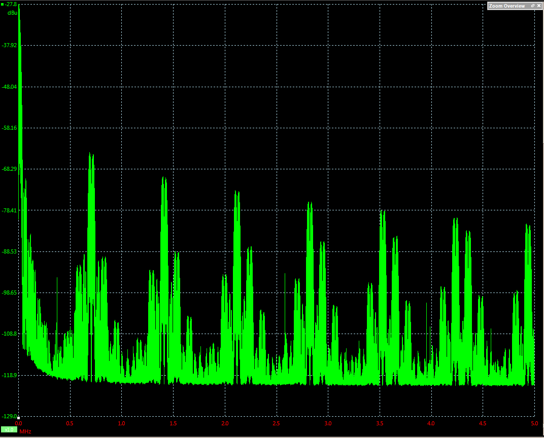

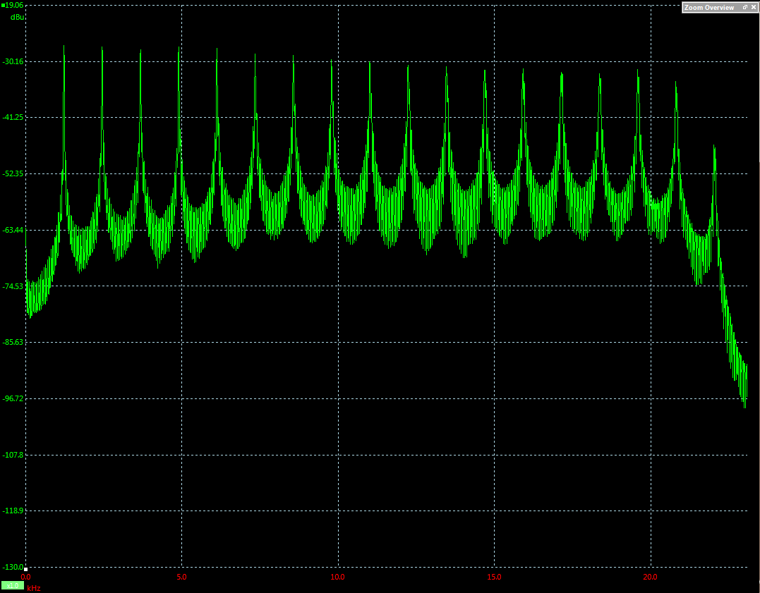

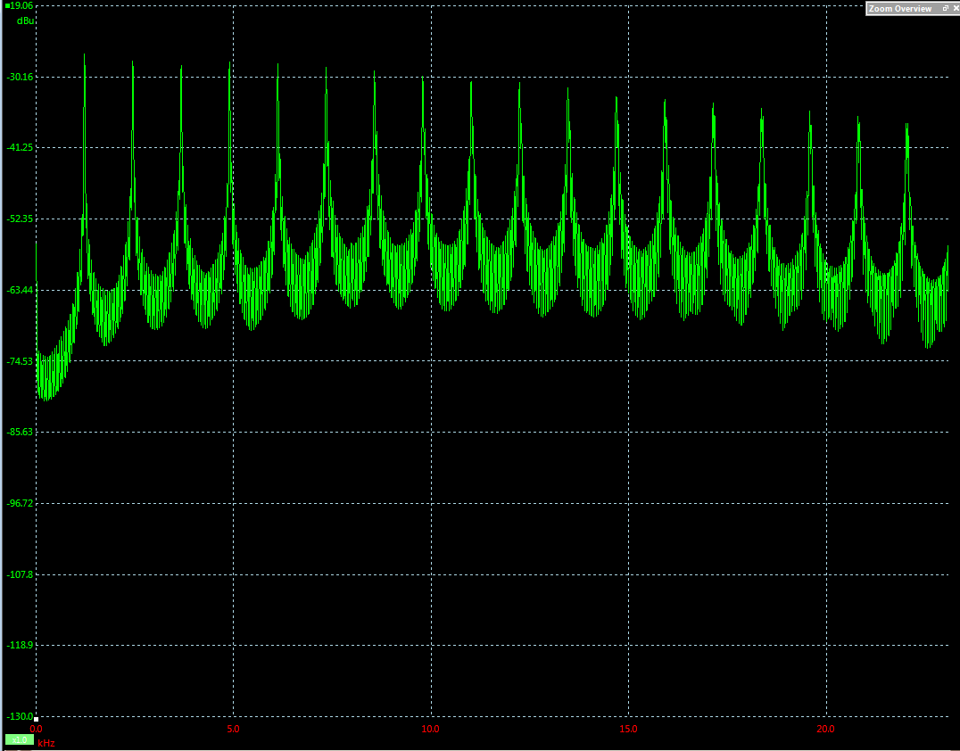

Here you see the same signal in the frequency domain;
Analyser now samples at 10Ms (10 mega samples per second) which allows looking up to 5Mhz of frequency (Nyquist);
The signal is the most square, which implies odd harmonics (3, 5,7, etc.) of infinite frequency. So, a square builds form sines and the more square the square is (read : the more steep its slopes are) the more odd harmonics need to be represented.

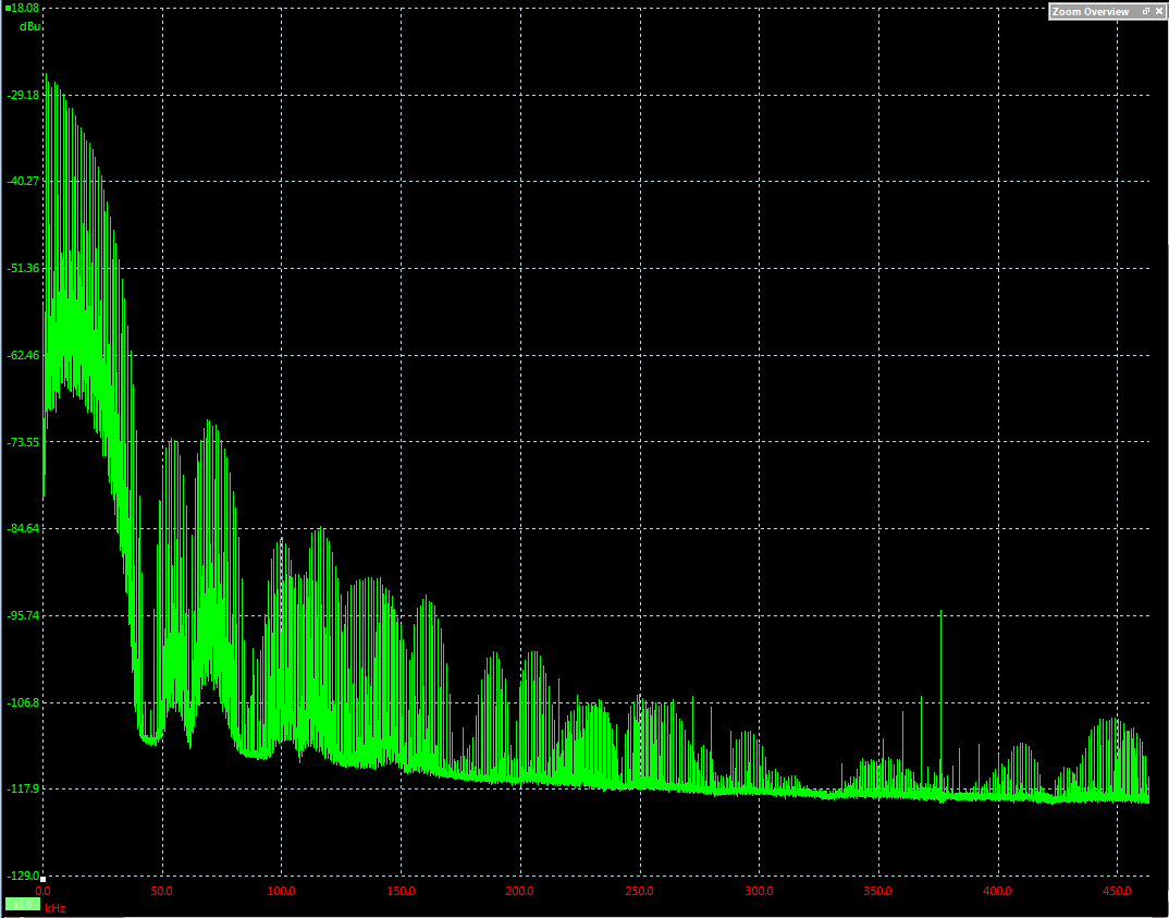

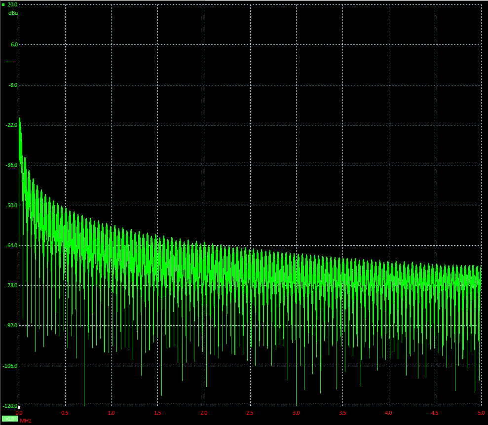

So here you see them up to 5Mhz with the notice that no filtering has been applied to the analyser (this counts for all the pictures unless told otherwise).
Here you see the same, but now up to 450KHz.
And the audio band.

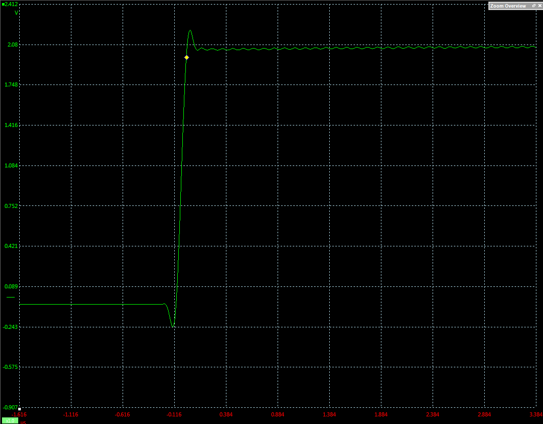

Now let's see how this looks like when the first picture above is zoomed in :

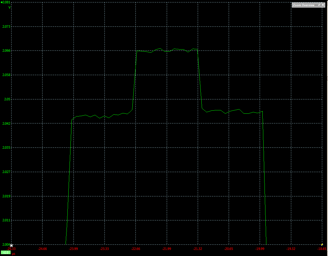

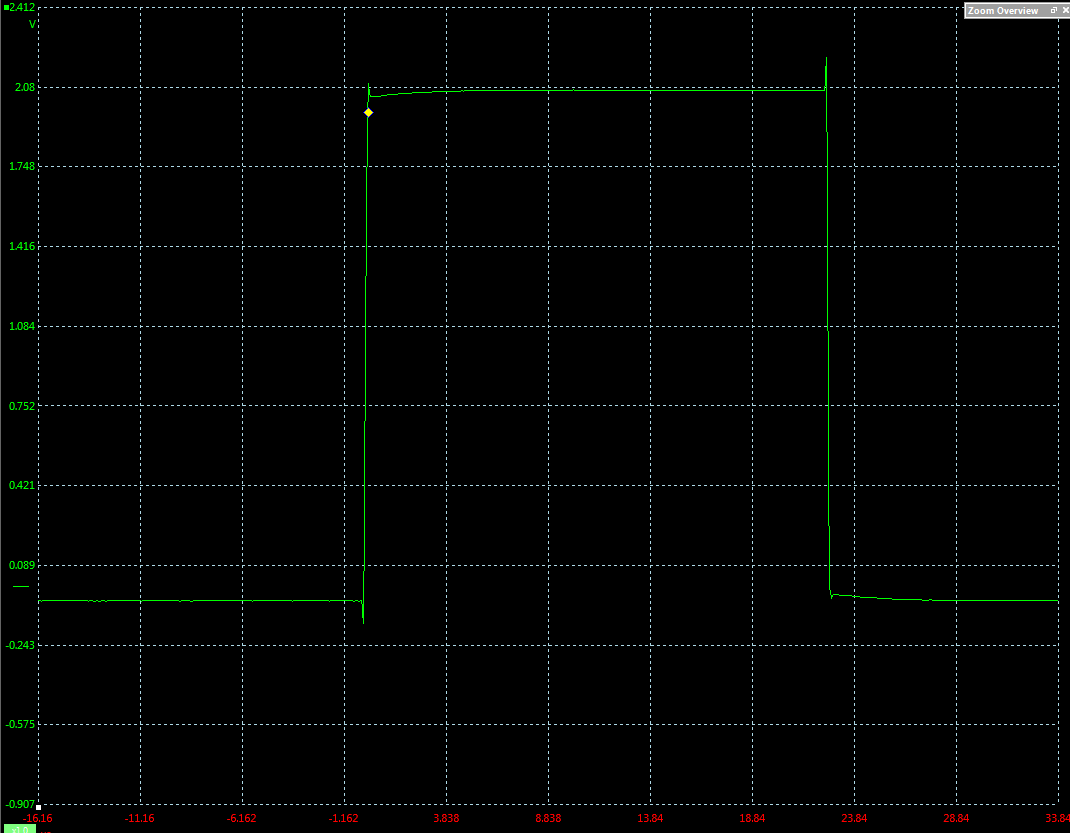

Here the horizontal resolution is 10us; analyser's sampling rate is 20Ms. This looks quite straight up, right ? Well, although you cab already see it, it really isn't. Look :
Now the horizontal resolution is 1us.
Or something like 50ns.
Actually this tells that it takes your NOS1 90ns to go from zero voltage to the maximum (of ~2V).
And ~160nV to go from 2V to zero.
This all tells that we deal with electrical limits with thus the notice that in digital all is as steep as steep can be.

But let's now look what happened to the frequency domain :
You might want to open this post in another browser instance so you can compare this picture and the below two with the same sequence as shown at the start of this post.

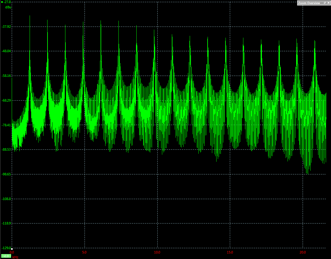

So what you see here is a lot of less "hash" beyond the audio band up to 5MHz.
Or how it now looks up to 450KHz.
Or just in-band.

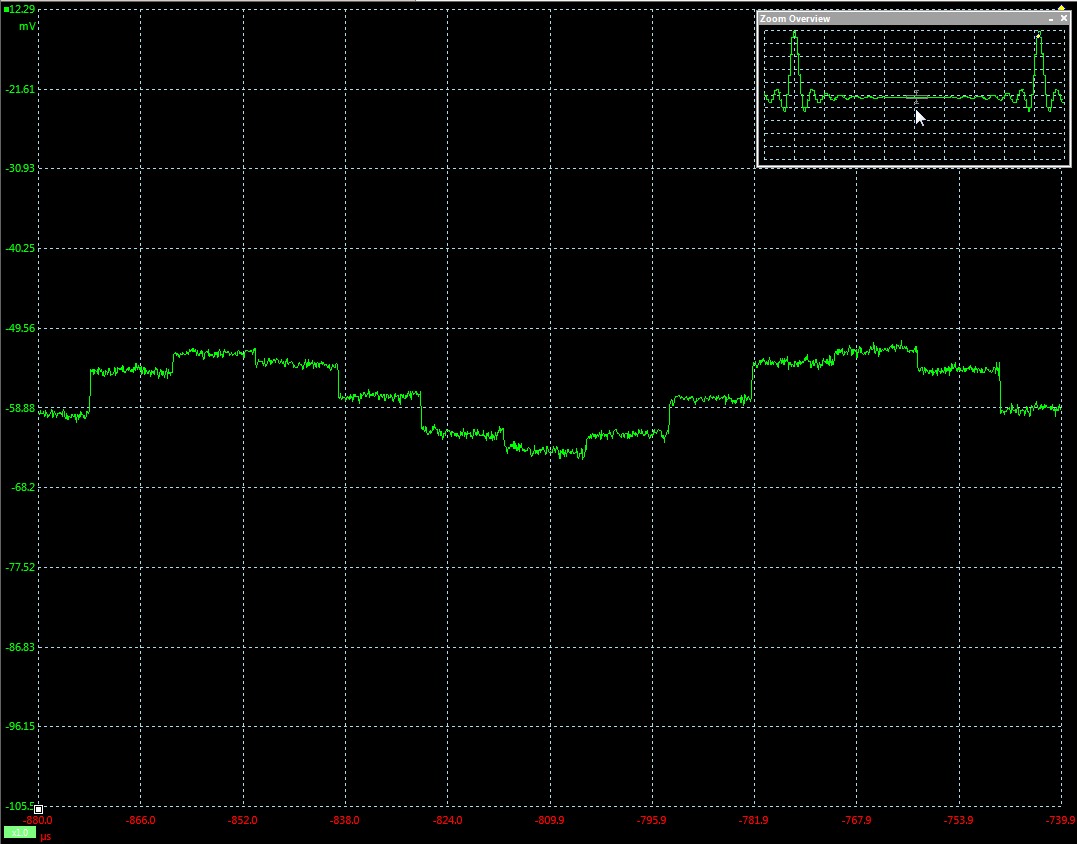

This is the top of our Dirac pulse zoomed in some more (compare to two pictures above).
And here very much zoomed in; Also see in the top right corner and where the mouse arrow is (and how round it looks from there). So what we see here is how the one sample spike has been spread over 16 samples (that's what happened with 16x upsampling/filtering) and how now hardly any overshoots are there any more and how the one spike has been broken down into elements. All near to perfect for symmetry.

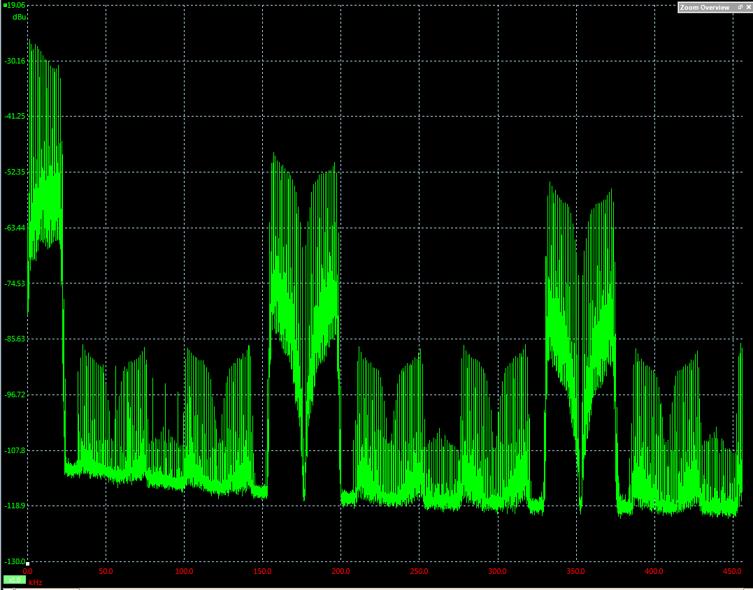

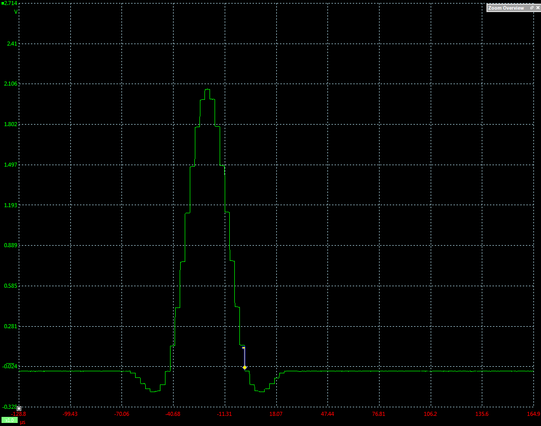

Here you go. This is 4x upsampled with XXHighEnd's Anti Image upsampling/Filtering which is fairly common to what a normal DAC will show;
Here too the one sample has been broken down into 4 (count the ones above zero Volt) but now there's also something like -500mV "utilized" (compare with the Arc Prediction pictures). That's now 25% in the wrong direction. And the ringing ? So *that* is ringing.

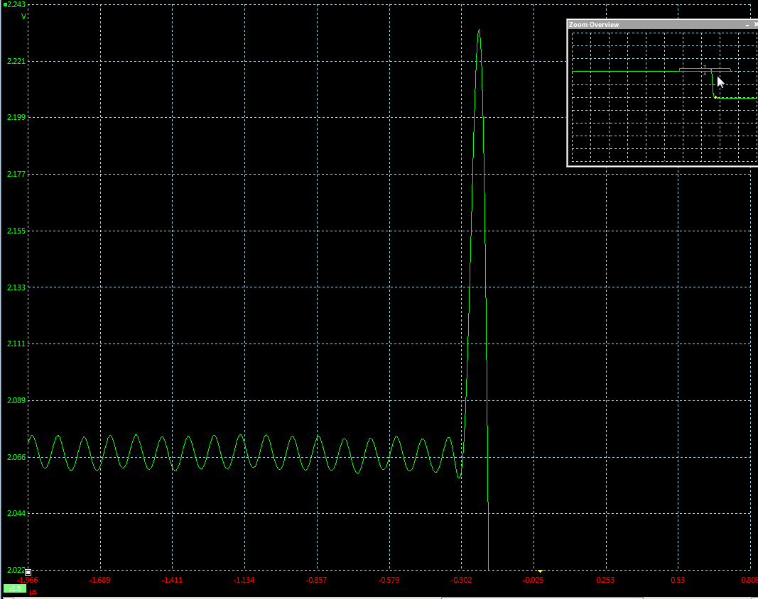

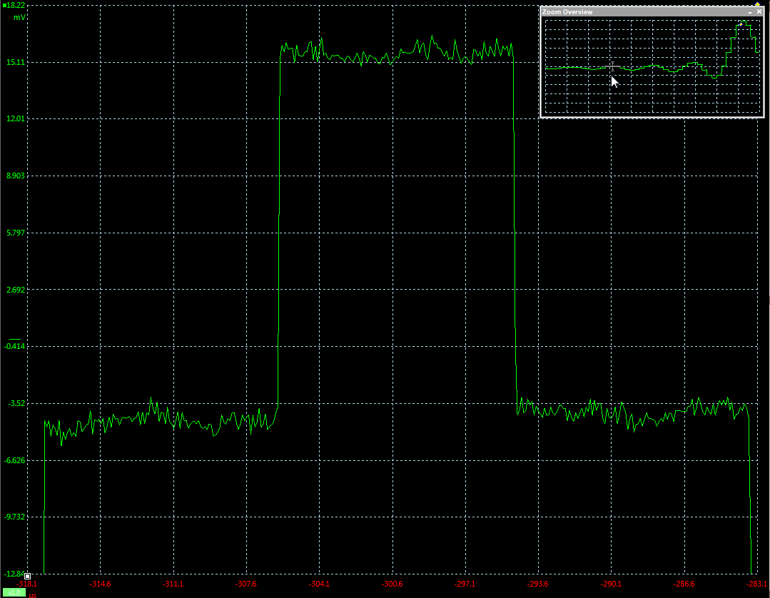

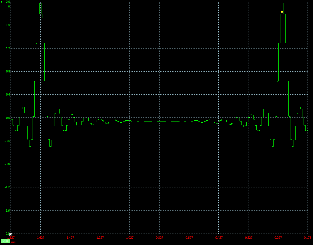

Shall we zoom in on that part between the two pulses ? Watch out :
Ohh sh*t. Look where the mouse pointer is and try to see the less than 1mm cut of the wave made (if look you closely you can see it, but it's really 1mm or so).
Now let's think again; This is still that 1200Hz spaced Dirac pulse. Thus, we originally had a one spike "transient" of one sample wide, and now it spreads forever. This means that while we should hear transients (the most brief ticks - vinyl like) at an on/off rate of 1200Hz (and this is my famous "Transient music" (ahum) this is now first smeared (the ringing you clearly see) while in between the two spikes (happening at a rate of 1200 times per second) it is not even silent.
And might you be interested : this one is similarly zoomed at the top of the real spike shown with Arc Prediction more above, while is is the "silent" part in the middle (see mouse arrow). This is a sheer 19mV you know ...

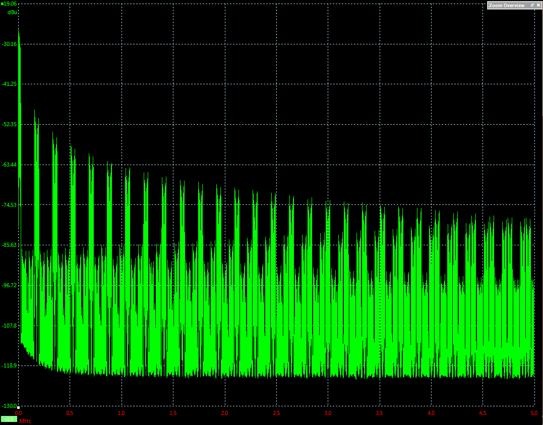

Here's the plot till 5MHz again to show that this didn't even help much (the contrary);
The 450KHz which rather shows nice Dutch tulips which only show the anomalies (instead of consistent behaviour).
And the audio band which still looks quite nice (meaning : as intended), but which now also shows the fairly steep filtering applied. So yes this implies ringing on behalf of the better impulse response, but we're still not finished with this.
This will be the last sequence and it will show you how even steep filtering will not preserve the transients of audio while in the mean time now *all* is molested. Let's start with this one :

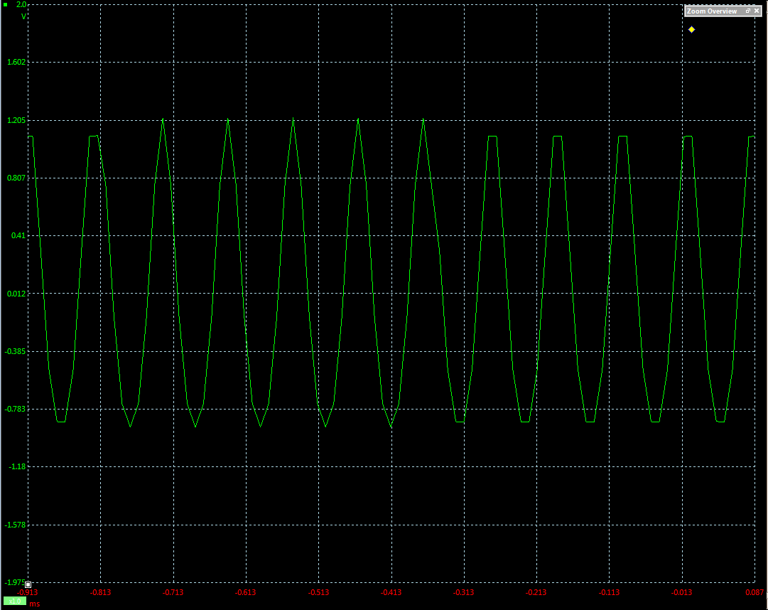

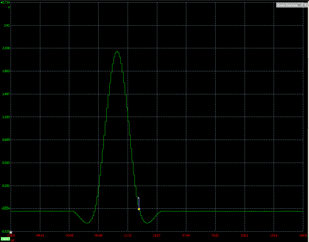

Here I deliberately lowered the sample rate so the "stepping" does not show. But doesn't this look like a sine ?
Notice this is still Anti Imaging fairly normal filtering.

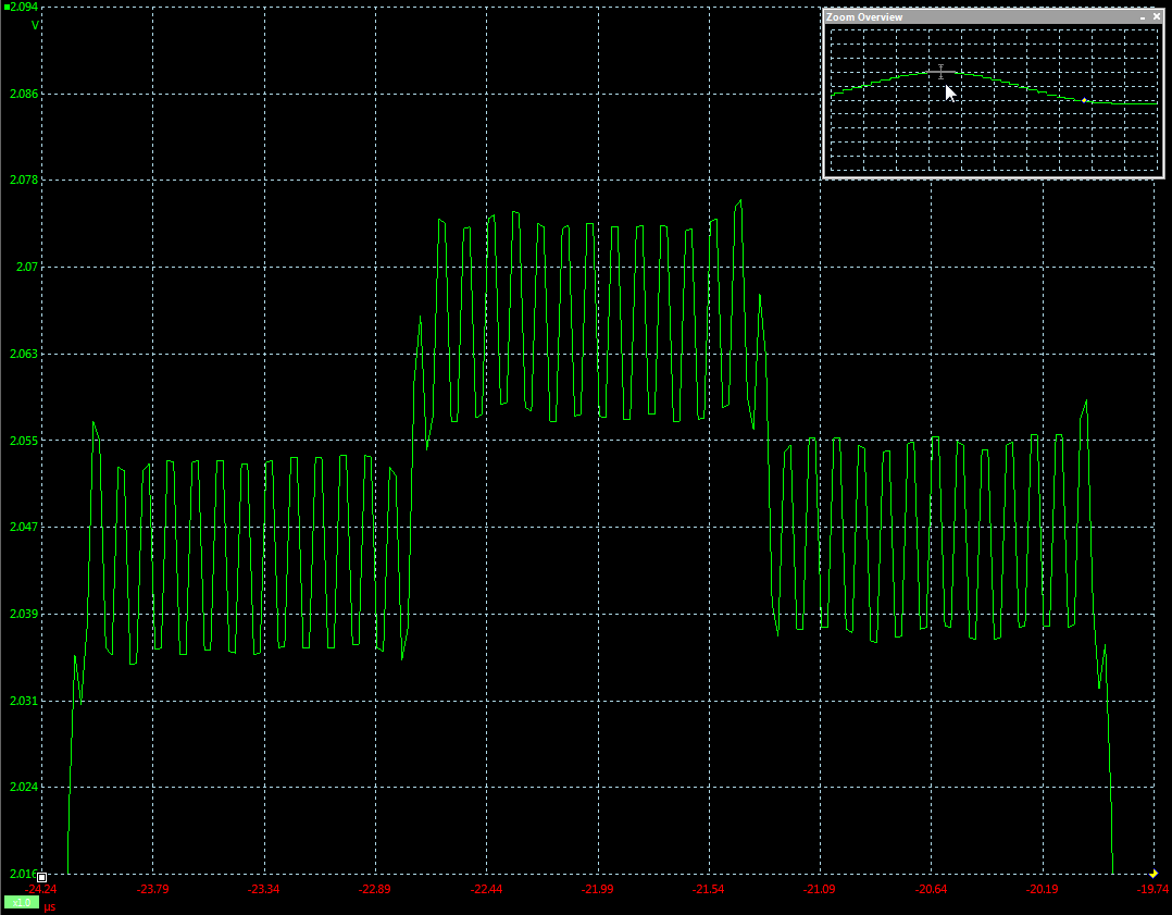

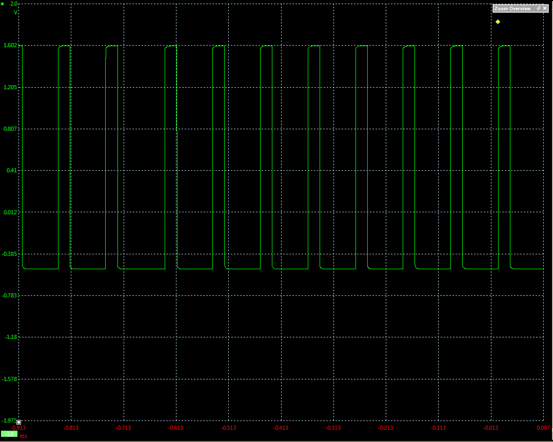

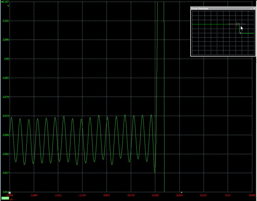

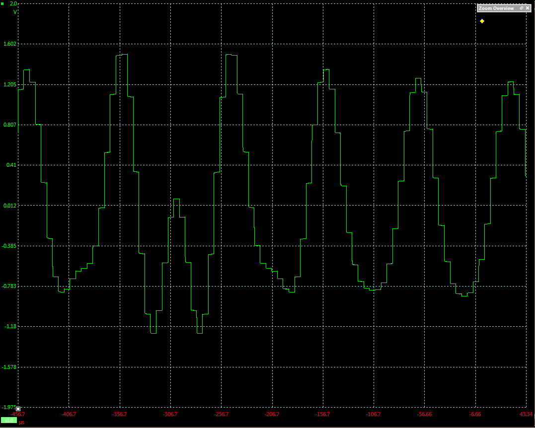

Here you see a time resolution of 0.1ms per devision and one cycle occupies that. This means a 10KHz (still) Dirac pulse is in order here.
Notice that while this is originally is a +2V signal (no negative) the range now spans something like +1.2V / -0.8V. Hmm ...
Zoomed out the signal. Chr*st, what's happening here then ?
Ok, this is a too low sampling rate, but it's the lead in to show you better what occurs here. Look :
Here the sampling rate is sufficiently high again and with some more wave cycles showing per division something nasty is going on. But I have been mean, and I created a Dirac pulse train where the ringing of the frequency runs into the next pulse and now the filtering can't cope (the math doesn't work anymore - and it is not my math). Look :
See that downward excursion ? Same as one of those 5 you see in the previous picture.
Also notice (and try to grasp) that the enrgy at positive voltage sort of anti-compensates for negative. In the previous picture you can see it better, but in this one it is just the same. But why ?

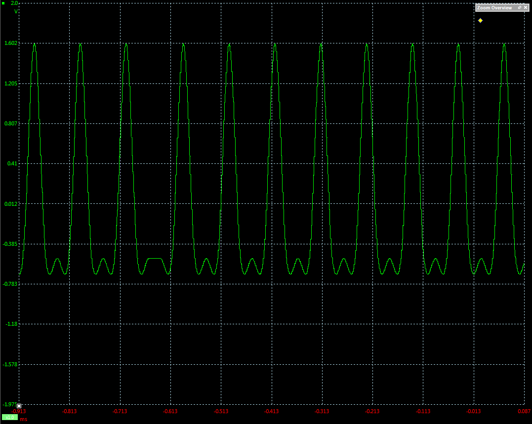

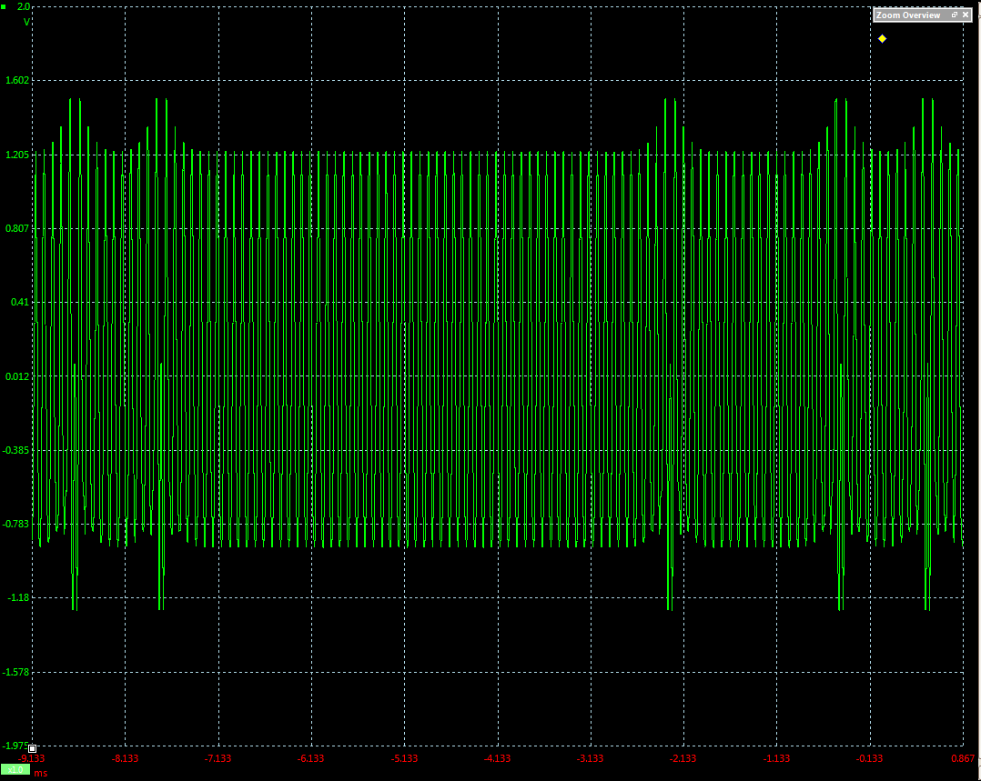

I fooled the filter with presenting real music !
Well, sort of. The frequency of 10Khz is not a constant one, and once in the x-many pulses the space is different.
But now be careful : This is not a normal frequency as such - it is transients only. Remember, that phenomenon of which millions exist in a track. And now you can see how nornal filtering deals with that.
Not so with Arc Prediction, per which means you finally understand the real picture of what happened in the above ones. Here :

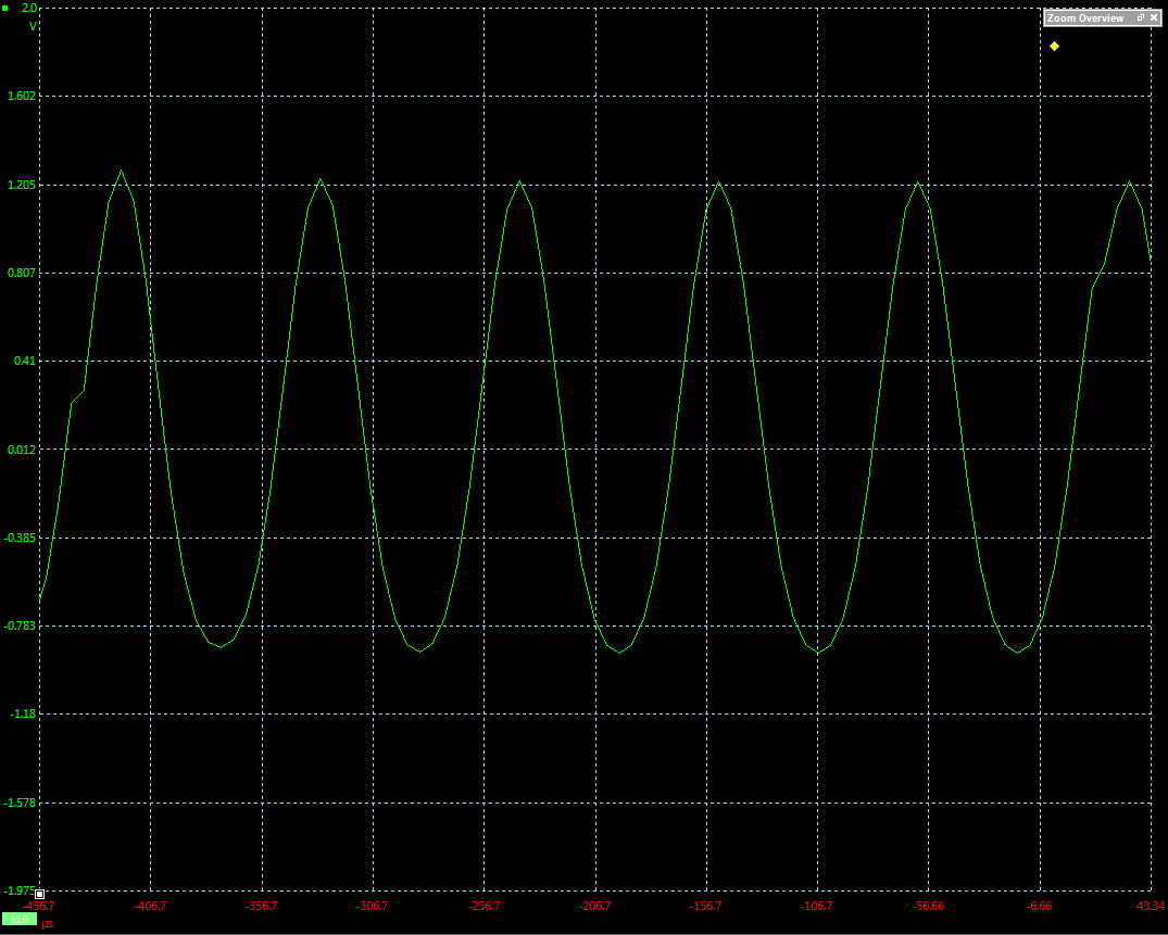

Aha ! *Now* you'll understand. So see the third cycle and the more space at the bottom. Remember, that's zero volt and it denotes the spaces between the still one sample long pulses.
Not only the bottom = silent part is superbly there, but also the tops are totally even.  And also not to forget : no ringing. And no real damage to the frequency domain either.
The above is again 16x Arc Predcition. Below is the native 16/44.1 signal of this :
Is that beautiful or not ?! Notice the longer space is at the third cycle (sample) again.
