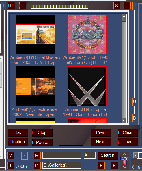

This shows the first part of our Main Gallery, or IOW the root of our Galleries. You see it in this case as C:\Galleries\ in the bottom of the screen. It also shows that 36007 albums should be in there, or better : 36007 Gallery Entries.

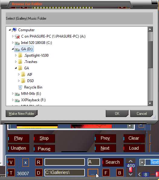

Now let's grab our "new disk" and say this is a disk I maintained on a different system, in my case a Mac; I copied my albums as maintained on the Mac to a USB disk and I connect it to my main system (where XXHighEnd is used).
I used the button under the mouse arrow (near the bottom) and you see the "new disk" under drive D: (named GA).
Because I can't play DSD anyway at this moment, I select the AIF folder in there (not visble in above picture), press OK and what comes from it is this :
Now I want the music contents of D:\GA\AID\ to show up in the Library Area and press the Search button. The result :
Apparently there are 140 (AIFF) albums on that disk (in that folder I selected). Not all contain Coverart but that's another matter.

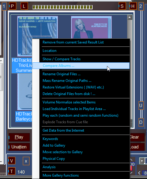

I selected all the albums in there (click the first and apply ctrl-shift-end), did rightclick and will choose "Compare Albums ...".

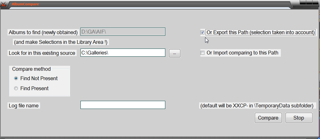

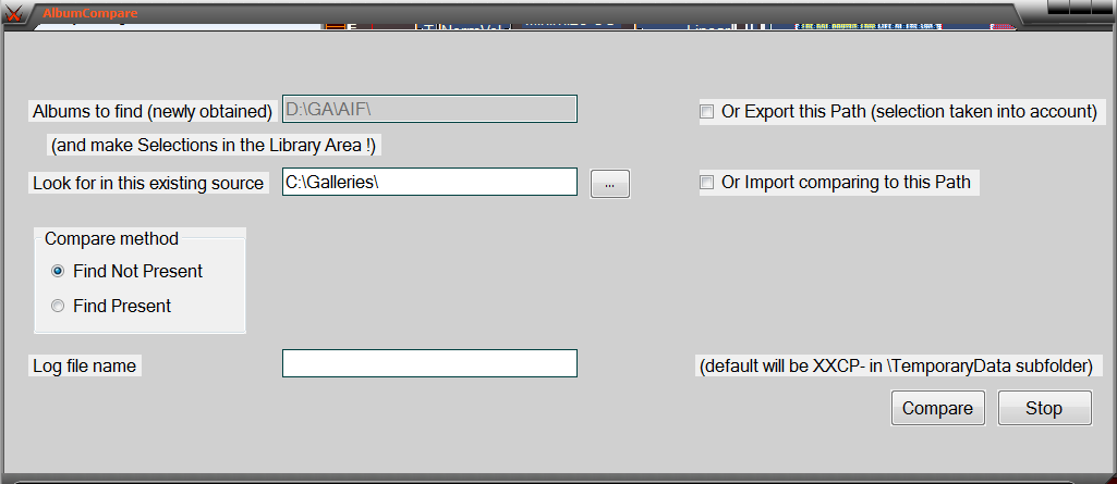

This screen shows up :
The "Albums to find (newly obtained)" field is grayed out because it is that "disk" which currently is in the Library Area.
The "Look in existing source" field defaults to C:\Galleries\ because that is our Music Root in Settings.
So, our "existing source" is functionally all we have for albums, but notice that any other sub structure of the Galleries can be appointed (like C:\Galleries\Jazz\) or that any Original Location (where the albums really are stored) can be entered. So it is just want you want to do, and in our case we want to know which of these 140 albums we already have.
Notice the "Compare method" which is set to "Find not present". This means that once we press the Compare button in the bottom right, the result showing in the Library Area later will be the albums "not present" in our main Gallery.
Notice :

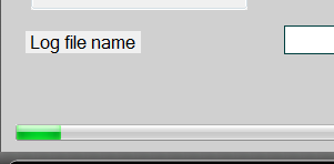

When the Compare button has been clicked, the process begins and while the progress bar shows that things are being processed ...
The "Album counter" in the bottom of the XXHighEnd screen also runs.

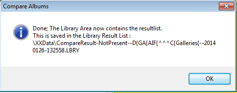

When done, this message appears :

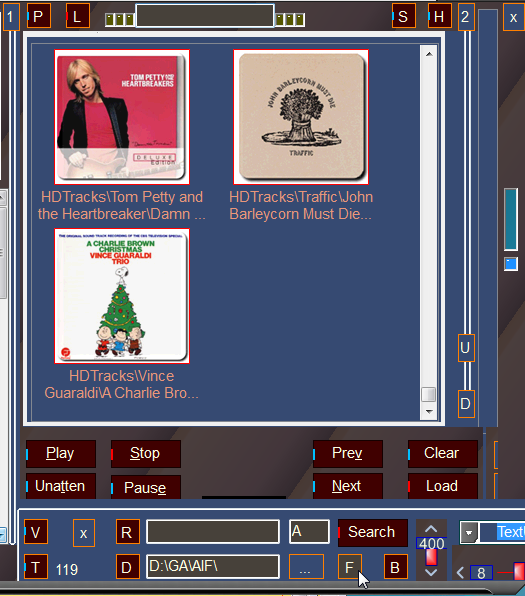

This message tells you that the result of the comparison is stored as a Result List and while the result currently is shown in the Library Area (seepicture below) it can happily be retrieved latet for further processing (we'll talk about that in a minute). For Result Lists, see here : Save Library Result Lists.
So here we see (the end of) the Result List of the Comparison and apparently 119 of the 140 albums I do not have in my XXHighEnd environment.

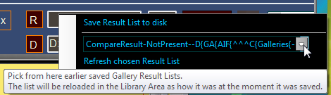

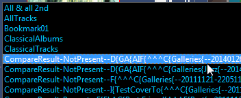

In the mean time when the [ F ] button is rightclicked (see mouse arrow in above picture) we'll see this :
And when the list is opened (see mouse arrow above) we can see our result under the mouse arrow below :
... and we can see that we can happily close XXHighEnd with the obtained Result List now showing in the Library Area because we can retrieve it later (actually per means of above two pictures).

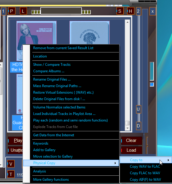

We can again select the items in the Library Area (I selected all of them) and next choose one of the Copy To functions. You will be provided with the possibility to select a target location (not shown here) and when this is all chosen the selected albums will be physically copied.
If we do it like this, and now referring to not much hassle and just copy all to one folder (which implies sub folders for the albums as usual), all will be copied to that main folder indeed but it will not be grouped (into Jazz etc.); this can be done later by means of Galleries and it is not the subject here. But notice that you can also take your time to album per album denote a grouped location in the first place (so, copy the Jazz albums physically to your storage location with Jazz albums). Anyway :
Once the albums have been copied, one way or the other they now should be obtained in your main Gallery, waiting for the next time of an Album Compare. Thus, when we'd omit that our "newly obtained" albums will not be seen as "already there" and they will not be included in the Comparison. Moral : do not forget to obtain these new albums in your usual Gallery structure (like Jazz in there and all) and no matter where you put them, they will be under your main Gallery structure so the next time they will be included in the Comparison.

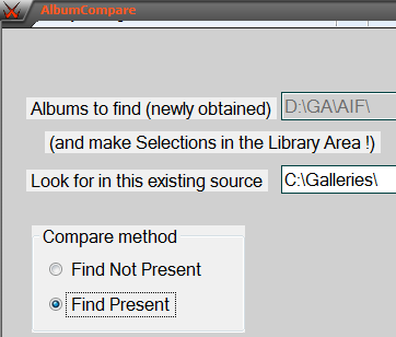

Here I denoted "Find Present" and the remainder of the fields are left untouched;
What will be the result of this ? 29 albums (140 - 119) which I already have on the main system. It can serve as a kind of double check; further not much useful. But now this one :

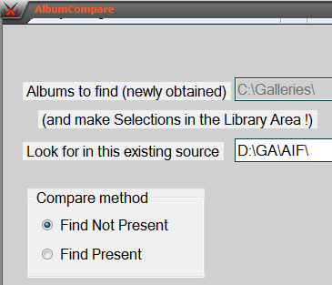

Here I started out with asking for my main Gallery in the Library Area, I selected all again and next denoted the 2nd field to that same "new disk" from the Mac. What are my intentions now ?
I now want to apply the procedure the other way around as described in the large outlay above and I want all of my albums on the main system to be copied to that other (Mac) system. So now the "GA" disk represents all on the Mac as how it came from there, and on the main system I want to compare all what is not on that GA disk and the result (all what's not on it) I want to copy to there.
What will come from this is a Result List of 36007 - 29 = 35978 albums and if I select all of them for "Copy to" I could virtually copy them to the GA disk and next the Mac system will be appended will all the albums from the Windows system.
Notice : I said "virtually copy to the GA disk" because it won't fit. However, what will happen is that all is copied until the target disk is full and there it stops on the boundaries of full albums; You will easily see what was copied last (look at the target disk) and when a new empty disk is connected you will start the copy from where the other stopped (matter of selecting the proper first album (top to bottom) in the Library Area before selecting "Copy to".

What you see here is that I activated the "Or Export this Path" field. Notice the "Or" which tells that we are not going to apply any Comparison at all; we are only going to export the existing albums on the Mac via a small footprint file;

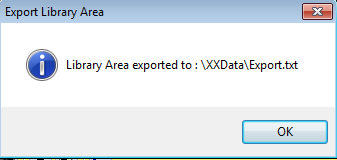

I'll press Compare in the bottom right anyway to create the file;
Within a fraction of a second this pops up :
Aha.

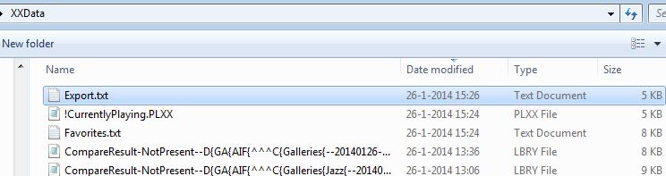

And indeed, there is is ... (5KB in size).
I move over this file to the XXHighEnd PC, put in in my \XXData\ folder over there, rename it to Import .txt and now do this :

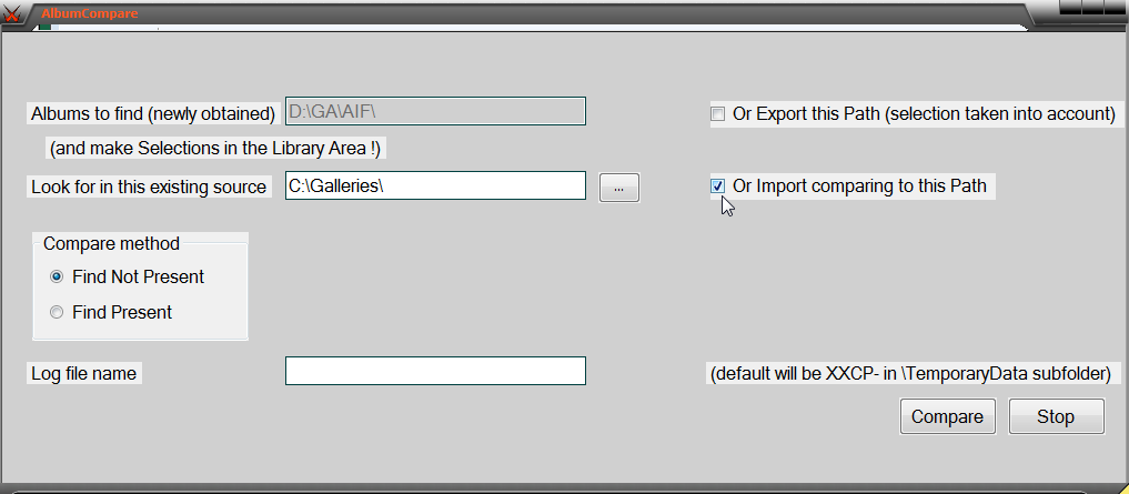

So now I activated "Or Import comparing to this Path" with again the emphasis on the "Or" now implying that the upper part of the screen is actually not active at all.

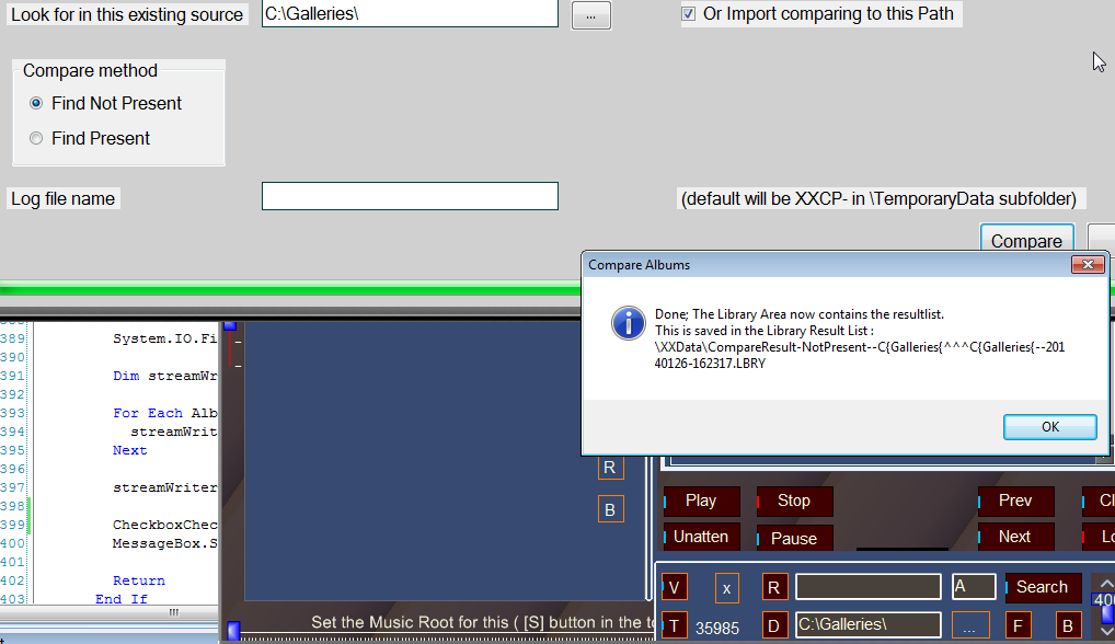

And I'll press Compare again ...
This is now the result ...
Remark : The 35985 you see there is 3 off from 36007 - 19 because I found an erroneous album and had to mangle with two others which appeared to have a wrong structure. That left alone : What noa happened ?
I exported te "data" of 140 albums (but think 138 by now) from the Mac side of things and I imported that to compare with my present list in C:\Galleries\. I denoted "Find not present". And about trying to wrap your head about things, think about what the purpose here can be. So :

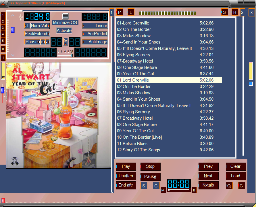

Lastly, how you often won't trust albums to be NOT the same, while you were sure they are. Example :
You may have seen this album in one of th first pictures in this Tutorial. Well, it came out as "not present". Of course I don't trust it. So I load both in the Playlist Area (the one I already had on my XXHighEnd PC and the one coming from the Mac) and the second one starts at the highlighted track.
Notice that I can also use two XXHighEnd instances for this and put them next to eachother for more easy comparison. Now :
It is obvious that the two are not the same at all because the second one (this one came from the Mac) has 12 tracks while the original 9 (as I already had it in the XXHighEnd PC) has 9 tracks. But also look at both track's 02. That difference in time can easily be dedicated to ripping (CDRom anomalies and ripping settings); this is as well as possible eliminated from the equation. But now also look at track 03. This 5-6 second different for sure is not the same "mix" or whatever happened. So, a thing like this already makes the album different; the difference of track 02 will not.
But of course the different number of tracks is leading here.
