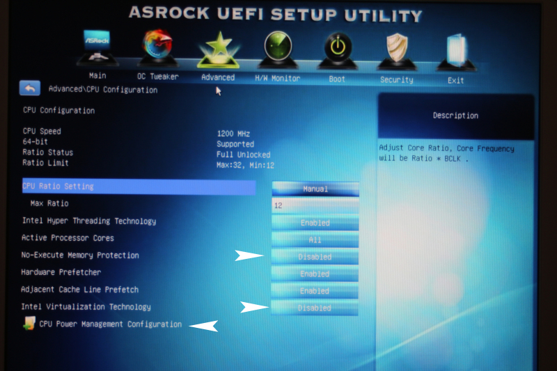

Below you'll find screenshots which will tell you how so set all the BIOS settings for your XXHighEnd PC;
They are Windows 8 (SQ) oriented hence are not optimized for Windows 7 (notice that explicit Windows 7 optimization just wasn't sorted out (yet) for the latest XXHighEnd 1.186 version and that this does not tell all is wrong as such for Windows 7 (we use the same settings for Windows 7 here).
Keep in mind : Changing one of the advised settings to "your own" is OK, but the audio performance will degrade by it by guarantee and you can not see that. Of course this is not really about all the settings, but you'll get the hunch.
When a remark is to be made about certain settings you will find these *under* the screenshots.
Generally you can watch for the settings at the white arrows only; the others are default and don't need changes.
You go into the BIOS screens by means of (re)booting the PC and frequently press down the Del key.

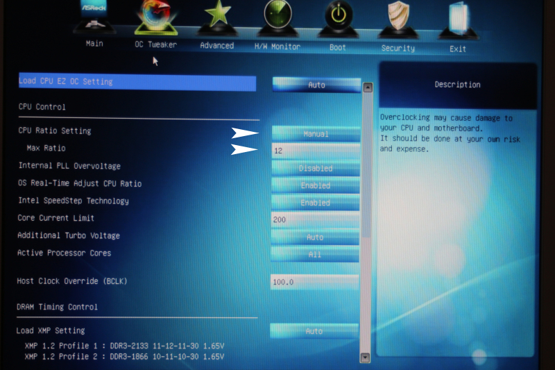

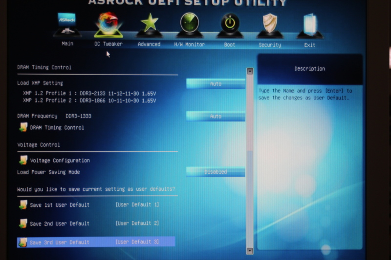

Overclocking : See the "Max Ratio" which is set to 12 here;
Watch out : The normal value for this will be "Auto" where you now see "Manual" and this equals a Ratio of 32 (or 34 depending on the processor) which shows up by default when the "Manual" setting is selected. Careful though, because a "Manual" setting of 32 (or 34 depending on the default) is not the same as the "Auto" setting. Now notice : As soon as the "Manual" setting is selected, no TurboBoost will be in order; This is just a general remark (and we don't want that), but good to know because your system will be slower of it.

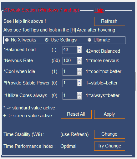

What we do is UNDERclocking per means of the ratio of 12 which relates to XXHighEnd XTweaks setting of "Use Settings" and from top to bottom the values : 43, 100, 1, 1, 1. See here for Windows 8 :
Once booted into Minimized OS your processor will run at 430Mhz now (0.43GHz). Mind the consistency with the XTweaks settings.
Or for Windows 7 :
Winsows 7 will run at 500MHz (0.5GHz) with these XTweaks settings.
Notice : For Windows 7 it is possible to go as low as 168MHz but this is *not* for the better and with such a setting the processor will run 10C/18F more hot compared to what's considered normal here (40C/104F).
Alternatively you can set XTweaks to "Ultimate" for Windows 7 which is considered slightly worse for SQ but now the processor will run close to 1200MHz with a thus faster response.
The Ratio can be set to e.g. 40 for the actual OVERclocking and then your processor will run at 4Ghz (while normal is 3.2GHz or 3.4GHz) which still will be okay for the cooling you will see more about below (see "Cooling :").
Watch out : When the BIOS has been reset, while being in the BIOS the system runs in the hottest mode; this coincides with the fans running at high speeds (again see Cooling more below) with the notion that this is OK. BUT : Do not lower the revs of the fans, then reboot (the lower revs become active only then) to next look into the BIOS for ages without at least setting the "Manual" (picture above) because all then heats up fast.

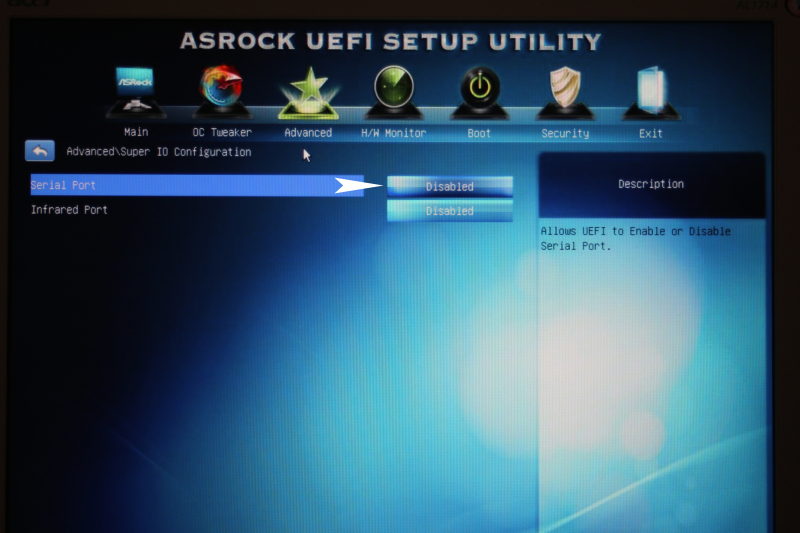

Watch out : While these are both disabled, it assumes a PCIe USB3 card for USB connections. Without that the *both* can not be shut off, or you won't have active USB connections (and can't connect your NOS1 when in order).

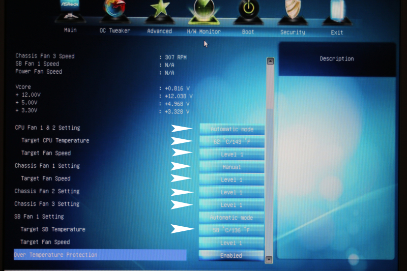

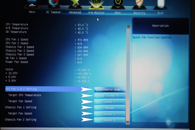

Cooling : The settings you see here (plus the below ones !) relate to the necessary cooling of the system; the settings you see assume normal operation hence not "overclocked". See for that "Overclocking" more above.
All sliders can be all the way to the left for complete silent operation (also note the fan control knob(s) on the back of the PC which can be turned all the way to the left) if only the frequency Ratio (see under Overclocking) is set to Manual and not higher than 32/34. But anyway watch the temperature in this "H/W Monitor" because all also depends on the ambient temperature;
Try to keep the processor's temperature under 52C/126F for better longivety while it sure is allowed to be higher (but elsewhere in the BIOS settings we limit it to 62C/144F).
Watch out : No fan settings or other in this screen (and the below one) will take effect immediately; this counts for all changed settings in the BIOS; only after a reboot they take effect. This, for example, means that when you set the fans too low with a too high cpu Ratio (overclocked) after a reboot things may run (too) hot right away (this goes real fast, like within seconds).
This is nothing to be afraid of, if you only realize that changes take effect only after a reboot.

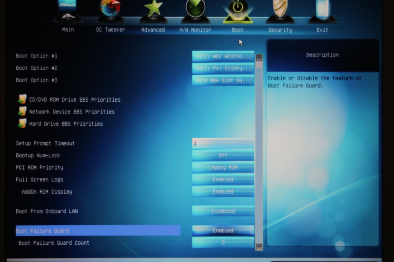

"Manual" : Here you see which of your "boot devices" will be used first for booting, hence which will be your OS (version) when more are available. Would you click on the first option (where the "P4" shows) you will change whatever pops up and what you choose as the first boot device.
The importance of this : Supposed you have your internally assembled 2.5" drive still there but want to try another OS in e.g. the 2.5" bay, you can put the hdd with it in there, boot, go into the BIOS and select that hdd in the 2.5" bay.
Notice : The third "folder" option (yellow icon) you see there, allows to choose boot devices in the first place and when you just put in that other hdd in one of the removable bays you may need to click on that "Hard Drive BBS Priorities" option to make it appear in the list the white arrow points at.
When done, click Exit in the main bar at the top, choose "Save" and after that the system will boot normally.

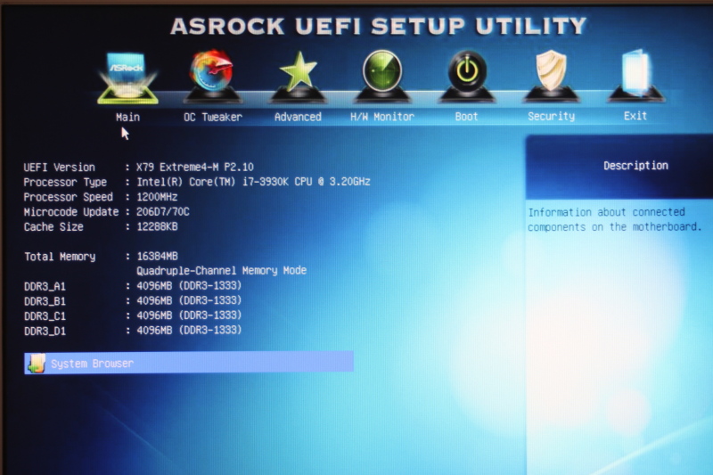

Is there a reason that you are running an old version of the BIOS?  I notice you are using P2.10 but the current version is P3.0.

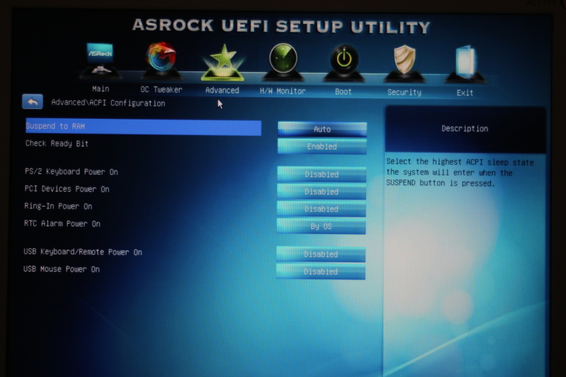

Also in the ACPI Config page I had disabled "Suspend to Ram" because I have disabled hibernation and sleep in windows8.
I think we're a couple of versions further than 3.0 but it's no problem.
I use 2.10 just because I don't upgrade to each new version; see no reason for it either. A bit fuzzy it is though that a new customer would receive 3.x while that's just n the mobo and it can't be downgraded (I actually never tried, but often this won't work). This, while older customers received 2.x for sure (can even be 1.x which is not suitable for W8 officially).
So it's a choice and it should be "readable" for everyone.
Should be a good one. Why ? because the PC is shipped like this (one of the ~500 subjects of OS changes Wink).

For those interested and who already looked at the BIOS screens : I added a screenshot of the XTweaks settings for Windows 8.

In the first post I have added XTweaks settings exlplicitly for Windows 7 (see new screen shot).
