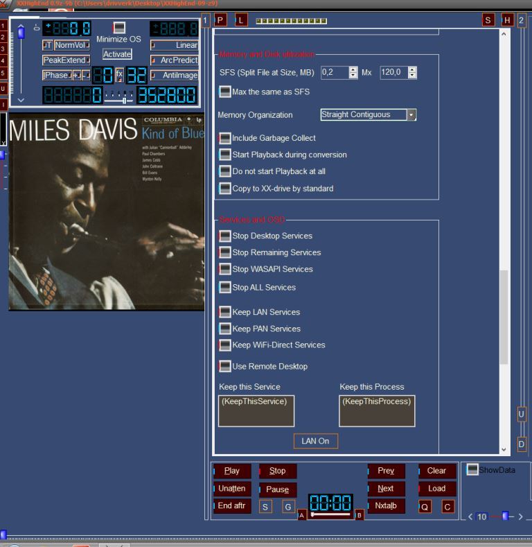

Maybe you changed something in the "shut off services" section ? Most obvious would be "Use Remote Desktop" of course ...
Pls see below screen print of current settings: Any clue here?

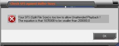

1.
Screen shot: Loading a single 16/44 song and trying for Unattended playback with present settings; SFS = 0,2.
2.
Changed SFS = 100 and tried again for Unattended playback.
3.
XX gives me a "wait for services on top" notice, as is normal.
4.
The RD lose contact with the PC (as is normal). But no music...
5.
When re-connecting with RD I find that XX is turned off and I get this small error message at the far bottom right; Photo #2. (This message appears ONLY when logging on to the media-PC AFTER an failed Unattended play attempt).
