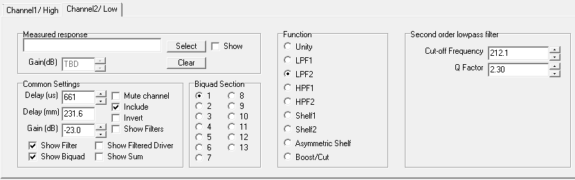

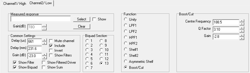

Yo,
Our "First Weekend Twip" has been a theoretical experiment, anticipating how Windows 7 might sound different to Windows 8 and how we can make Windows 8 sound the same as Windows 7 (this in brief). This worked quite well but with a small problem : Windows 7 doesn't sound the best. And again in brief : the "deep down earth" bass from Windows 7 may be nice for a while, but only for a short while. Main problems with it (IMO of course) :
- Too much of a same deep down earth sound throughout;
- The speed of the bass disappears.
What I tried now is by means of listening adjust the filter(s), though with a large dose of theory behind it (what change for "graping" will imply what kind of sound). No measurement has been in order.
I am sure this can be improved upon, but the 5 hours with this of this afternoon only ... next time more.
What you can (should) expect is a bass which goes exactly the other way around of the "First Weekend Twips". There is generally no deep down earth sound and instead it's the mere concert level bass type. The stiff one. The fast one. And a small warning maybe : this is now very profound when playing music which plays in the area concerned mainly (of course I am referring to "ambient").
If all is right all frequencies sound fairly even en no buzzing is there anywhere (the Weekend Twips sure had).
So here we go :
First off, grab your original settings without the Weekend Twips.
Change Filter-1 to what you see above (right side).
Change Filter-7 to what you see here.
Make a new Filter-13 and set it like you see.
This should be the result for the part concerned.
Watch out :
My gain (attenuation) of the orginal filter was -24.5dB while now you see (above screenshots) that it's at -23dB;
If you observe closely the whole graph from your original (desired) Gain setting, then you see the difference to be in the relationship with the left part of the graph (not shown here) and the part I showed above (blue graph). So, in my case the Gain changed with 1.75dB *more* in the left part (we did not change a thing about that) while the part we just changed is ~1.25dB *lower*. Observe where the roll off starts (say 120Hz) It is about this latter ! So this point should be 1.25dB lower than what you used and you should NOT adjust the Gain to make it as high as before at that point. It is also not so that you should leave the Gain unchanged. So :
You must set the Gain so that it is now 1.25dB lower at the point the roll-off starts.
Clear ?
The net result will be that the left part (not shown) rises with ~1.75dB while that right part dropped 1.25dB. So for "balance" there's a difference of 3dB between both ends of the spectrum.
If you now can hear that the crossover is not working well any more then let me know. I tell you because I explicitly did not want to do this by measurement. But it should be OK.
Also, *if* you can hear the crossover not being right, we can expect that it can be solved with some 40mm of time difference between horn and bass section; that 40mm "shift" is easily available by means of sliding the horn back- or forward.
And if it doesn't work at all, also please let me know in this topic.
Notice : This will work for Windows 8 only (I'm sure) and KnB is sailing on the high sees and didn't bring is speakers. So we are with 3 only.
