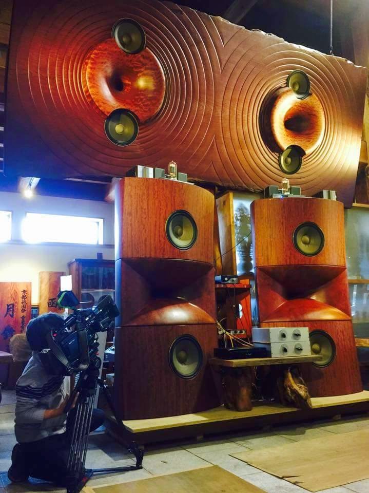

« Reply #43 on: February 20, 2015, 05:08:43 pm »
And best SQ in the world I'd say.
haha
Haha, yes - are you sure???
Saw the horns here.
http://www.monoandstereo.com/2015/02/tatsuyoshi-moriyama-horn-based-speakers.html
« Reply #44 on: February 20, 2015, 05:13:33 pm »
Wrong DAC. Wink
