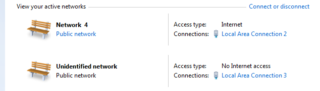

But the root cause of this issue will remain - why is the music-PC throttling the output to the audio-PC? Maybe it's the Firewall or Defender in the music-PC? When I look at the 'Network and Sharing Centre', it is referring to the direct connection to the audio-PC as an 'Unidentified public network'. Does this seem right?
« Reply #22 on: February 29, 2016, 02:59:14 pm »
Mani,
Yes. See below.
Are you using the same physical network connector in your Music Server PC for the testing you did vs the connection to the Audio PC ?
Network ports can be set to 100Mb (or maybe even 10Mb) instead of the required 1000Mb and/or can be set to Not Dual mode or something (two-way communication at the same time).
