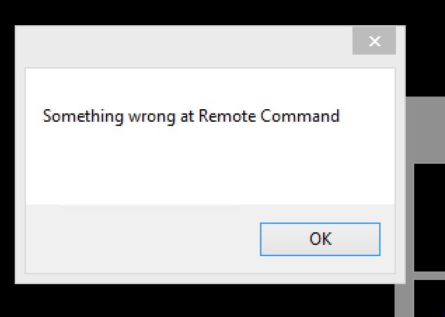

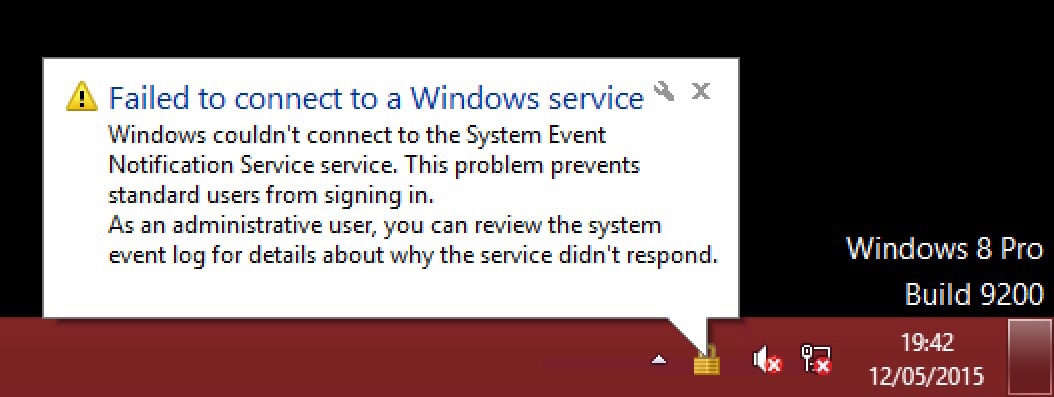

In my setup its not possible to use volume commands at unattended.
RDC keyboard works fine. But when using the xx osk it either not respond or it shut down the remote connection and xxhighend. Have to restart music PC
KnB
Posts: 125
« Reply #1 on: May 20, 2015, 07:17:26 pm »
And now i had the same fault when using the RDC keyboard.
Edit:
Volum up/down using XXosk and RDC osk gives somtimes only a message:
somthing wrong at remote command.
And somtimes it kills the remote and xxhighend..
« Last Edit: May 21, 2015, 07:41:36 am by KnB » Logged
« Reply #2 on: May 21, 2015, 01:06:05 pm »
Kjell Narve,
What you most probably will be doing "wrong" in this case, is that you don't start the OSK from RAMDisk, while XXHighEnd itself is.
So besides having a desktop shortcut for XXHighEnd.exe from RAMDisk you must also make one for XXOSK.exe.
Let me know if this solves the issue ...
KnB
Posts: 125
« Reply #3 on: May 21, 2015, 05:31:37 pm »
Tested with osk from RAMdisk, same result.
« Reply #4 on: May 22, 2015, 08:13:32 am »
If you are using the Custom Filter ... The SFS can't be that low. I did not sort out the limits, but I think that about 2 will still be OK.
I use 4 and when I give e.g. 4 subsequent VolUp commands (so 4 in a total of ~ 0.5 secs) then things also run in trouble (starts to hiccup and is difficult to catch up again).
KnB
Posts: 125
« Reply #5 on: May 22, 2015, 09:41:29 am »
It failed under 4 and 2 and 12 witch was my last setting.
Signature is updated with my current settings.
KnB
Posts: 125
« Reply #6 on: May 26, 2015, 08:22:46 am »
Works now in 2.01  Happy
