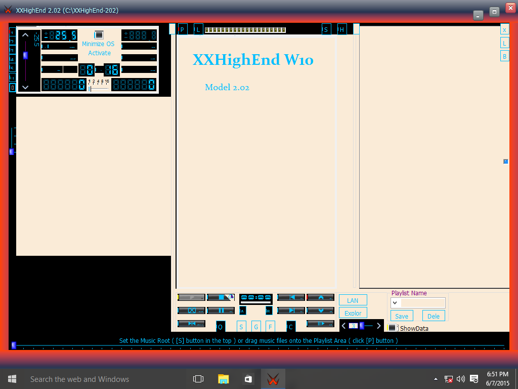

 I have a problem with scaling. Tried a lot off settings but no text in the upper left corner.
« Reply #1 on: June 07, 2015, 07:34:18 pm »
Gerard,
Can you tell me first, please, whether XXHighEnd finished the very first attempt of starting up (say "install") or that you had to kill it because nothing happened - BUT it showed on the Taskbar.
« Reply #2 on: June 07, 2015, 07:37:11 pm »
Anyway, I suppose this can happen to everybody as it happened to me too. Now I must find/write a procedure how to overcome this. All not difficult because it is about going into the Scaling ([ S ]) and adjust colours, but ...
scratching
I don't even know what you mean by that ?
« Reply #3 on: June 07, 2015, 07:38:46 pm »
Gerard,
Yes i had to kill it.  Happy
« Reply #4 on: June 07, 2015, 07:42:01 pm »
Ok, please ... Go into your XX folder and rename the SettingsReset.tss file to SettingsReset.tst and then restart XXHE.
I have been trying to mimic this for half a day and it woulnd't ...
So question : Does that help ?

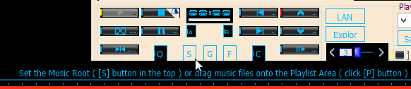

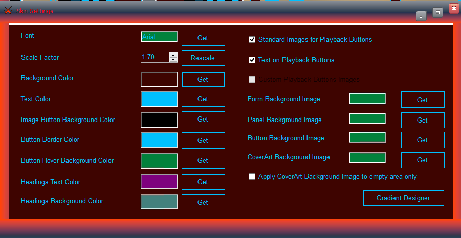

« Reply #5 on: June 08, 2015, 10:31:11 am »
Since answers stay out for now and to shortcut things somewhat - here's how to get things back to normal in this situation :
Use the [ S ] button at the mouse arrow above and set the colors and scaling sort of how you see below.
Also set the little slider in the left hand border to other than the bottom position.
Also check out your Q1 and Device Buffer Size which most probably will be 0 and 1024 respectively, while the default should be 14 and 4096.
All other Settings must be observed too, because they all can be a kind of rubbish.

« Reply #7 on: June 08, 2015, 01:31:48 pm »
This did help.  Happy
