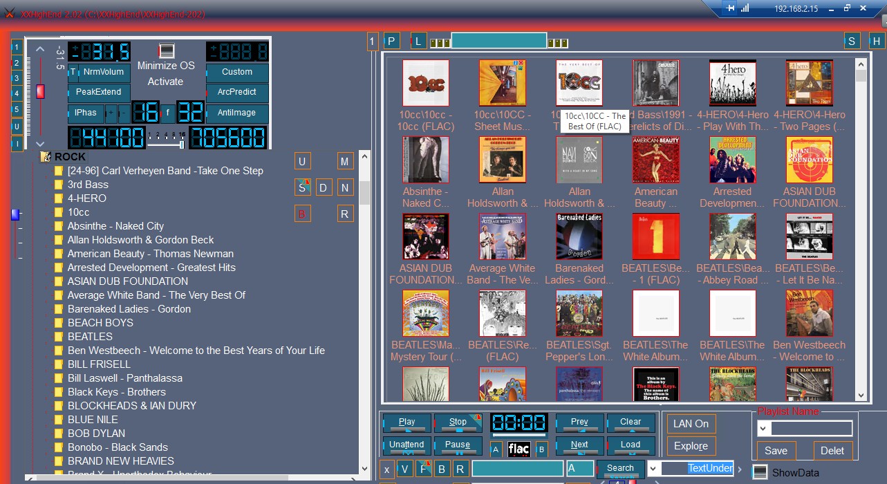

For me the best way to use Galleries is to set the cursor (say) on "Rock" (see attached) and then add what I want from the play list area into Galleries. It works well because the full path spec is used so "stuff" gets organised properly in Galleries (hope that makes sense)
So far so good.
But it does not work out that way because yesterday I went through the whole "Rock" directory (as displayed in the playlist area) creating a directory in Galleries call "American Rock". Great I thought it had worked but it had not.
Creating the Gallery items for what I wanted is not a problem it all works fine but there is a problem. I had thought that if I put the cursor on "Rock" that everything (album art) that is displayed in the playlist area would be everything that is in the "Rock" directory including everything that is in the sub directories. However it is not. Look at the attached and you will see that everything that is in the "4 Hero" sub directory is shown in the playlist area but none of the contents of the "Beach Boys" directory is shown - not one album - but all the Beatles albums are shown. And that is the way it goes all the way down the directory - everything that is in the root (I think) is shown but randomly (seemingly) the contents of some sub directories are shown and others are not. I cannot see anything in the directory structure that could be a problem it is after all really simple.
So "Galleries" would work for me if everything was shown as I would expect it to be but as it is it would be so time consuming to set up the Galleries directories that it would not be worth the effort.

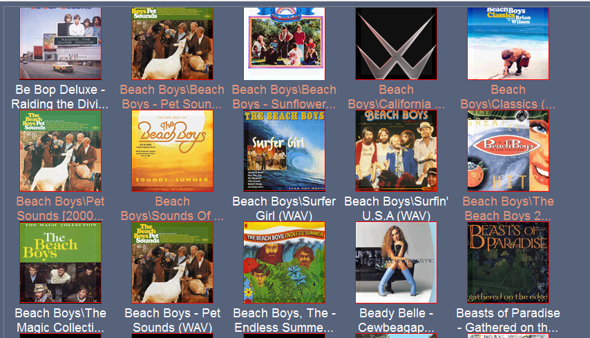

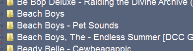

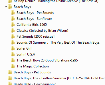

Below 1. Embedded Explorer after pointing to the Rock Gallery, 2. the Galley Folder Structure of it, 3. the Gallery Area for the part concerned (I counted, they are all there).

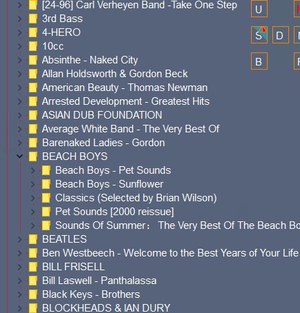

Peter I hope this is what you are looking for.
The way I put albums in the Gallery is this:
First in the Gallery directory I create a sub directory called say "American Music". I then click on "Rock" in the left XX pane so that all the album art of all the albums from "Rock" and all its sub directories is shown (or should be) in the right (Galleries) pane. Now lets say I want to transfer all the 4-Hero albums into the "American Music" gallery directory I highlight all the 4-Hero albums (in the right pane) then right click and go through the sections that creates short cuts as required in the "American Rock" Gallery. It works fine not only creating short cuts to the 4-Hero albums but also creating a "4-Hero" subdirectory in the Gallery directory.
Why would I want to 4-Hero in the American Music directory? - well of course I wouldn't because they are English ha ha

Now we still don't know what is the matter, unless you used the Gallery itself to obtain those Beach Boys, which obviously aren't (all) in there at first. So this shot will be seriously too long. Happy

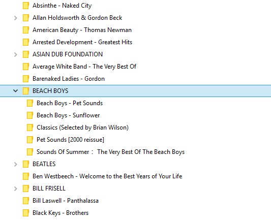

« Reply #8 on: June 30, 2015, 08:39:12 am »
I guarantee you : you "do" something wrong. And if not that, something is wrong with your folder structure which prevents it.
OK you just spurred me on to find out what the problem was. Check out the attached and the Beach Boys are now shown correctly.  To cut a long story short I ended up re-setting and setting share settings on the "Music" directory. There should not have been any problem with the original settings but having done that the Beach Boys thumbnails have appeared.  I will take a closer look tonight to make sure the whole directory is correctly shared and that all thumbnails are shown but anyway there it is something to with Sharing but not sure what exactly because it was apparently shared correctly before.
So there it is - definitely done now!!!
