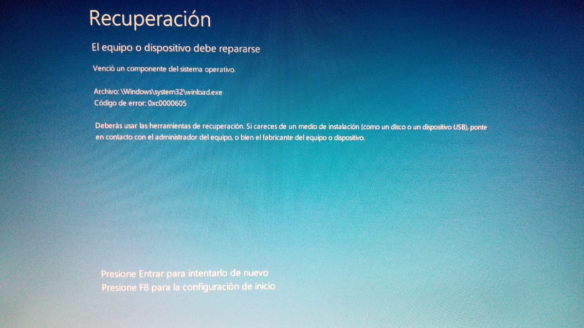

« Reply #82 on: September 30, 2015, 10:05:26 am »
Hi all,
This morning appeared for the first time the message in the picture when I turned on the Audio Pc. It seems that the real problem starts from now on, at least for me. I hope I´m wrong as I don´t have time rigth now to look for some solution but I restarted the pc several times and the message appeared again. Never before it appeared when turned the Audio Pc on.
Traslation (aprox):
Recovery
Expired one component of the operating system.
File: Windows/system32/winload.exe
Error Code: 0xc0000605
You must use the recovery tools. If you have not an installation media (such as a cd or a USB device), contact the computer administrator or the manufacturer of the computer or device.
Press enter to try again
Press F8 to the startup configuration
« Reply #83 on: September 30, 2015, 10:26:02 am »
Hi Juan,
And what is the date in your PC ?
« Reply #84 on: September 30, 2015, 10:38:38 am »
Hi Juan,
Peter,  I can't see it with that window but yesterday it was September 2012
« Reply #85 on: September 30, 2015, 11:16:25 am »
Hmm ...
Maybe you can observe the date in the BIOS ?
So actually you can't do anything now any more ?
« Reply #86 on: September 30, 2015, 11:29:49 am »
Hi Peter, I wasn't at home and couldn't see the bios. The date there was 2019 and why has been changed there I don't know. Now changing it again to 2012 the problem is solved. Sorry for the alarm, now I cross the fingers for tomorrow as it seems to be the end date.
