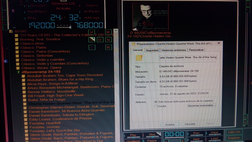

Hi Robert,
I´ve been testing the size of the ramdisks playing 24/96 and 24/192 files. With a 2Gb (A) ramdisk (xxdata and xxhighend 2.02) and a 6Gb (B) ramdisk (playback) playing a 4.53Gb album (wav 24/192) there was no problem at all. So it seems that there is no need the (A) ramdisk has enough space for the album, while the (B) ramdisk has enough space for it.
If the different sizes for the ramdisks make a difference to SQ, I have not noticed.

Peter, the idea was to test whether the storage capacity in the ramdisks is determined by the smaller one, as you said.
« Reply #9 on: October 15, 2015, 08:27:13 am »
Juan, it is.
And if you refuse to believe *and* test it for the general purpose, then I would be happy if no misinformation is spread.
Thank you !

Thanks Peter, I'm sure you're right, so I will not continue with this topic.
