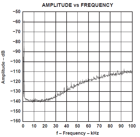

The iFi uses the DSD1793 which is rated to work at 192KHz. But look at the THD figures; possibly you are not into such numbers, but I am and do all with them - for a base. So for 192KHz the THD already is 0.003% undoubtedly (read : 100% sure) including a heavily ringing filter (otherwise the 44.1 plot would show 0.04% while it now shows 0.001%).
If we'd be allowed to extrapolate this to 768KHz we'd arrive at something like 0.04% again (just expand the lines upwards in linear fashion) which implies headaches. Plus :
we are not allowed to extrapolate because things will collapse (closely look at the distance between 96 and 192 which already is larger than the distance between 44.1 and 96).
So 786KHz ? nice story. Also nice that someone tells that it sounds nice, but I'll only believe that when I heard it myself (which I did not).
Those numbers are too important to me.
I can cough up the numbers of the NOS1(a) but I assume they are known, because in this forum at several places.  But for 24/768 it is 0.00074% THD+N which sadly is also my analyser limit. Watch out, because this is measured at the end of the interlink with a fully operative DAC. Compare with the plot below which is from a CHIP.
For me, a noise line is even more important; Look at the 2nd picture below. That is quite hurting (looks like partial DSD sh*t WHILE this is PCM mode (see datasheet in the Note under that plot - http://www.ti.com/lit/ds/symlink/dsd1793.pdf)).
I don't think I have put up plots at -60dB but you'll hopefully take my word for it if I tell you that the noise then is close to -160dB and super straight up to 96KHz.
With all this I'd have to tell you that "my" figures are with a zero ringing filter.
