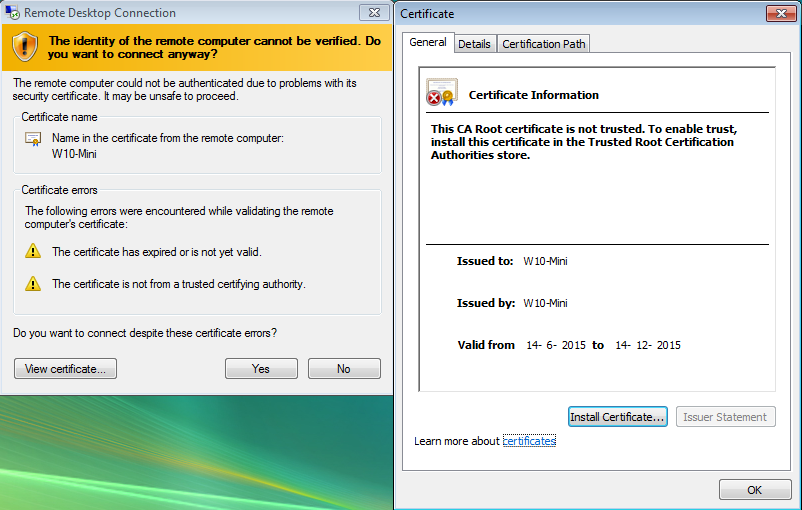

Am I the only one who receives the below (left) screen when I try to RDC connect to W10-10074 ?
I have this since two days, and the right screen shows the why (certificate expired on Dec. 14).
The start date of the certificate apparently was June 14, or IOW exactly 6 months earlier. Don't ask me whether this June 14 was the date I installed 10074, but it is possible.
In the right screen I clicked "Install Certificate", pressed OK a few times on all the questions (left all default) which sequence ends with "Certificate succesfully imported".
Nice, but it doesn't help.
The Dec. 14 is also "about exactly" 2 months after 10074 officially expired. That is, on the 15th, and this certificate works up to the 14 (and not any more on the 15th).
Related ?
When I click Yes in the left screen I can just connect as usual. It is only that this question is always there after having disconnected the RDC session - and want to reconnect.
Does anyone see the same ?

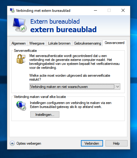

I have gotten them too and looked at the configuration and by selecting an option (somehow it was reset to standard) it connects without issues anymore... see image.

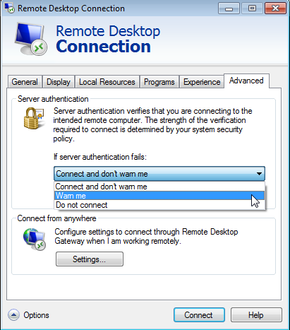

Below the same screen in English. Mine was set to "Warn me". Now, with "Connect and don't warn me" all goes without message again.
Thanks !
