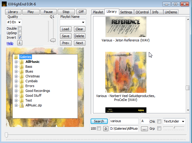

  • When the Library Area is active, the left pane now shows an embedded Explorer (see picture below);
    Important : Since this Explorer is the very same as the normal Explorer, a.o. it Deletes as usual !
    Currently only basic features can be applied with it, but in future versions many more will emerge from it. Also see below topics.

  • The Music Galery Root has been removed from the Settings Area;
    The Music Root from the Settings Area now determines the root of the embedded Explorer. In the picture below this was D:\Galeries.
    Note that the picture shows "AllMusic" in bold coming from the fact that that folder was clicked; Look at the bottom text field, where you also can see the "\AllMusic" behind the D:\Galeries. It's the same as any folder clicked in the Embedded Explorer. Now note :
    Looking at the structure as shown it is not the intention that you click "deeper". In other words, when you open a folder by means of clicking at the plus sign, underlaying folders appear, and you could click those just as well. When you do, the result list in the Library Area would be narrowed to that. Very convenient ? maybe ... As long as you know that therewith the main result list is reset to that, and when you'd want to go up again and click AllMusic in order to get all again, you'd have to wait for all (again).
    But there's another convenient feature going along with this :  When underneath your AllMusic is referred to "type roots" like "Jazz" or "Rock" which just emerged from the physical data structure (and with which not explicitly added Galery folders are meant), yes, *then* it's a very good idea to find that "type root" and open it. It would narrow your results to that type of music.
    There's more to explain, but with this as the basics, try to get the grasp of it. BUT, if you think things could work more conveniently or more intuively, please let know !

  • Although pressing the Search Button actually is needed only to set a result list fort the first time, from then on going along with Active Search (typing in the textfield is enough), - but also see ebove - it hands you the conveniency of seeing where you are in the data structure, because the Embedded Explorer will show you where you are then.
  • A small issue in between : When the data from the Music Root field in the Settings Area is not consistent with the data in the bottom text field from the Library Area, i.e. the beginning of the Library Root is not contained in that bottom field, you'll see that Album data is cut at the left in the result list. Note you can incur for this already by just typing in mentioned bottom field.
