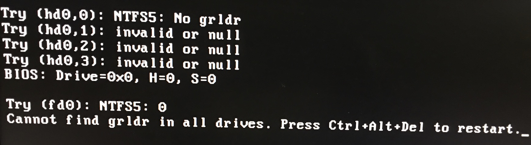

So here is the deal.
Did an firmware upgrade to my X99M Asrocks MB.
After that, i cannot boot anymore into the Ramdrive.
All other boot options work, except for the RAM option.
I attached a screen shot of the error.
Not really sure what is going on here.
Regards, Michael

Hi Michael,
"GrLdr" seems to relate to Linux "Grub Loader". It seems to have disappeared for an unknown reason.
Now what to do... Peter should help as soon as he will read this...

The whole thing hangs right after the first boot menu.
So as soon as the first selection is done (Win8/Win10 RAM).
I do not even see the second boot menu after the first one.
so it hangs right after the first one.
