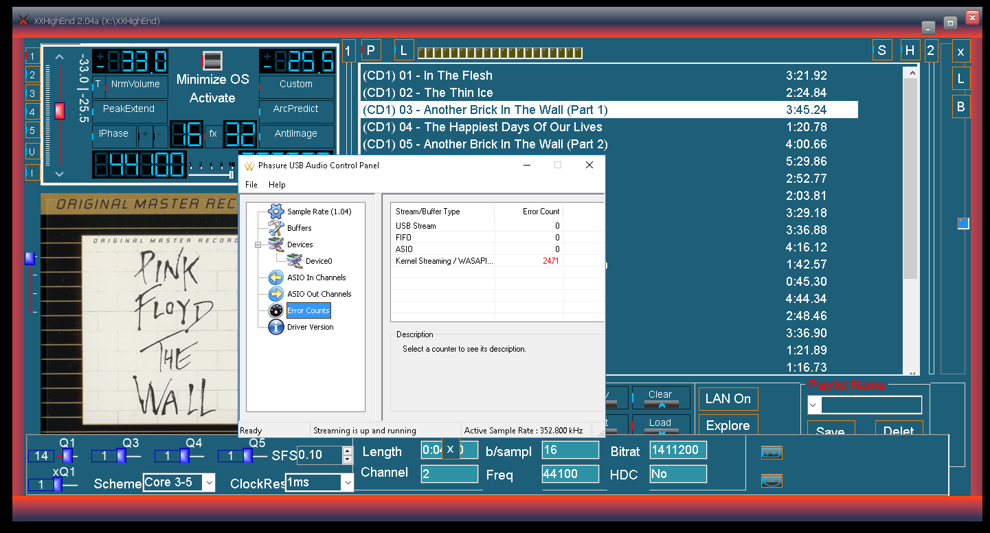

It is not skipping a track but skipping a buffer (?) with an audible "tick" as well...
See image...

Bert,
I recognize that. Just to see whether it matters, can you try with a higher SFS and a different Buffer setting in the NOS1 Driver Control Panel ? (it is allowed to change both at the same time).
First learn what that errorr number is between two specific tracks, then make the changes and see whether that number is (very) different. Ok ?
PS: And if it does not matter, for fun try without Intona.
« Reply #9 on: February 24, 2016, 01:07:19 pm »
Changing FSF helps... at this moment SFS 0.4 (instead of 0.1) does not give hick ups anymore (didn't try values in between but 0.3 is too low).
Will try to see if changing the buffer helps as well or makes it worse again.

Changing USB buffer or ASIO buffer does not change anything...
In the meantime I had to set the SFS value higher to 0.5 because larger tracks still gave errors at 0.4

Silence (audible gap) and a tick where the music should have been gapless without tick.
With SFS set to 0.5 no errors appear (visible nor audible) and not even a tick anymore...
Buffers set to 2ms (USB) and 12ms (ASIO) or 16ms vs 32ms does not change anything. USB buffer set to 1ms does not work... only noise and errors flying around.
Is this PC speed related or is the 80Mb/s NAS not quick enough? The longer the track the sooner the error... seems to be related to too little time to complete a task.
I will try a CD directly from the internal SSD to see if that matters...
Nope, exactly the same... minimal SFS 0.5 to prevent "skipping" or "gapping".

Bert,
The ASIO setting in the Driver is completely irrelevant (doesn't do a thing anywhere as it is for ASIO only and we don't use that).
Is it PC speed etc. related ? It should be, regarding your further descriptions.
But why is it suddenly bothering you ? I mean, I never heard you about this. Did perhaps something else change ?
Maybe there's something in that ...
Are you using a RAMDisk for playback ? you should as it is crucial for the "network performance" !
