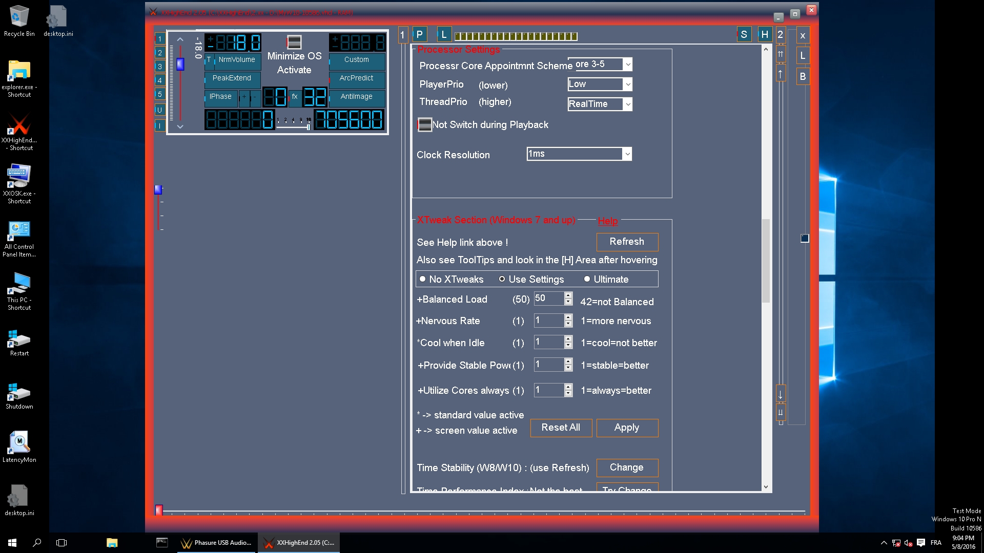

« Reply #7 on: May 09, 2016, 03:01:21 am »
Here are some of my settings. The small window shows the Phasure Audio USB control panel...

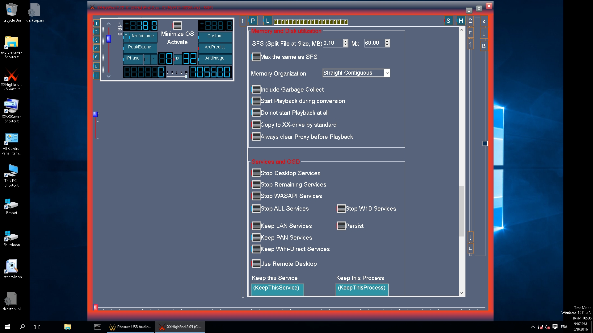

« Reply #8 on: May 09, 2016, 03:05:47 am »
Another part of the settings...

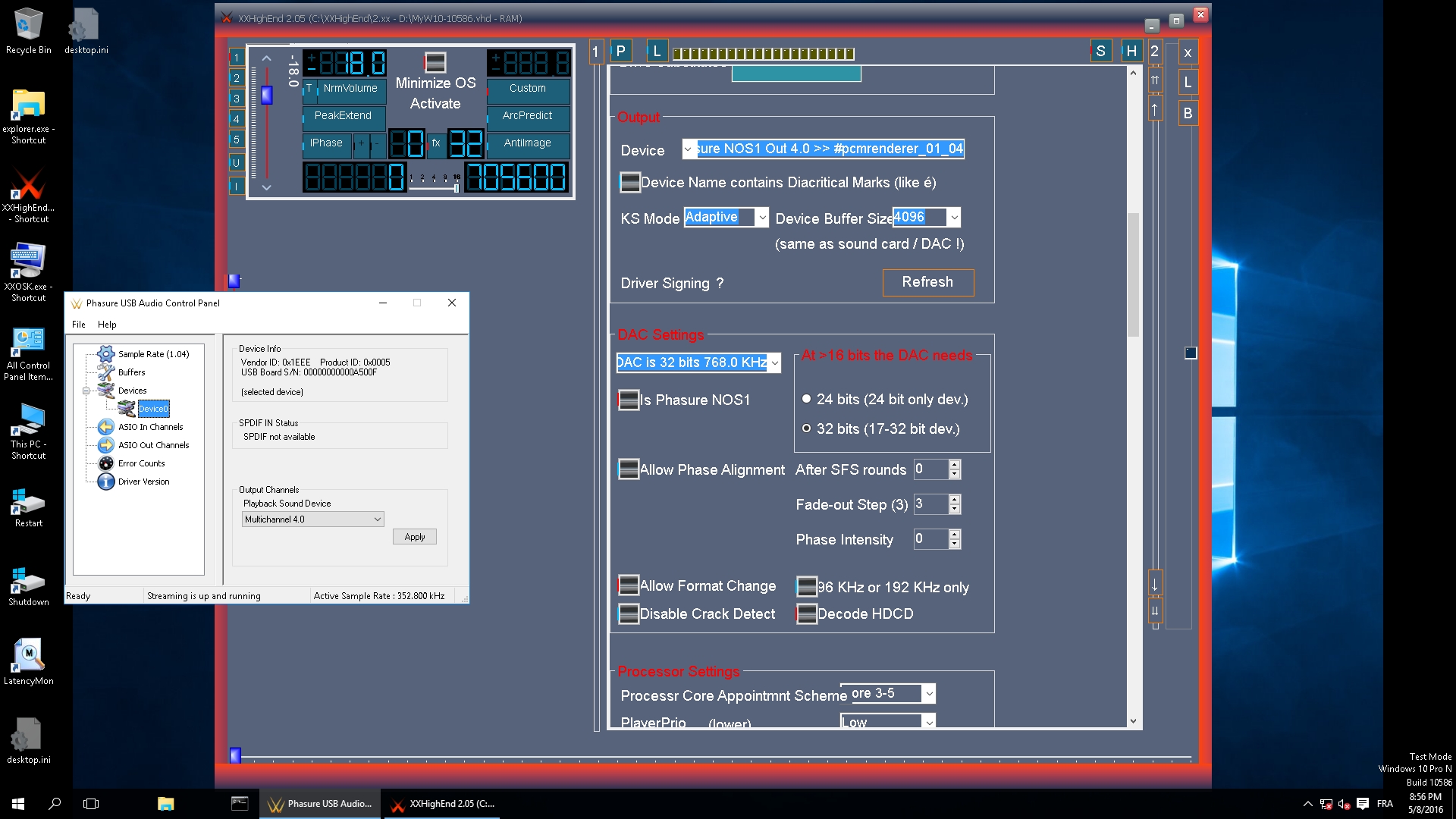

« Reply #9 on: May 09, 2016, 03:08:00 am »
Another...

« Reply #10 on: May 09, 2016, 05:23:44 am »
Thank you so much.  What happened was my Output Device got changed.  I could not figure out how - it was not on purpose - then I noticed that when you use the scroll wheel to scroll up & down in the settings, ** if you pass over a dropdown it scrolls that ** instead of the window contents.
And thus does turning on tooltips break your playback.  Lesson learned.
